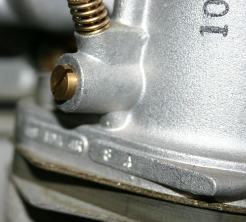

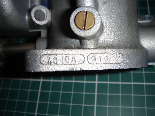

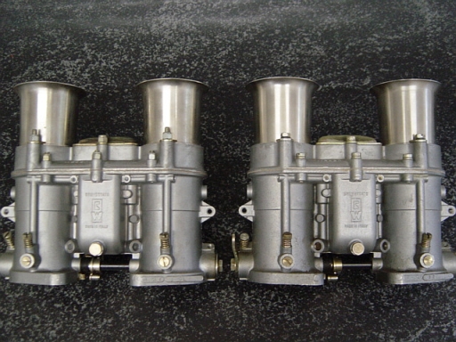

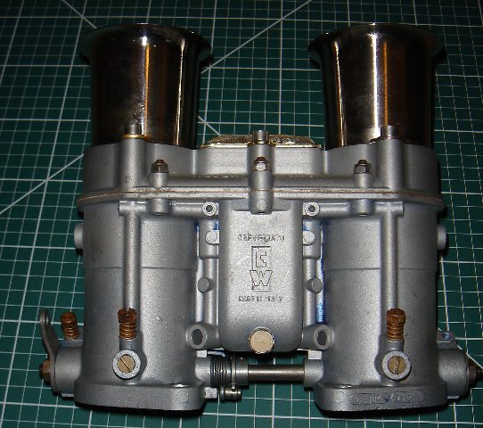

The pictures below show two shots of my 48 IDA's followed by the new weber IDA and finally the ebay sale.
The new IDA has a casting lug on each side of the main casting and a slight web on the foot of the casting (Shown circled in black) which is the same as the 'original' for sale on ebay which also has the web where the carb ID is stamped.
There are a few possible explinations....
1) Some guy bought the parts new and is trying to sell them as NOS.
2) There are a few different casting versions of the IDA's out there
and ....... I shudder to think.....
3) My IDA's are not original and the others are!!!
Jimmy help!!!!!!!!!!
HILLY
Mmmm….It has gone from being over priced to sounding a bit suspect.
Doc, your castings read ‘made in Italy’, do the re-released items have this same casting detail and where are the re-released items actually made??

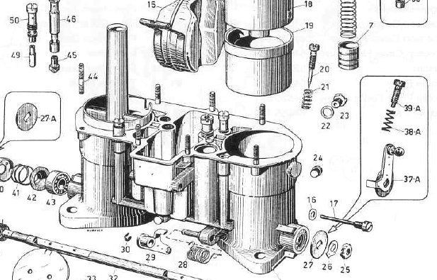

They say in the article that they are reconditioning original 48 IDA carbs which have the side lugs on the main body and also the extra web where the ident is stamped..... I guess there must be different versions of the main body casting out there.
Jimmy... your picture of 48 IDA's (shown in first pic below) show the side lugs and the stamping web, so what do I have??????
and just to add to the confusion... all references to a 48IDA exploded view (shown below) show the main body casting without the lugs and the web at the foot of the main casting.

JimmyMac
Doc,
It's also a mystery to me why your IDAs have no lugs.
I have five NOS Bologna carbs here with lugs and the web, and also all the markings as you described for Italian Webers.

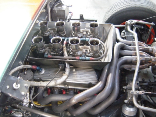

Just to throw fuel on the fire check out the picuture of P1008 showing lugs on it's Webers.

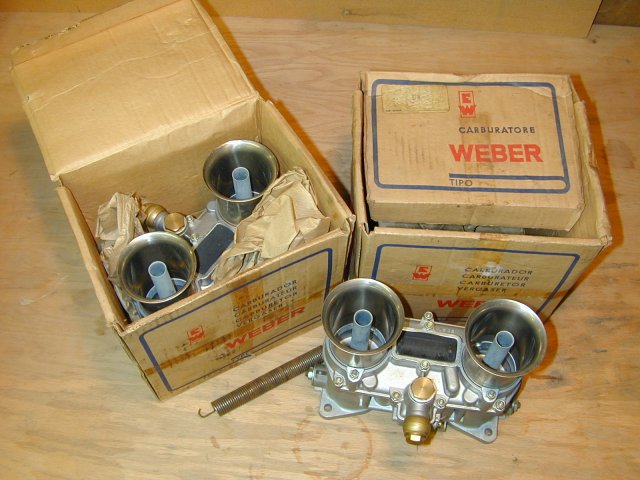

I found these pics of.. "68 or so vintage EMPI 48IDA kit. Check out the instructions. Included is the linkage, 48 ida carbs and intakes. Very rare kit indeed!"
(about midway down the page...)
Engine components

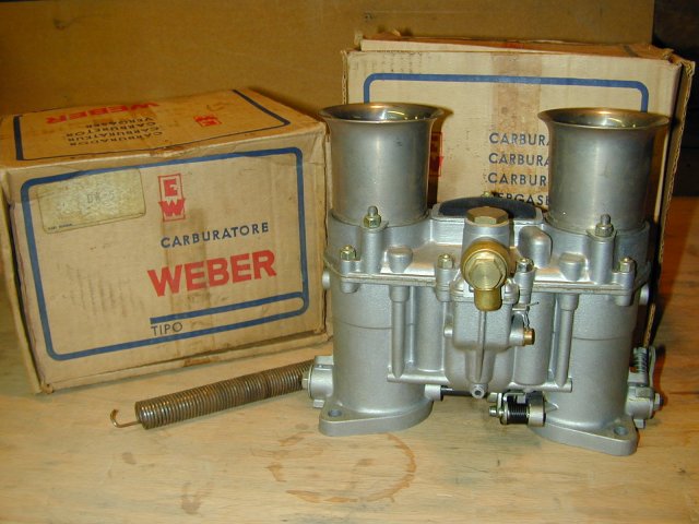

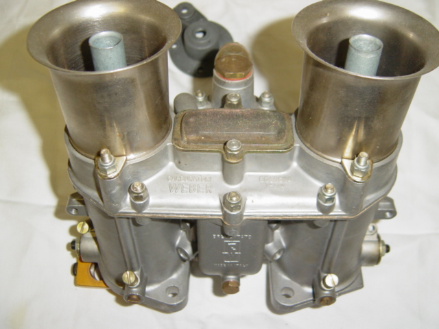

68 IDA's and no lugs... I must have early IDA's huragh!
So the question now is...
Were there 2 main body castings for IDA's from start of production (early 1960's in Italy) or did the lugs and stamp web start later? maybe when production moved to Spain?
Did the, now to be named as lugless IDA's (the ones I have and also the ones shown in photos below) stop being produced at some point?
....always the same... answer 1 question and 3 more questions need to be answered....

JimmyMac
Doc,
Did not Empi sell custom Weber IDA set ups for VWs etc ?
That big spring looks like part of a throttle for an in-line double twin arrangement.
I am no expert, I have seen early IDAs with a printed aluminium maker's plate on the front, but also believe your pieces are obviously earlier than the ones with the lugs (as in the JW diagram) because I think these "lugs" are a modification to the original casting for an adjustable throttle stop stud.
As to timing of the throttle stops ? I don't believe it has anything to do with the Spanish production more a development by Weber Bologna to suit different engine set ups.
Question - Are P1008's Webers original 60's period from the Slough factory because the rest of that engine is ?

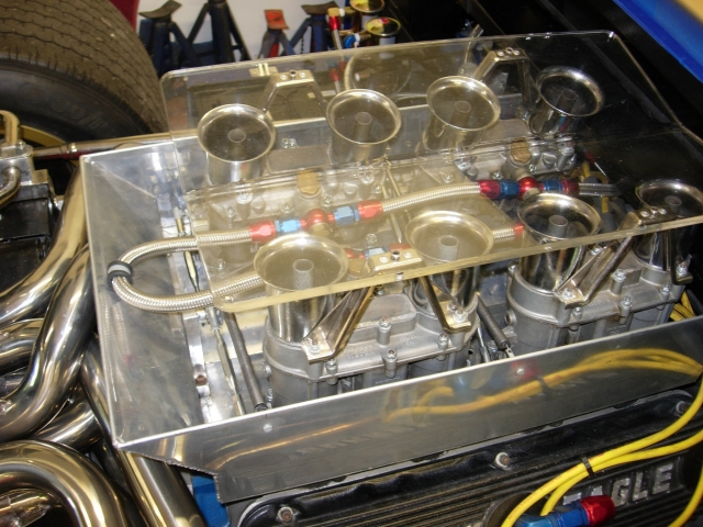

Just to confuse you even further.
Here is a photo of both types of Webers atop of an original Gurney Eagle engine.
So I'm not too fussed as to which is which.
