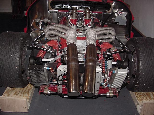

Not the best pic but it is the way I plan on doing mine. This is Rick Merz setup before he sold it. Somer of the G50s have them on the side. They have to have a little restriction to create the spray as 1-2 Gpm out four or five hoses probably wouldn't reach the gears very well. 1-2 Gpm is about how fast your focet flows. Basicly mine will be gravity feed from the cooler to the top of the trans over the gears. The ring and pinion will be slightly to the back of the curve of the ring gear due to crossover bar.
