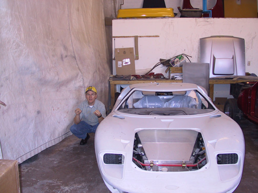

Those are all great points. I did sit in a rolling chassis Roaring Forties at Gordon Levy's facility about 9 months ago. There is nothing to me that looks as exciting as a GT40 especially the Mark II version. A Viper,Corvette, or NSX just does not do it for me. I saw the White with Blue strip GT at the Houston Auto Show just stood there with my mouth hanging open and took lots of pictures. I kept trying to get the Female Model to get out of the way. HaHa.
My guess is hopefully I can take a Superformance version and see if I can make some changes as I will never be able to afford a Ford GT. Of all the suggestions, the air conditioner is the one I would not sacrifice as it too hot in Texas. Below is me dreaming wearing the GT40 hat I got at Ford Dearborn headquarters.
