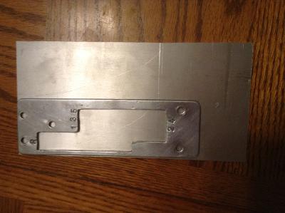

Advice on making a gearstick gate
Unfortunately I have never had anyone to teach me how to do some simple things properly, file a straight line etc. So now I need advice on what tools to use and correct procedure on how to make a good job of cutting out the middle.
Nick
Ed McClements
Cover the area you're going to mark with a fat tipped Sharpie or marker pen. Transcribe the pattern you wish to replicate with a scriber or craft knife. Drill holes at the inside corners to show where you're going to cut to. Using a large drill, remove some of the bulk from the middle then, using a sharp, good quality file, file up your Sharpie line. Finish with Emery paper then Scotchbrite.

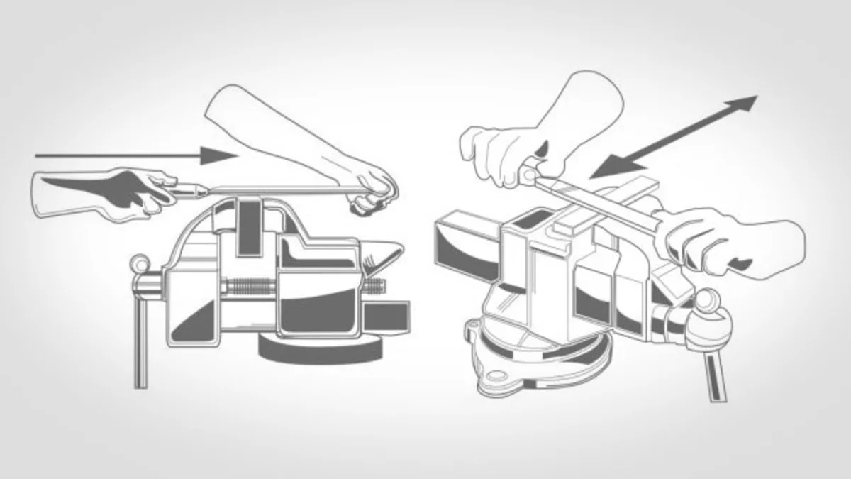

Finish all edges by draw filing and 320, 600, 1000 emery and polish or paint to suit.

draw filing is the right picture, 'normal' filing on the left.
