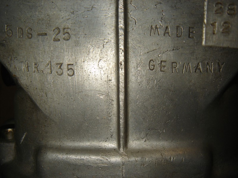

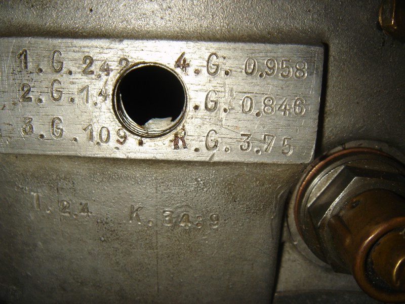

Big shout to Frank Catt, Paul Fleming and Bob from Can Am Cars Ltd.
Christmas has come early this year.....

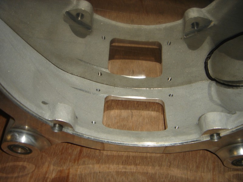

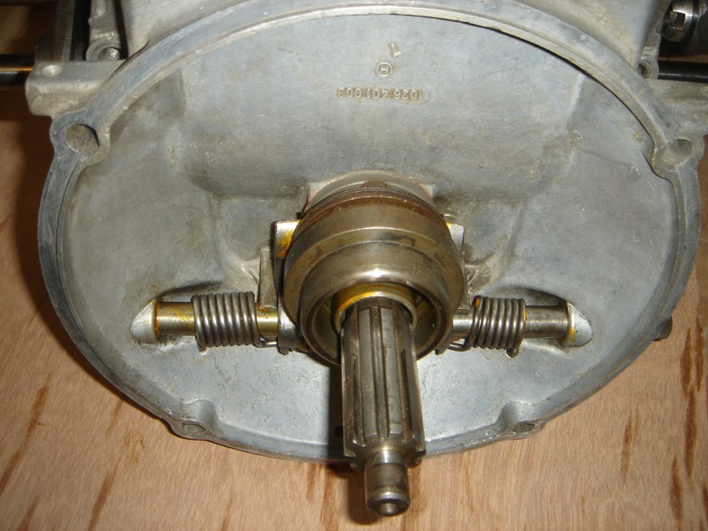

Doc Watson

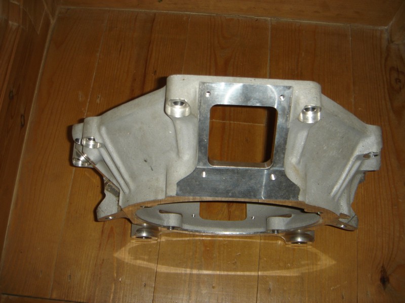

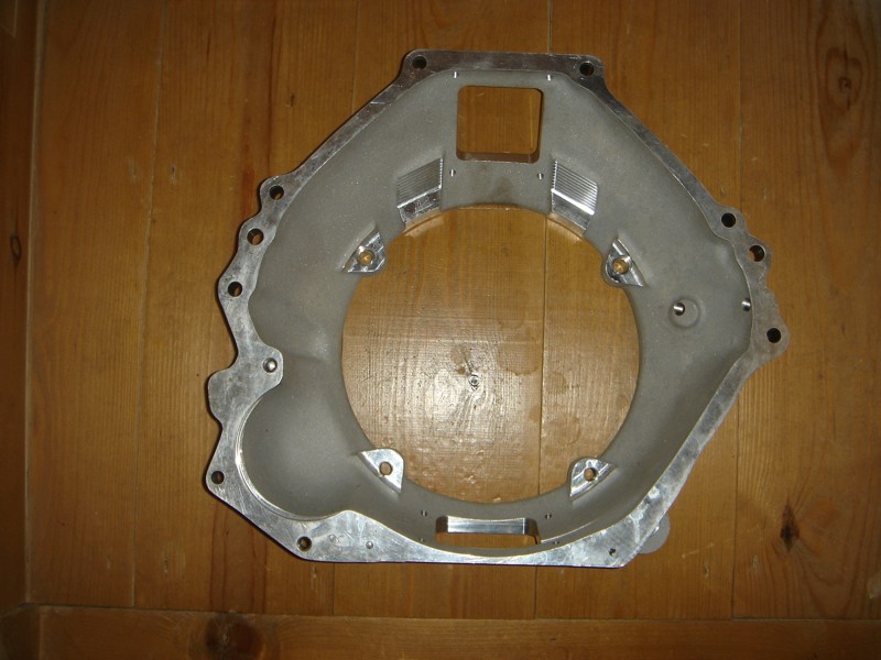

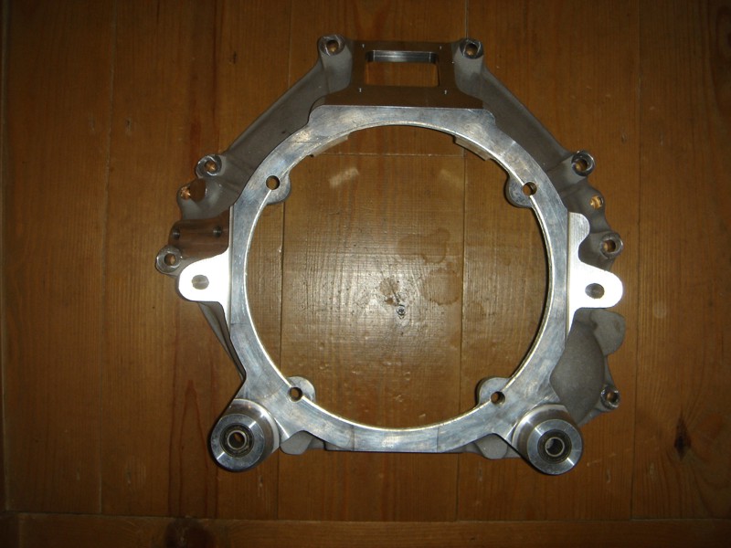

Christmas arrived early....again!!!.... thanks Paul.

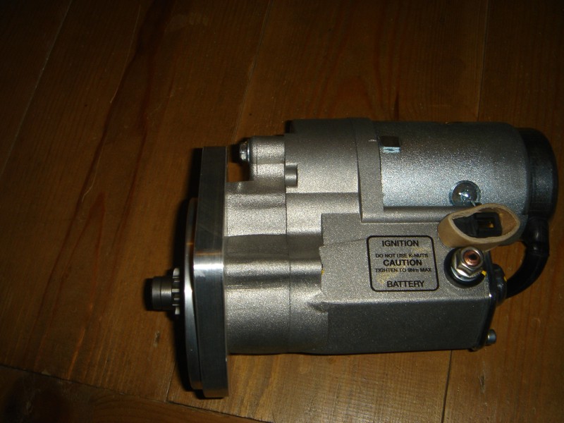

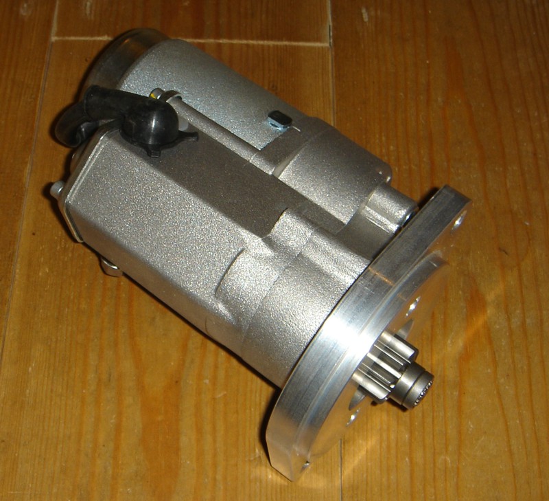

Gear reduction starters may not be period correct, but they are a heck of a lot more efficient and trust-worthy...
Nice bunch of parts!
Doc Watson
Thanks guys, yes the starter isn't period correct but I want the thing to start every time and comp ratio of 10:1 will need it. Next job is to finally remove the machined block from under my dining table and into the shed for dry fitting.

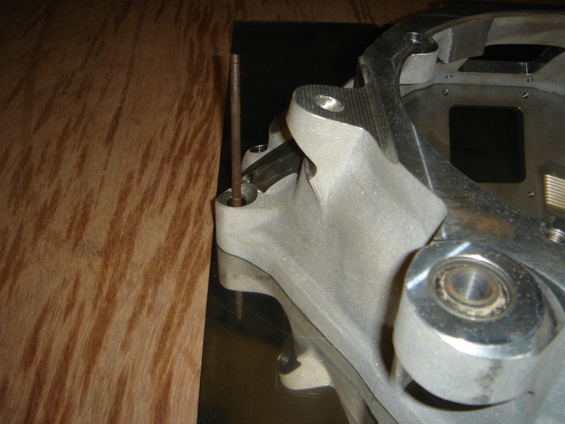

Doc Watson

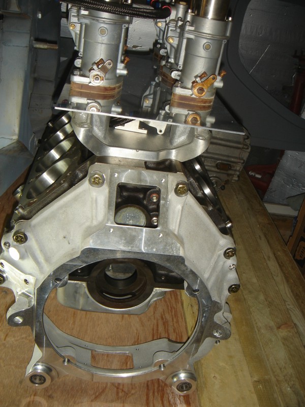

As usual with my timeline Keith you had to wait a few weeks...but...

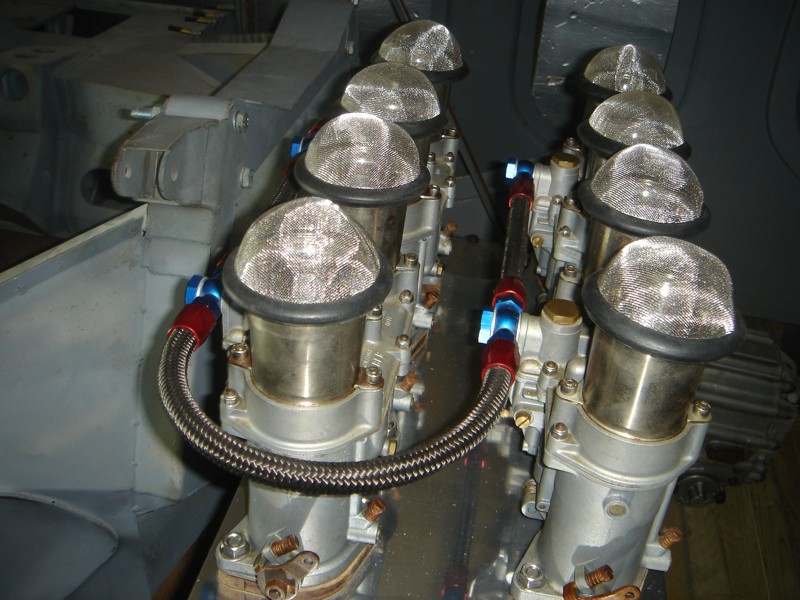

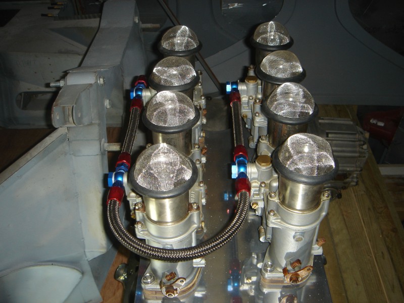

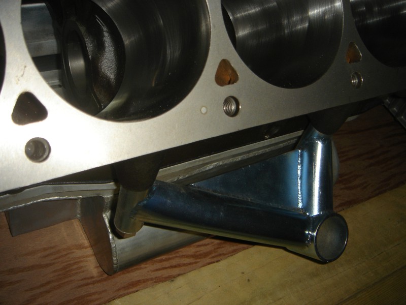

Ida's, bellhousing, oil pan, inlet manifold and engine mounts attached ready for a dry fit.

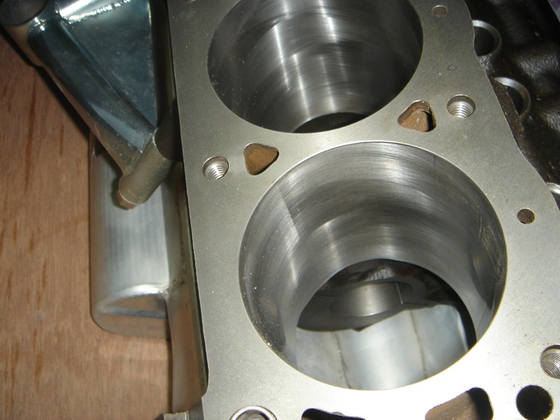

Doc Watson
and a close look of the bores...quick clean and they look good, 0.020" over. Need to check the deck height and then decide what the guts of the engine is going to be.

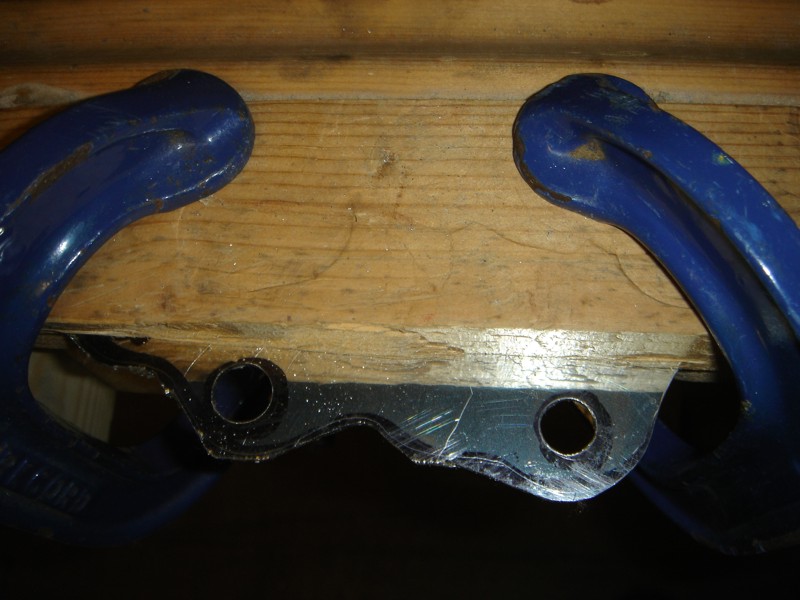

Doc Watson

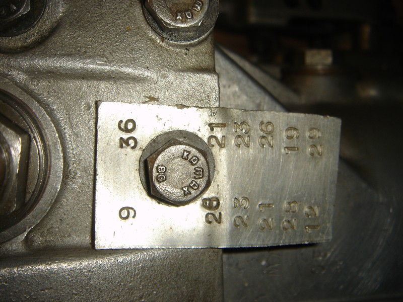

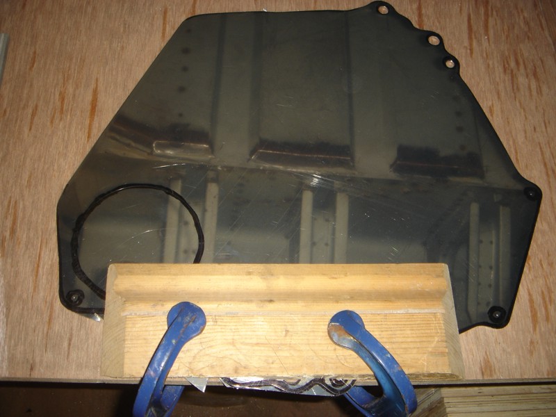

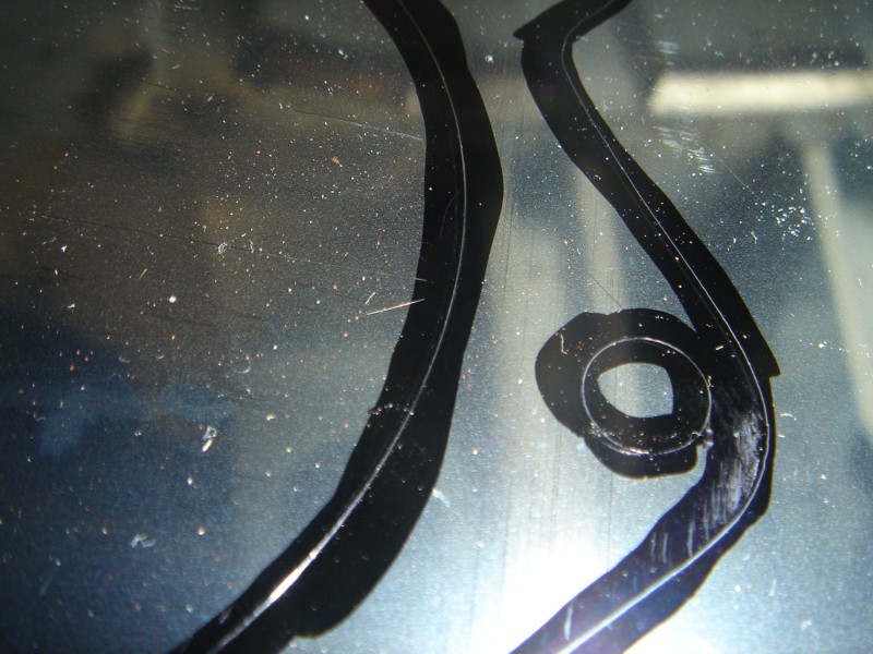

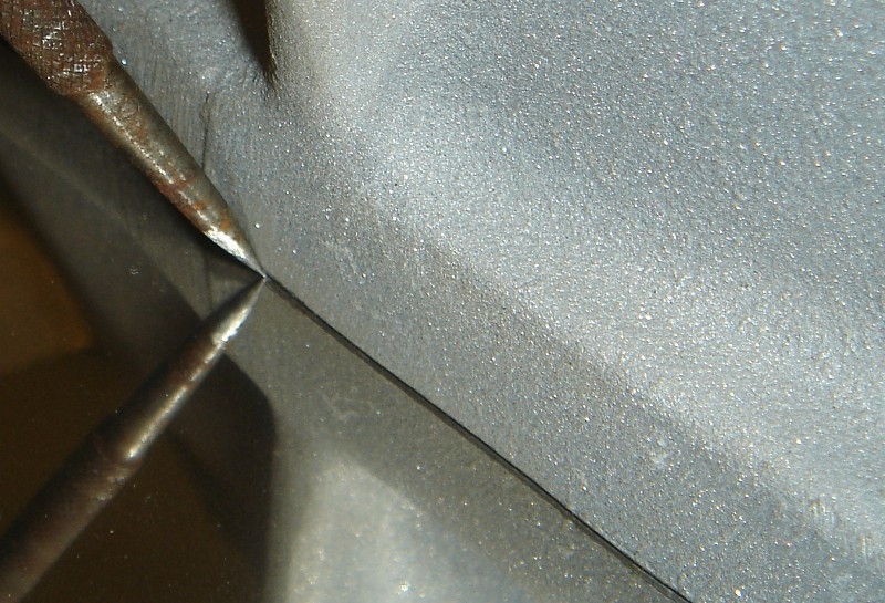

A quick trip down memory lane with a 32 year old scribe...... permanent marker...hacksaw...files...and not even half way there....
16 SWG SS flywheel cover plate. A few more hours yet...

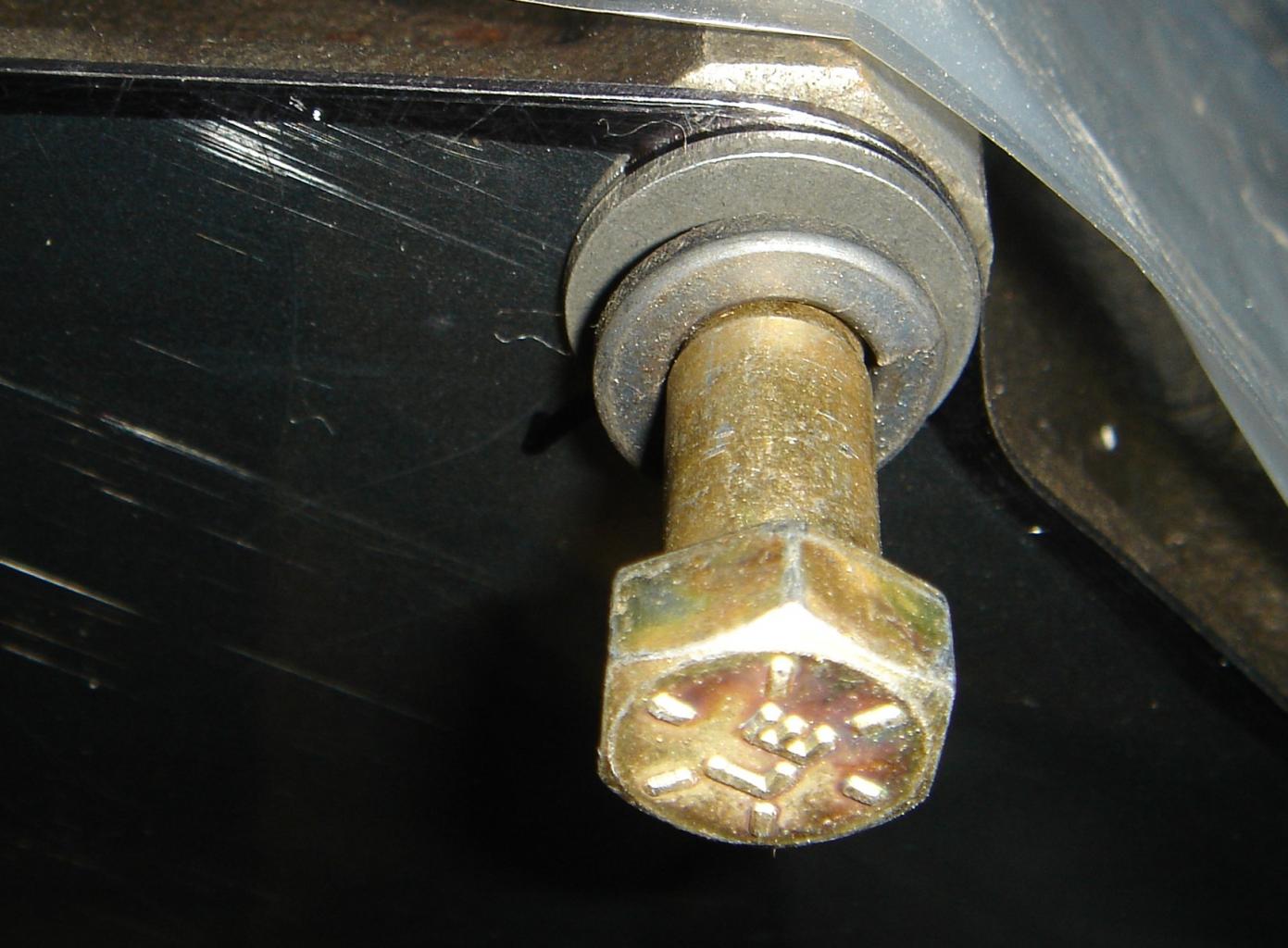

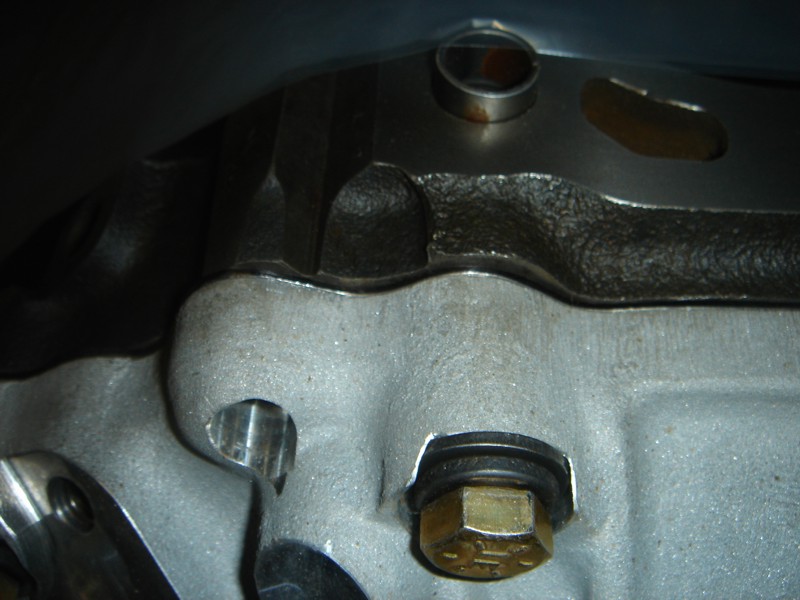

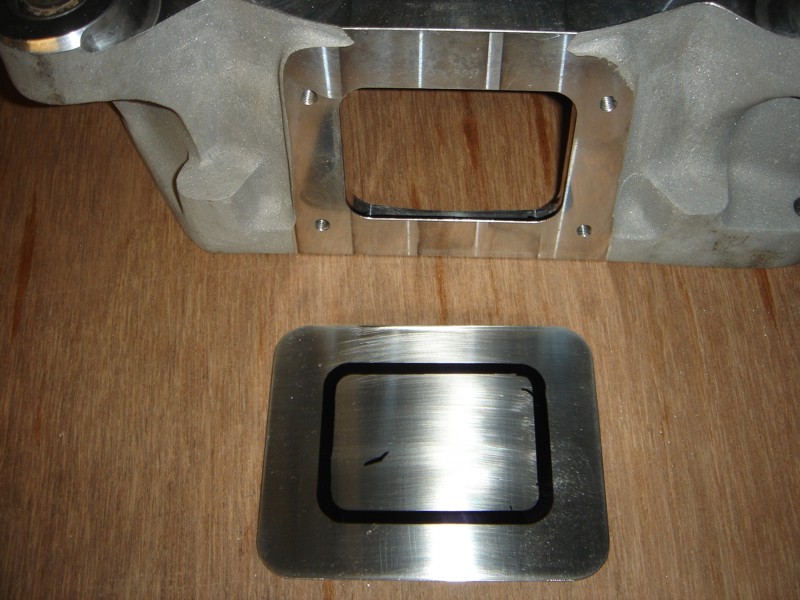

More filing...... and drilling the bolt holes.... all done now.... well starter motor hole to remove and another large hole for the crank. Spare metal left for the two bellhousing covers. My arms ache....

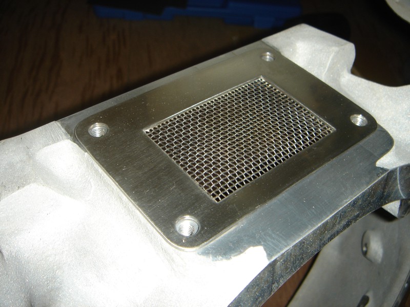

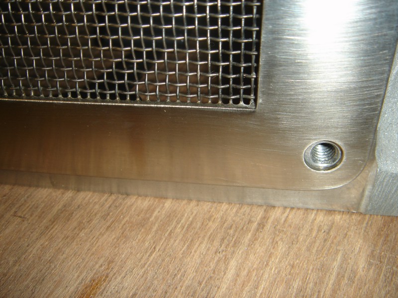

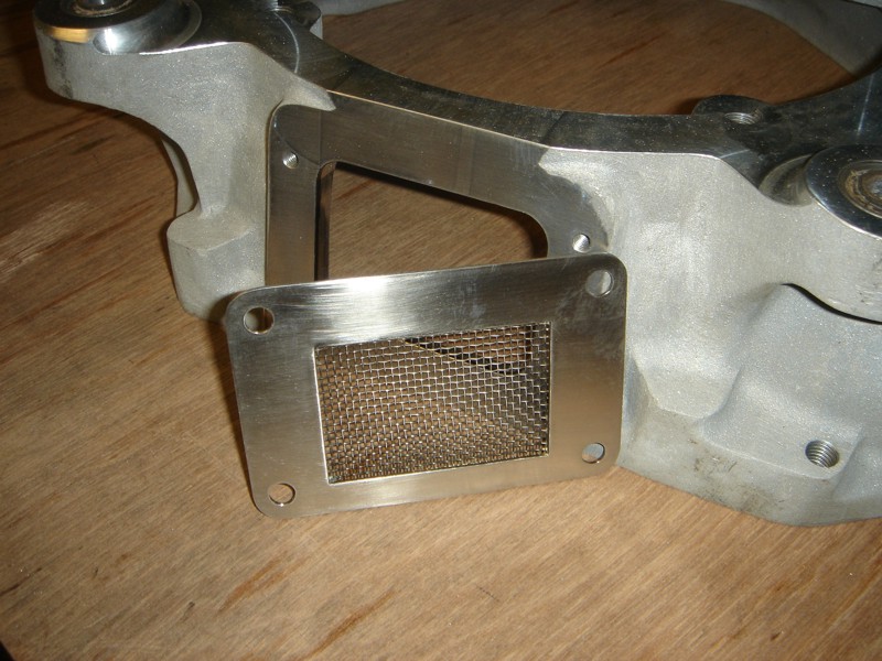

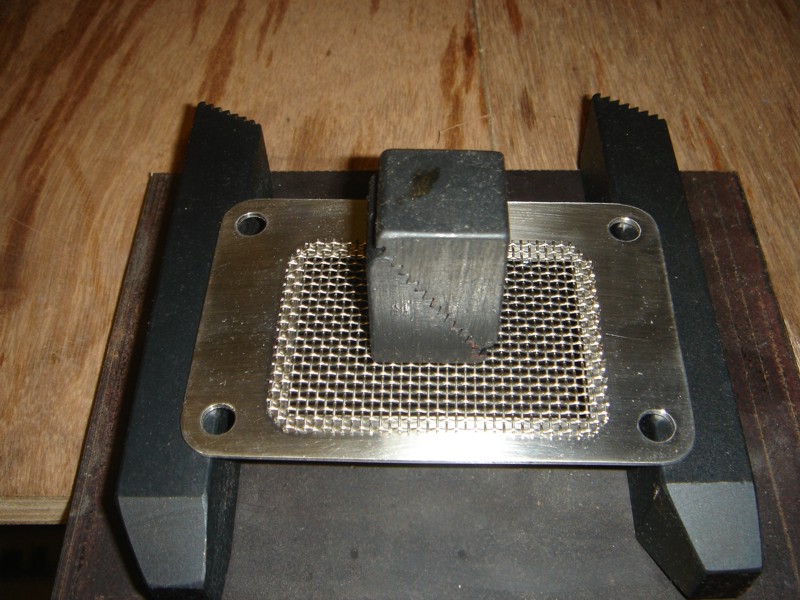

...and....more filing, drilling, brazing.... stainless steel lower clutch cover plate. Top one next.

Very neat Andy. Not having seen the like before, is the mesh to stop sh*t getting in or sh*t getting out?
I think I know the answer, but there again, I thought I knew all the answers to the 11+.
