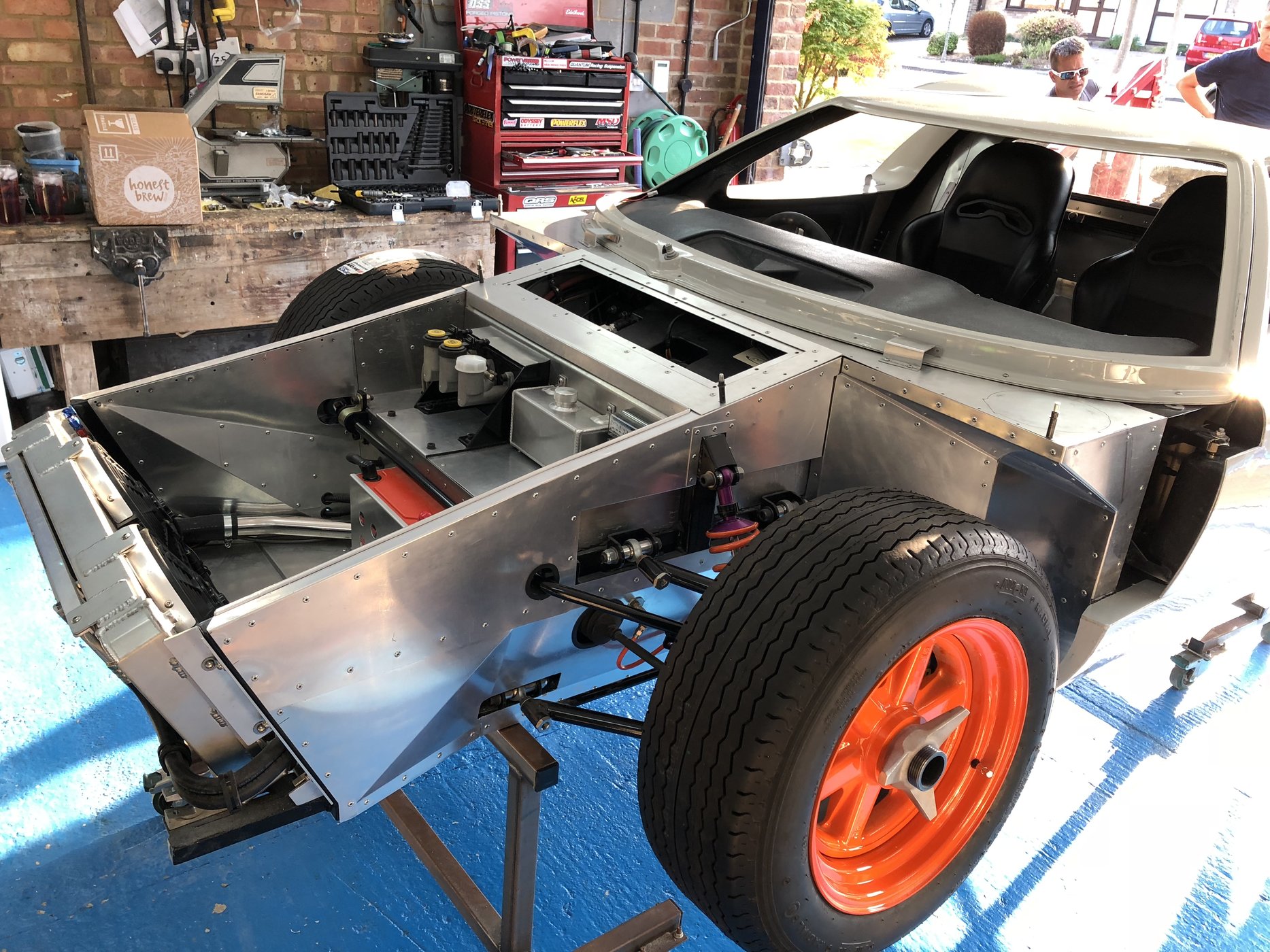

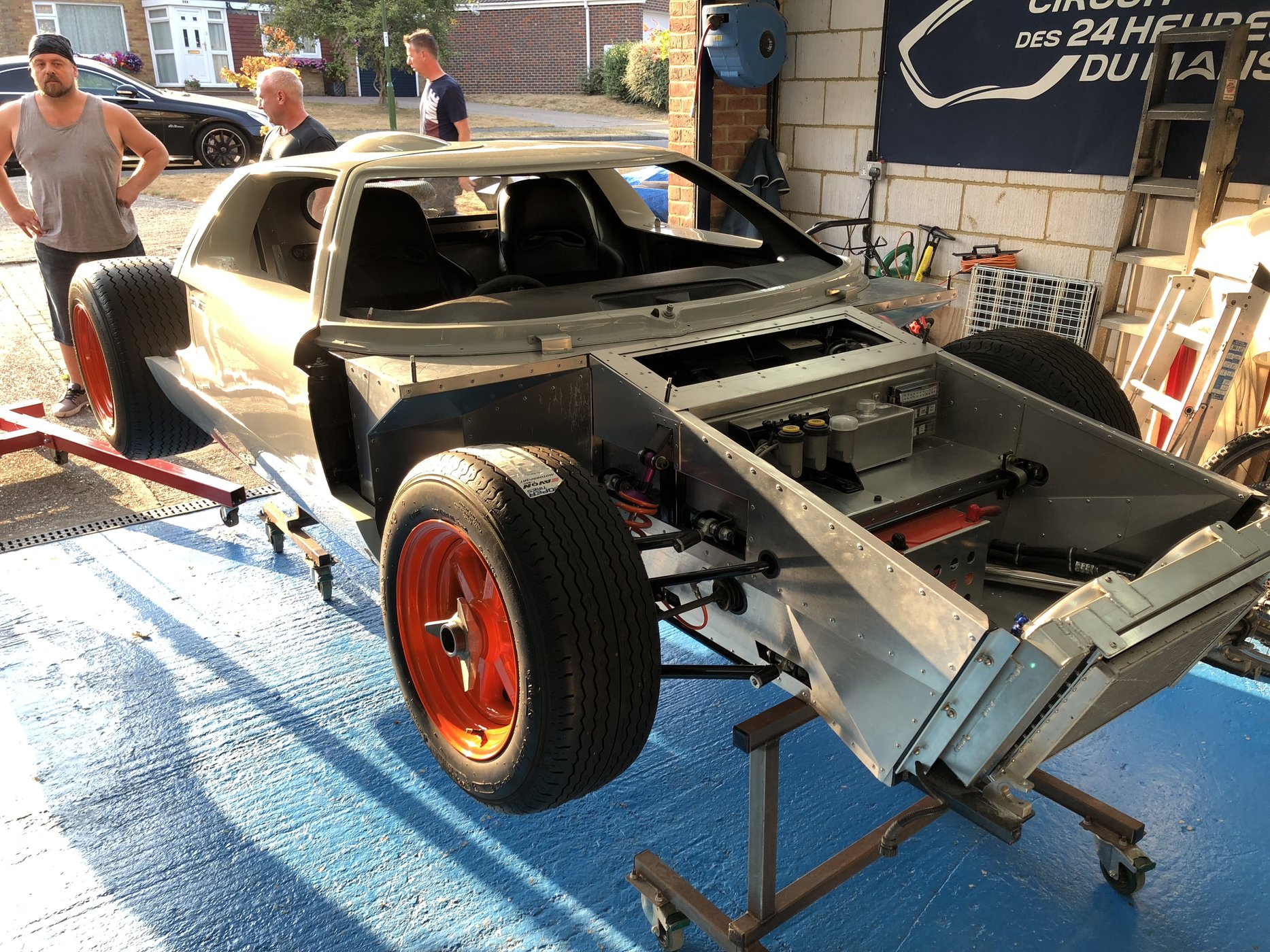

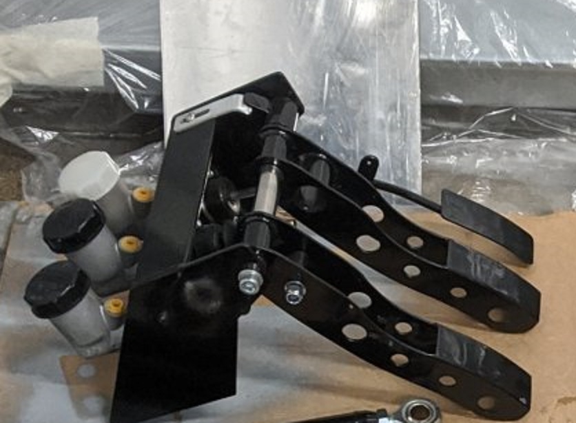

As the title suggests, looking for any advice on stopping my feet getting wet, advice and ideas most welcome. Some pictures shamelessly stolen from PaulBav build thread, sorry Paul.

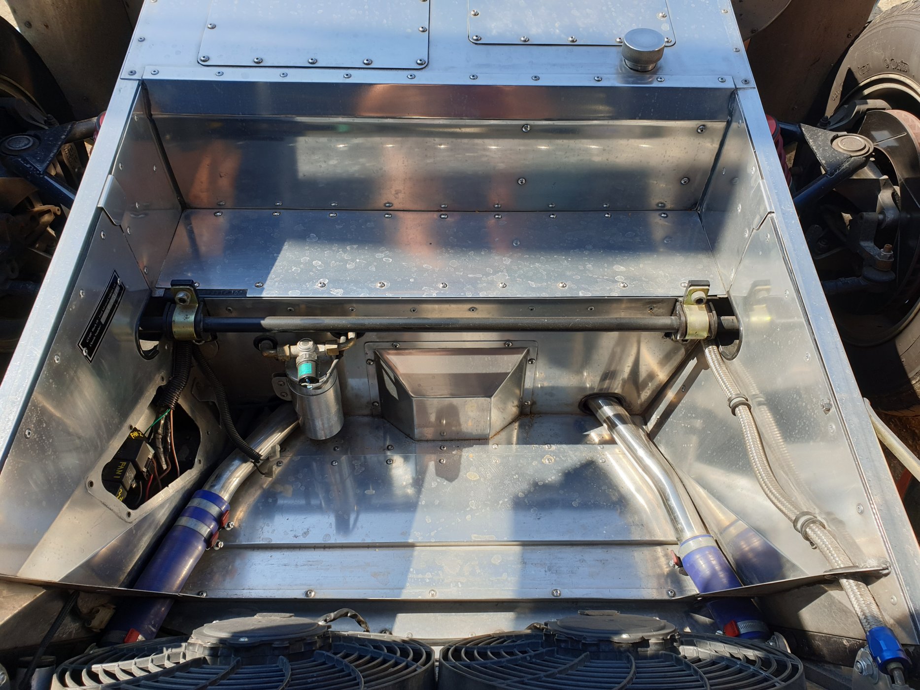

New "borrowed" picture of the latest SGT top mounted pedals and reservoir box.
Nick
I presume you are concerned about water getting into the rectangular opening above your feet, just in front of the windscreen ?
All of that water will eminate from the windscreen, so I make and put in two small angled deflectors above the panel, in front of the windscreen but under the outer body panel, to direct this water sideways into the outer suspension area. Works well.
