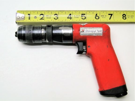

That looks like a nice drill. Its speed would be good for drilling steel but for drilling small (1/8" to 3/16") rivet holes in aluminum you should use a higher rpm drill. High rpm reduces the required pressure on a drill's cutting edge and extends its life. For drilling aluminum I'd recommend a keyless pneumatic drill with 2,500 to 5,000 rpm. Here is an example of a 4500 rpm pneumatic aircraft drill. Kerosene or diesel oil is a good lubricant for drilling aluminum.
