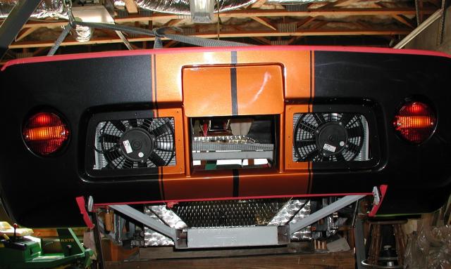

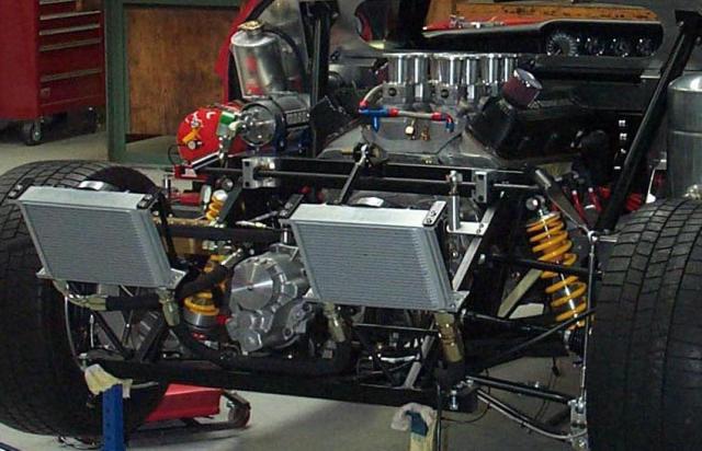

I have the fans mounted at the rear of mine. Yes they are for the radiators. One for the engine oil, that comes its way when the proportioning thermostat opens. The other is for the trans. I have been told that even the rally Porshes don't use them, but I already had one and I think it keeps the proportions even. These are Spal 9" units. Have them keyed up to run either on thermostats or override with a switch.
You might take a note from the Lotus guys. My 85 turbo Esprit had a fan mounted over the engine that bew out the louvers behind the rear window. Was not a big fan, but then it was only a 4 banger.

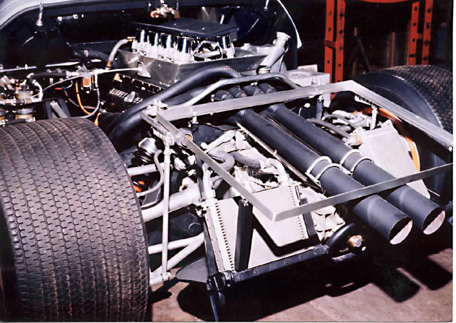

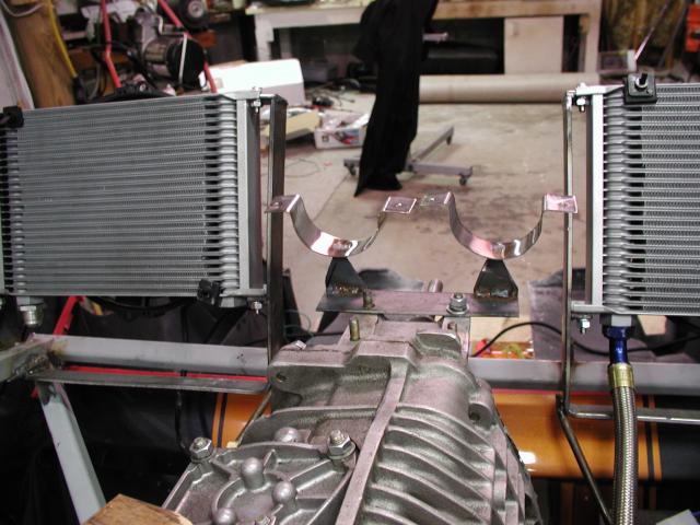

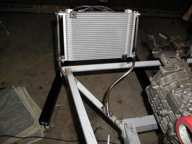

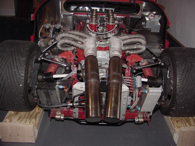

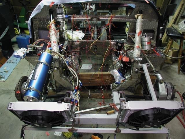

I inverted my coolers thinking that the coolers would not fill. What I forgot was that the resistance to flow is in the cross fins. The filling area is low pressure and would fill before the resistance to the fins would allow flow. The oil coolers in the original cars are mounted that way.
I had a few extra shots of some other cooler users, so threw them in.

Yes Bill - yours was the car I was thinking of! :) So how was your logic faulty on the positioning of the oil coolers?

The faulty thinking is that there is increased resistance in the thin cooling fin runs compared to the open filling tubes which are a larger diameter. The oil or whatever will seek the lowered resistance to flow, thus filling. I am at work right now, so I can't show you the pictures of the cooler in the 66Road car elsewhere on this forum. But the true test is to put your hand next to the cooler, and feel the temp at different parts of the cooler. They will be the same. Look at any race car that employs coolers above the engine and unless space is a problem, they will fill and empty from the bottom. Remember that most have a pumping mechanism or pressure high enough that the fluid will go to the least resistance first and the highest last. there may be air "bubbles" but not vast sections of the cooler not filled.

On the street oil temp never got above 200, But I was seeing oil temps around 250-270 at my first trip to Thunderhill so I added a 19 row Mocal cooler .I mounted in the back like Bill has shown with no fan in my CAV. Went to Spring mountin and could only run 15 min. and oil was at 270. So I have moved the cooler to passenger side air scoop and built a shroud to duct the air in. Hope this works better! So I question the rear as a good location, as I am not sure witch way air is moving , in or out. Panteras have a rear mounted A.C. condenser and the fan pulls air into engine compartment.So are we sure if air is being sucked in or out, of the rear??

The fan(s) in the rear of my car are setup as pullers. I think that is more efficient than a pusher set up??? I would think that the area at the rear of the car would be a low pressure area due to the little bit of spoiler effect?? I am thinking of closing in the rear lower segment of the car(under the trans) and adding a little down force area under the rear of the car. That should negate any negative pressure in the engine bay. If I can get my ignition people on the ball, the car should be on the road in a week or two. Will post more then.
Are you saying it matters in terms of cooling if one had mount the cooler your way or with the openings down the other way ?
My thinking is there is no difference in cooling nor in filling ( like you expressed) . it is just a preference and desicion how to do the best and most convinient installation ( the way the oil lines run to the cooler). Can you confirm this ? ( want to do it right from the biginning)
TOM
Tom,
If you go back to my build site(DRB#5) you will see I had them originally mounted with the entry/exit in the down position. After some discussion on the forum, I decided to make them top fill/exit. After talking to the engine builder, I found out that it doesn't matter which way you mount them. I guess with the up mount, you will expel all air bubbles. It seems that the only place you would have the bubbles would be on the exit leg. The cross fins would be filled due to the pressure head and the resistance to flow. With a few heat cycles I would think the air bubbles that might accumulate on the down mount would be done away with. I could change mine back, but then I would have to cut my tubing to fit, and I have gone through enough and my wife has me back on a budget.
