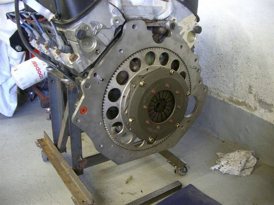

I'm looking forward to experimenting with my flywheel/clutch setup. The flywheel/ring gear is made in one piece nitrided (sp?) steel, paired to a geared starter & a twin plate clutch.
Compared to a stock 302 assembly my flywheel/clutch is a massive 17kg lighter (~35 lbs) plus a few lbs saved with the starter motor.
I'll pay a price with a fierce clutch ! but aside from the overall weight saving, there has to be handling benefits due to the reduction in gyroscopic effect.
Anyone care to comment?
