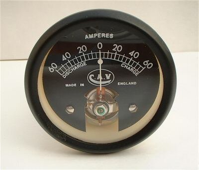

Hi Doc
The big bit of metel across the back of the meter is the shunt (not the fixing bracket) hope it helps

Thanks for the pic (just what I wanted to see) and thanks Geoff for the ID of the "shunt".

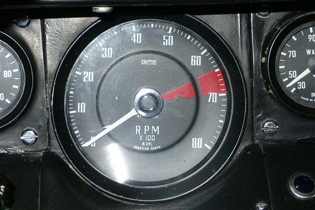

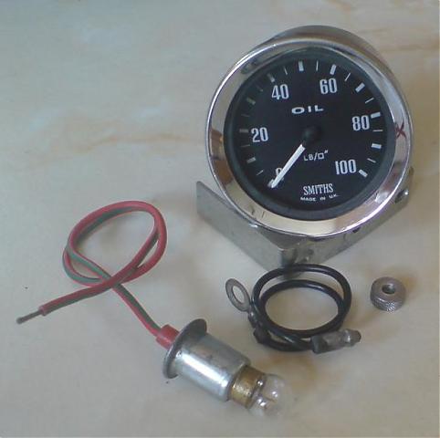

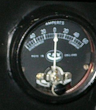

No there is no light but I will be putting one in myself. I'm taking the assembly apart to paint the inside of the gauge red as per originals and while doing that sorting out the drilling of a hole in the rear for a bulb and holder. Also the gauges (apart from the ammeter) all need a 'Chinese hat' added to the needle holder which is a 6-7mm plastic cover (see the rev counter photo, the needle centre has a disc on it which looks like a chinese hat) which prevents light shining through the needle assembly on 'normal gauges' although looking at the ammeter there is loads of empty space where a back light could shine through.... might need to rethink the ammeter lighting. Picture of my oil pressure gauge with back lit bulb and holder, ammeter will have similar bulb and holder. Also pic of 'chinese hat' in original rev gauge, and original cav ammeter which just shows the red internals.

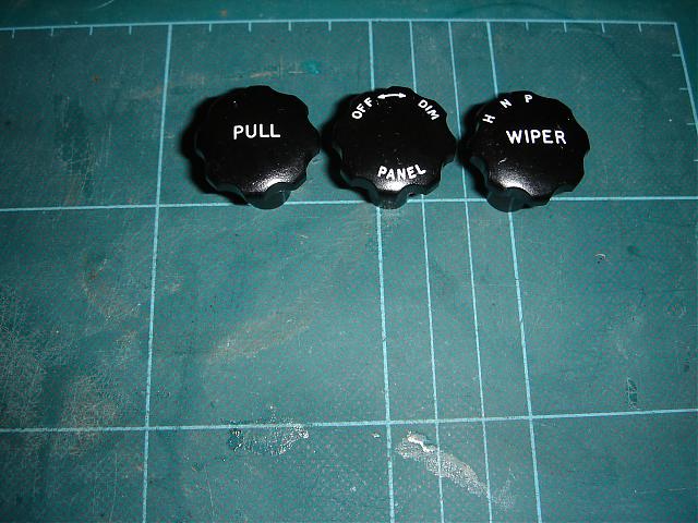

Steve, all gauge bulbs are wired seperate to the gauges and have a small knob which is used to increase/decrease the intensity of the bulb lights so are wired together as a group. The circuit is wired to a switch (see photo, middle knob) which turns on and changes the gauge bulbs intensity.
Discussed bulb for ammeter in the other thread, sorry had a wedding reception friday, and work saturday.... if your gunna have a hangover at least get paid for it.... so late replying hope this helps.
Photo of dimmer knob shown.
BTW the 'Pull' knob is for activating the martin baker passenger seat ;-)

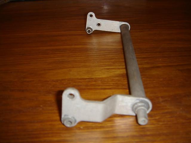

Hey dont mind at all....we all like a bit of drifting...... just let us all know what your up to.... got one of these????
and I will probably make the hats from plastic, heated and then formed, although I will check some gauge restorers/suppliers first.
Andy
