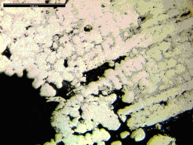

Powder coating aluminum also creates potential problems. If you are baking the aluminum, you are potentially ruining its "temper." All of the aluminum alloys are made using a specific process of annealing, cooling and aging in order to meet the ASTM and AA standards. This is all done in order to get the internal crystalline grain structure of the aluminum alloy to be just so. By reheating the aluminum, you are effectively ruining the work that went into it when it was created. While the aluminum may appear to be okay, once the temperature reaches a certain point, things inside begin to start moving. It may not be the aluminum itself causing the problem, but the metals it is alloyed with. Aluminum has an approximate melting temperature of 660C, but Zinc (often found in aluminum alloys) for instance has a melting temperature of only 420C. However, the material will be changing before it even gets to the melting point.
The point is, if you're going to consider something like powder coating, you need to understand the limits of the material you're using. The different aluminum alloys will all react differently to heat so it's important to understand the limitations of the specific alloy you are using, hence the reason there are so many different alloys with different chemical compositions.
I'm not saying it can't be done, just to use caution.
Metallurgist? I spent a few years in a research lab doing metal corrosion investigation, and while you're definitely right about the grain structure of annealed metals, I seriously doubt its a major factor in the production of the AL used in the chassis materials. To really screw things up you'd probably have to take it from just under the melting point and then quench it.
Chemical interactions and environmental factors are going to contribute to the aluminum deteriorating any faster than steel. If you want to last longer than just about anything, gold is the only way :lipsrsealed:... and that's not an option. If anything, you'll create a dendritic structure that is copper/zinc rich and/or it will corrode along the grain boundaries.
If you want it to last, park the vehicle in a temperature and humidity controlled garage, and never drive it in the rain.:p:
ME actually. My graduate thesis research focused on studying aluminum deformation under incipient melt conditions. I learned quite a bit, still no expert by any means.
The aging time and temperature to achieve a certain temper are pretty specific with aluminum alloys. For example, the ASTM aging temperature for 6061-T6 is 350F and the metal is held at that temperature for 8 hours and allowed to cool. This is in range of the temperatures used in powder coating. So, if you were to expose the metal to a higher temperature than 350F for an extended period of time, you could potentially overage it and weaken it. That is why it is important that the person you have doing the powder coating knows what they're doing. That's the only point I was trying to make. Aluminum should not be treated like steel. I'm sure many other people here have read the threads on other car forums pertaining to improperly powder coated wheels failing at auto-x events and track days.
Personally I wouldn't worry about corrosion with the chassis as supplied as long as you're not exposing it to anything caustic. I was just trying to advise others to use caution when dealing with aluminum.
Heh, I was trying to agree to a certain extent, but I've actually never heard of PC'ed wheels failing like that. I was more of an ancient alloys investigator. Obviously Al alloys weren't used (at all really) until around the Industrial Revolution so my experience is relatively limited.
The method/speed of cooling dictates the grain structure as much as the amount of time spent at a given temperature. What probably happened with the wheels is that they were raised to temperature, coated, then immediately let out to ambient temperature to dry... thus "erasing" the properties which were produced for an application such as wheels.
In fact, if the wheels were set out and allowed to (relatively) rapidly cool, they would be much more brittle and prone to cracking under impact. With the SLC chassis, almost certainly the welding seams would be the weakest in terms of grain structure because they undergo the same effects, but seeing as the method of construction is race proven and pretty much beyond reproach, there's little concern there.
