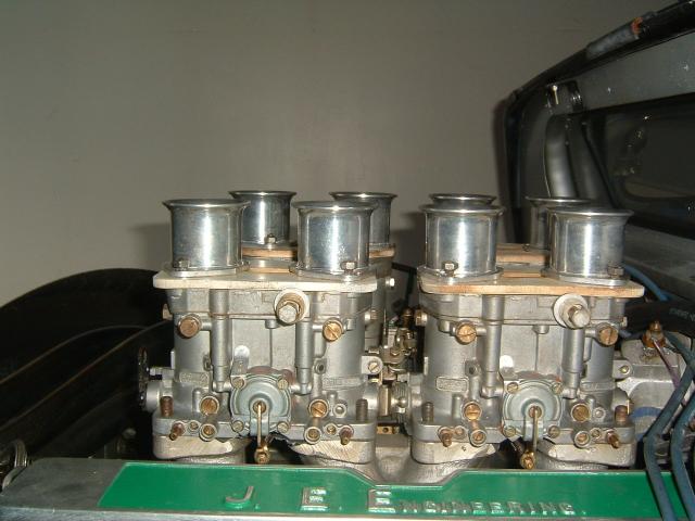

Amazing what a bit of metal polish and elbow grease can do!
