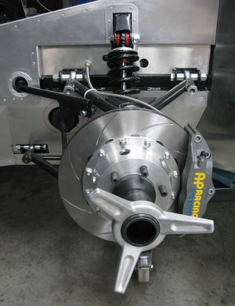

Caliper stiffness is one of the main benefits with AP. Say on a CP8350 the calipers are designed with anti knock back springs and stainless pistons. Square cut hi temp o rings. Ap does not use pipe thread fittings all crush washer style fittings. Built in bleed screw protectors, Well over 50 years worth of podiums

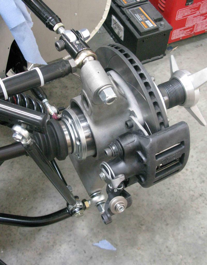

Brembo cable operated handbrake , IVA compliant !
