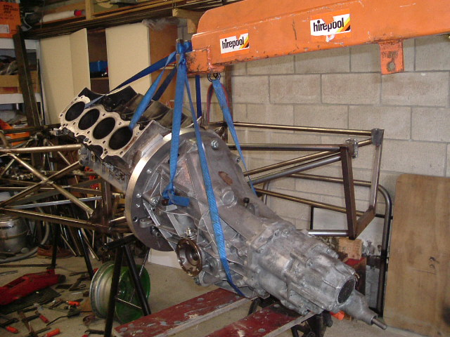

Cliff I have two of them and thats what I am using in my Mclaren M8B, not that this is any reason to make them better. One came from an Audi GT of around the 86 mark and the other from a wrecker. The main difference I am told is the obvious alloy case versus steel and the gear set is just a little narrower on one of the sets having seen both 016 and 013 stripped side by side. The basis details and dimensions are `identical` except the gear shift positions. To that end I will run my 013`s and replace with an 016 if I get trouble. I do not intend to thrash this car so fingers crossed. I do have an Audi 100/200 manual that says the 013 came in the 2 litre set ups from 1982 to 1990. It lists 3 versions 3T, HE and HF. I will look at mine on Friday and see what letters are stamped. I dont expect any issues.
Come back if you need any more info.
Russell
