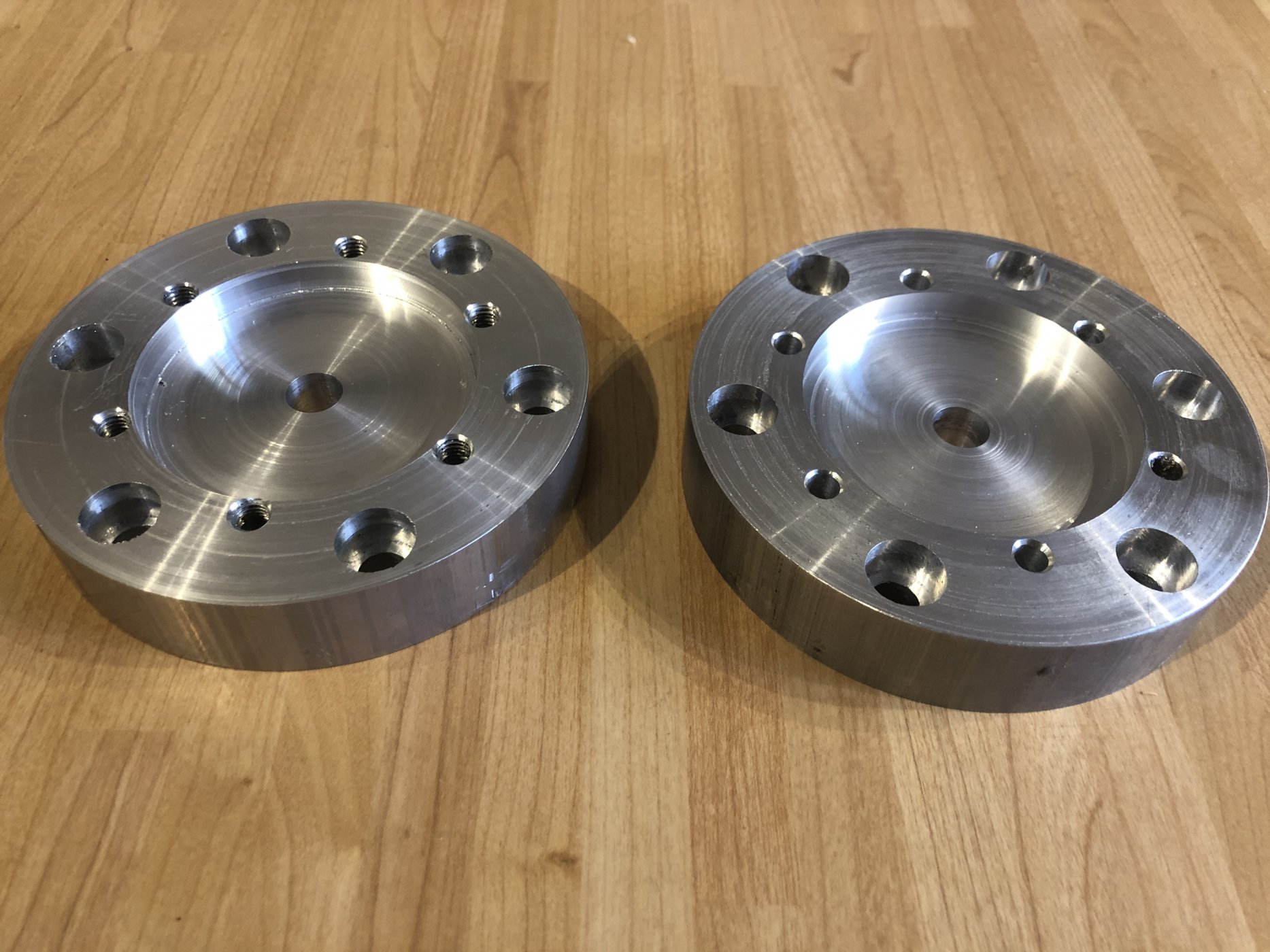

Here is a pic of two I made yesterday for and Audi 01E. I have the 01X.

Also, I have the Forte Chassis with the SGT Bodywork (GTD), and Windsor 302 mated to an 01x.. I made a slight mod to the lower section of the rear clip given the length of the Audi box. It was minimal modification.
These adapters are steel and measure as follows.
Gearbox side 85mm bolt pitch...102 flange dia.
Axel side 95mm pitch and 108 flange dia.

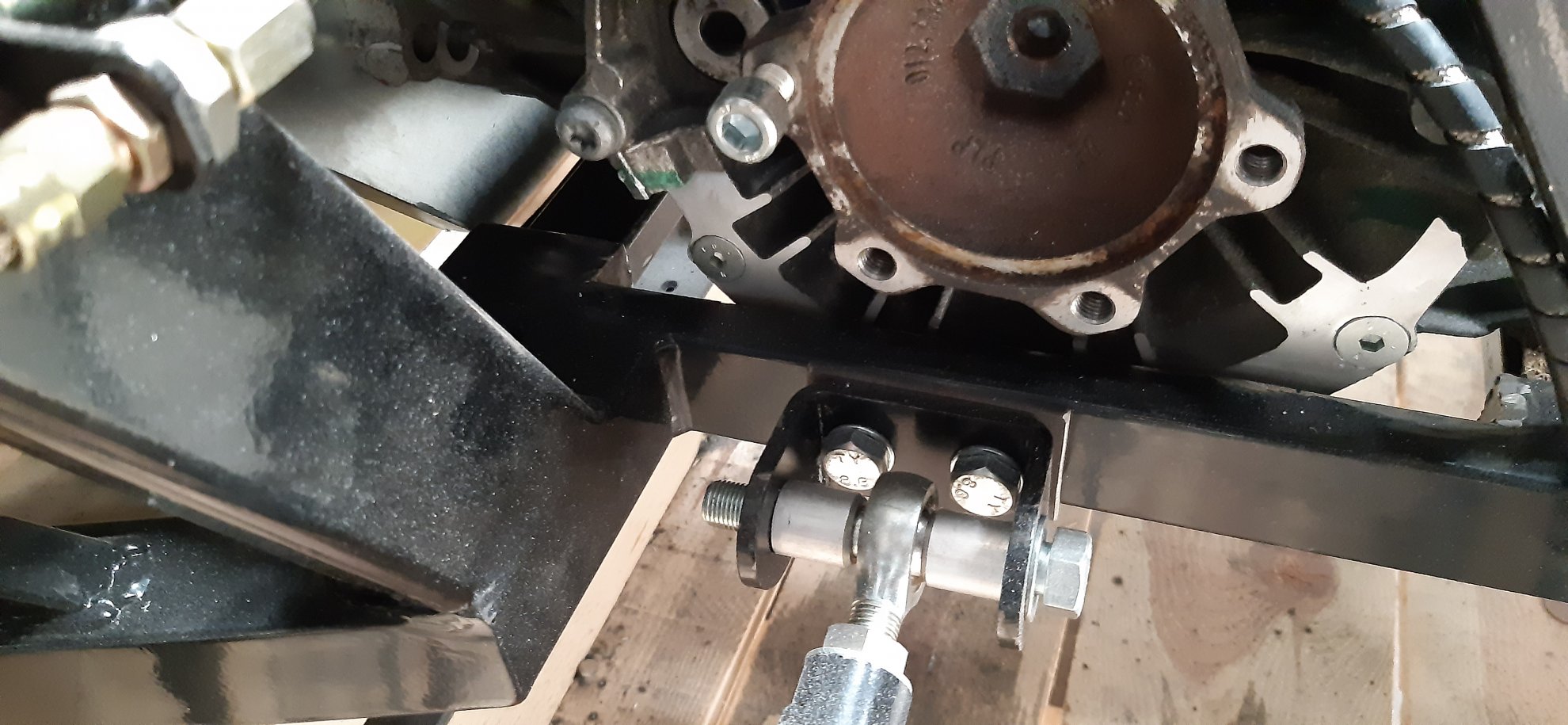

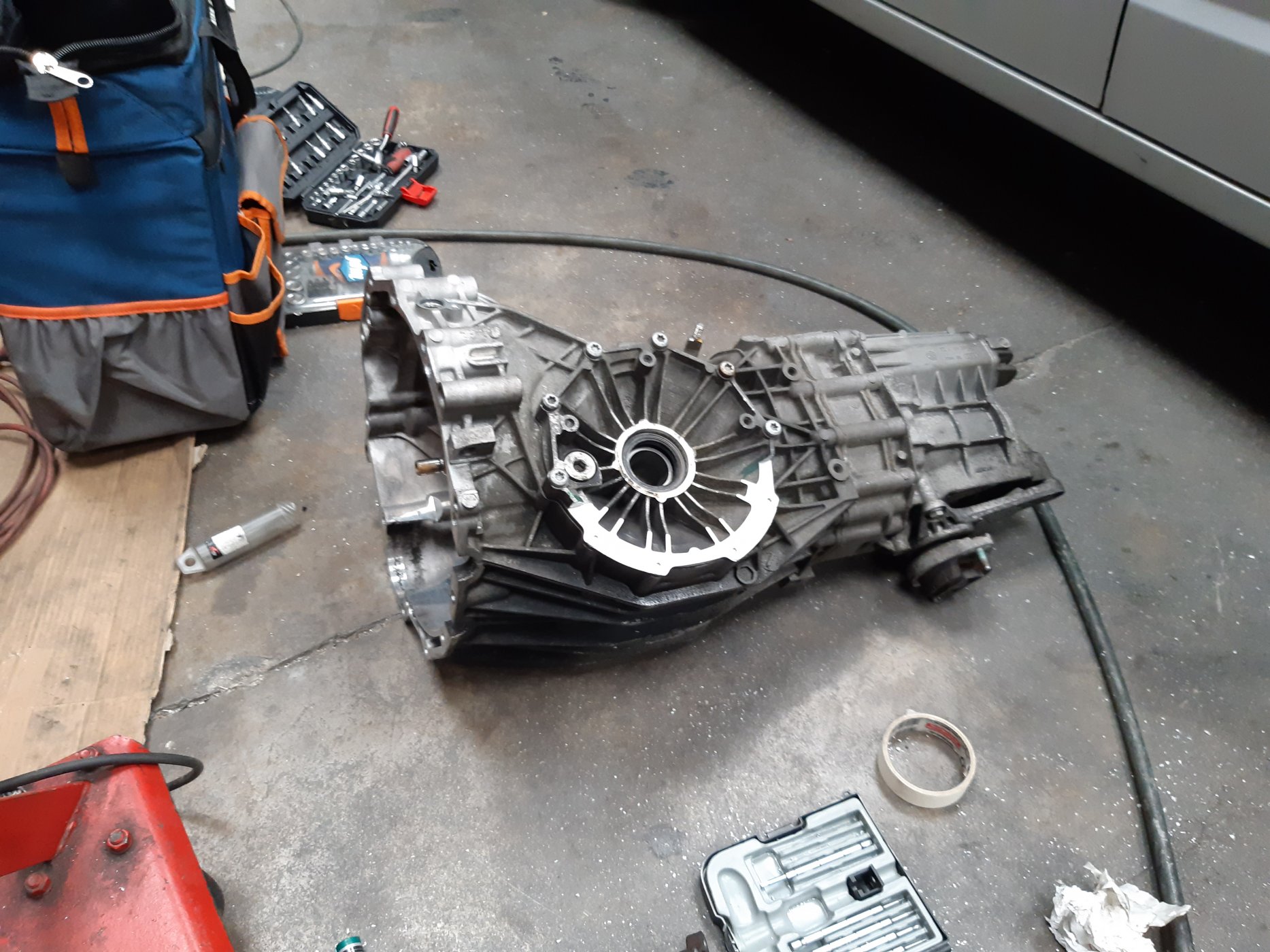

We are in the process to attach the gearbox to the chassis.

It is a special SGT chassis for coyote (coyote chassis order). No modifications have been designed for the audi gearbox. We had to adapt it
We had to slightly modify the chassis in the area where the left lobro is because it touched the chassis. The gearbox mounts will be custom made, we have not done it yet. Of course it is a much easier option to install a ZF box or a Renault gearbox, but I wanted a 6-speed box (from an Diesel Audi, HCF gearbox) since it has adequate gear ratios that fit very well with the torque of the engine.

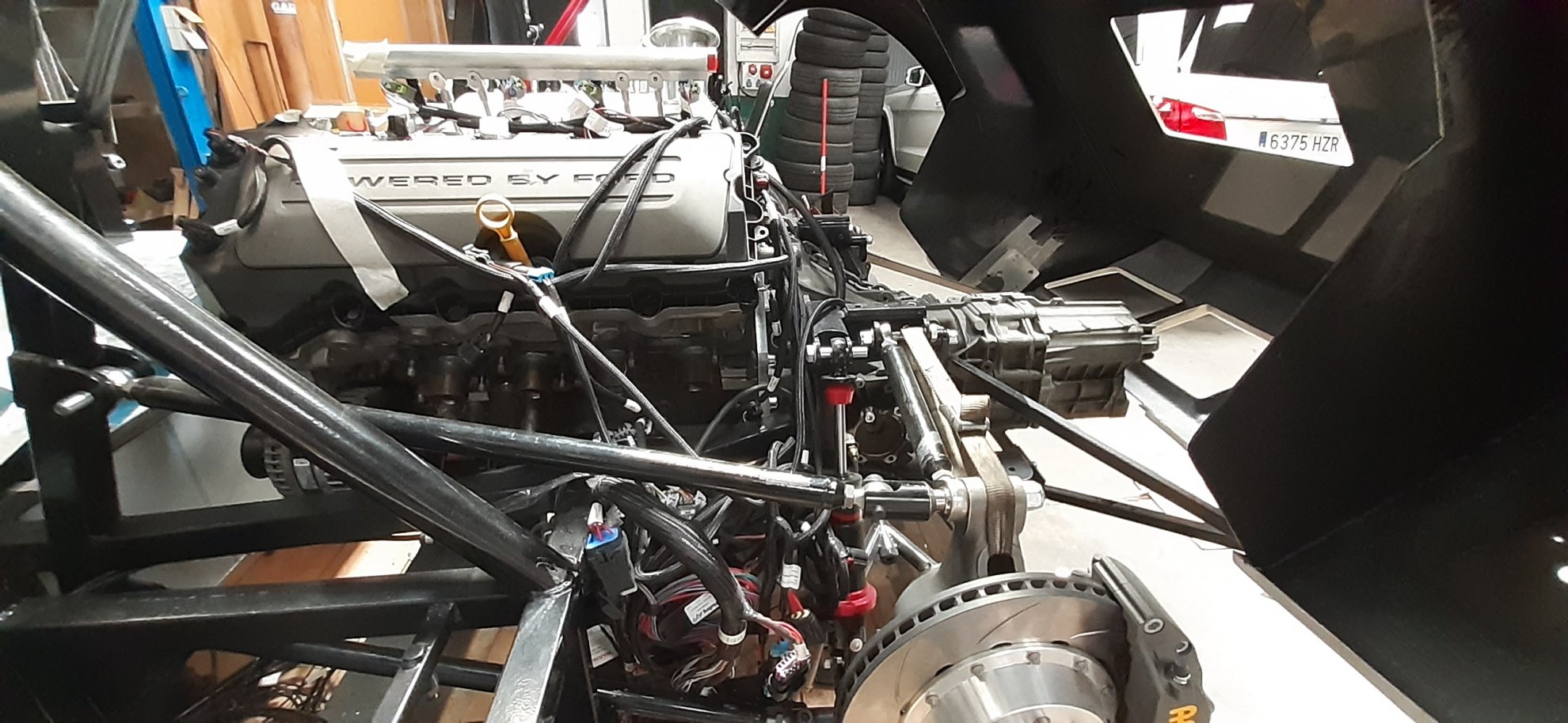

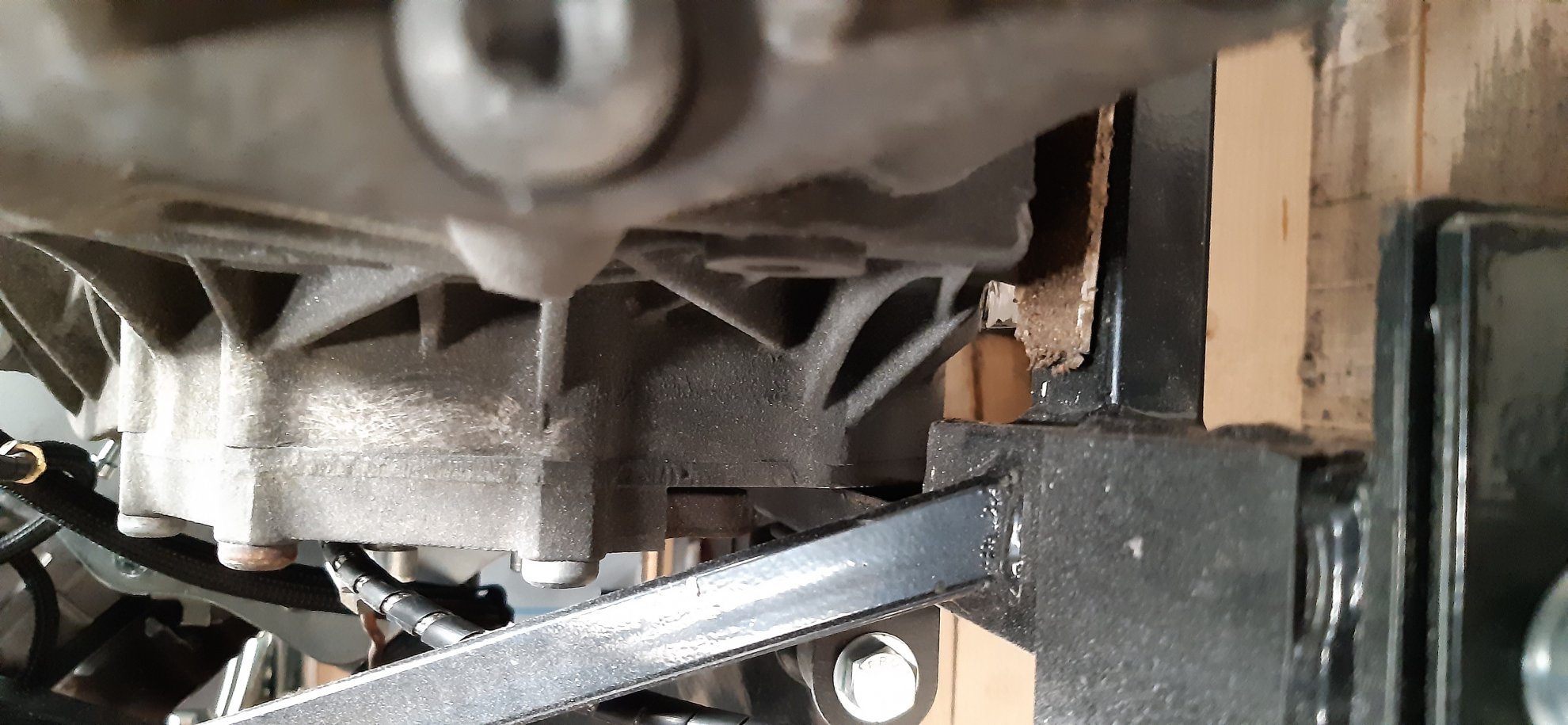

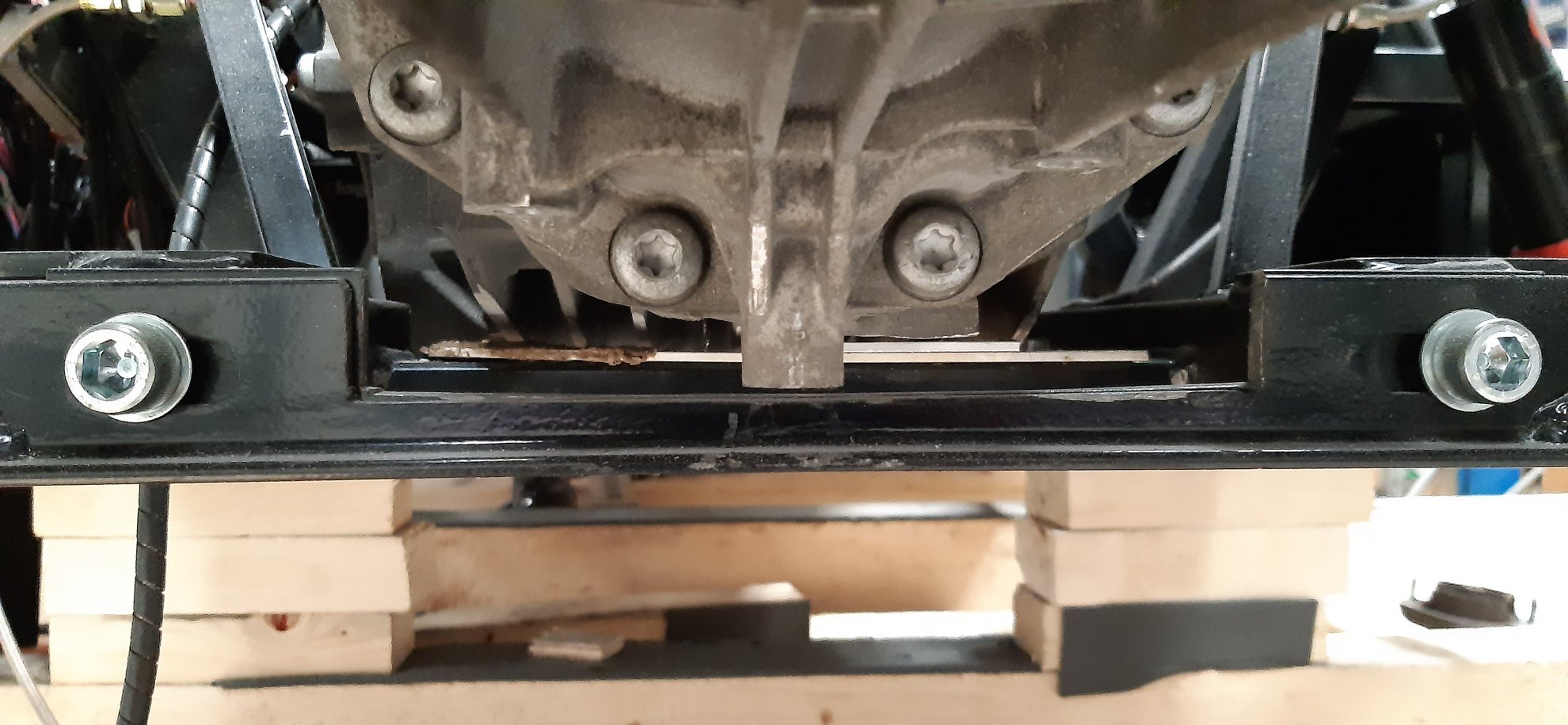

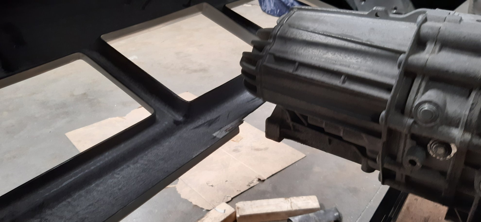

These are that I have

Did you end up reducing the thickness of the left side beam? As that's what my eyes see.
Looking at Udo's build the beam seems to be unchanged with all modifications being made to the cover.
See post #20
See post #20
Yes work eyes are correct. We reinforced the left side of the chassis by installing and welding new plates inside the chassis, in order not to reduce the rigidity of the chassis due to the reduction we made
