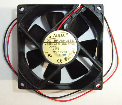

Just an idea but if your worried about cooking the MSD how about one of these. Not sure if the MKI and MKII's have the same raised box cover. If they do you could mount 1 underneath with a couple of vent holes on the side of the lid for circulation.
