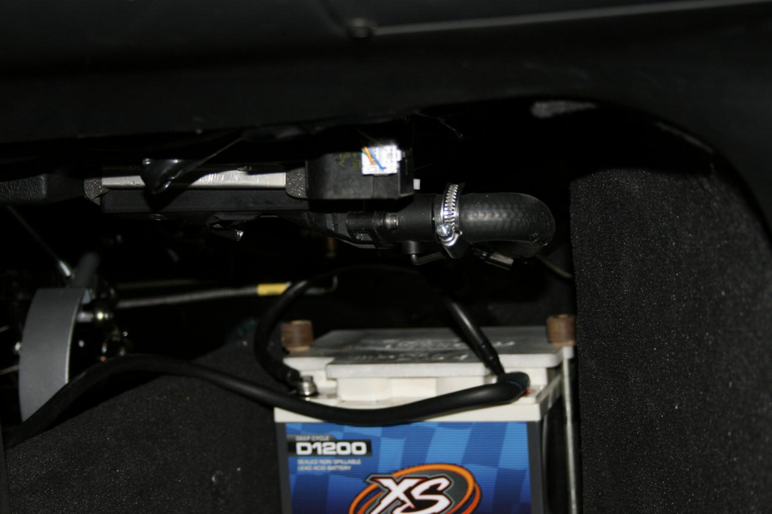

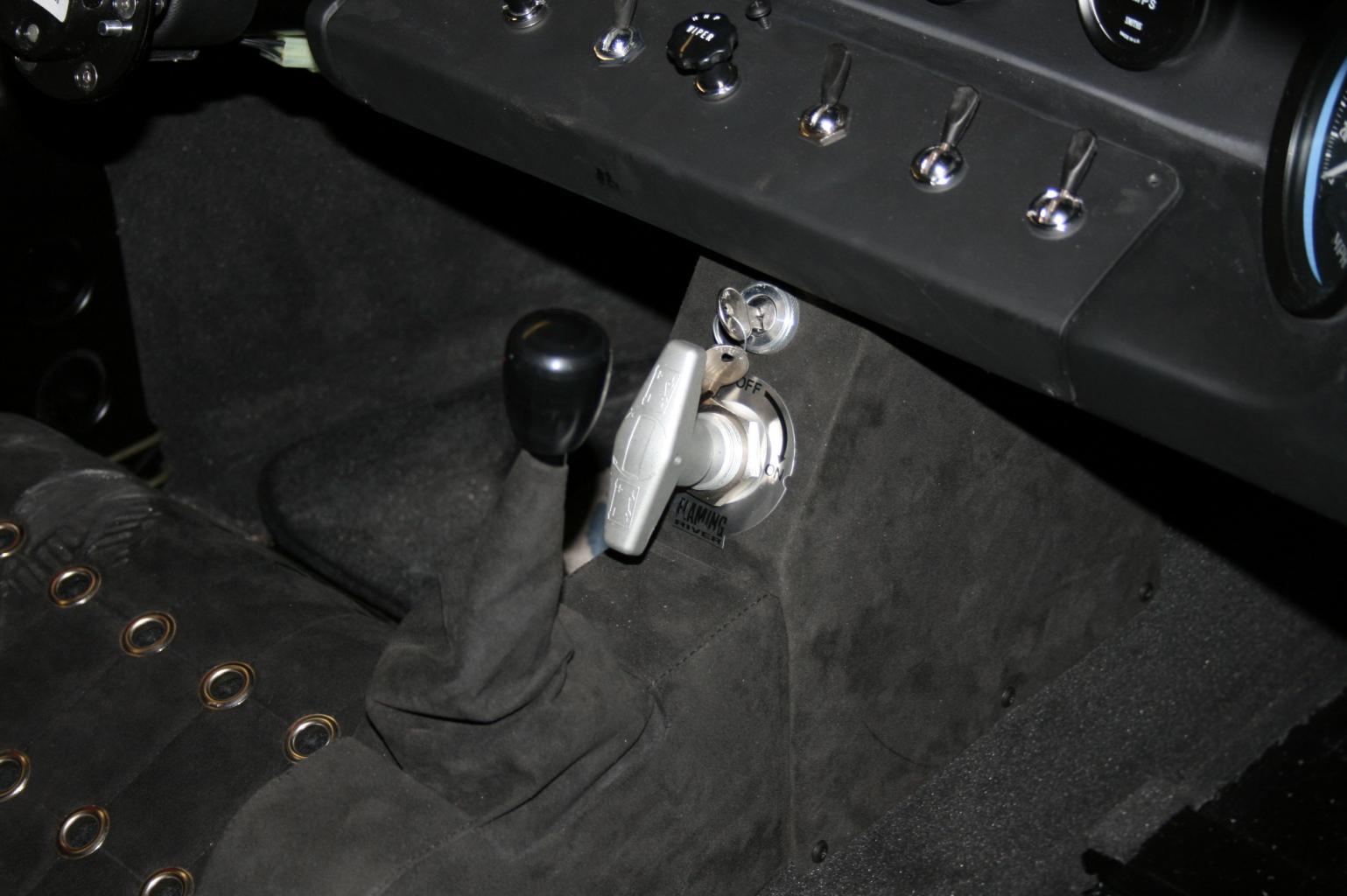

I have a master kill just under my key, it kills the entire electrical system, but my battery is in the passenger foot well.
Jack,
Interesting. I'm going to put my brake ballance adjuster there.
What prompted you to put the battery in the footwell? I assume weight wasn't a factor.
Jack Houpe
It did transfer the weight to the front of the car and on the passenger side which is normally vacant. My wife is afraid of the car.
It was Mike Trustys idea and I followed his suggestion, he did the same.
