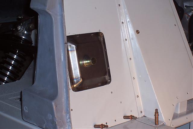

Or you could make a "pan" that raises the striker pin like this.

I made it and yes it's totaly adjustable. The pan is riveted to the rollbar and the adjustment is accomplished from the backside. I have a blockoff plate screwed on using nutplates on the back side. The hole on the right side is where you would use a socket wrench to tighten the nut on the back side.
Steve
Whatever you want, you make the pan to place the striker wherever you want it. Here is a picture of the hole on the back side for adjustment. There is a cover over it now I just don't have any current pictures.
Steve
