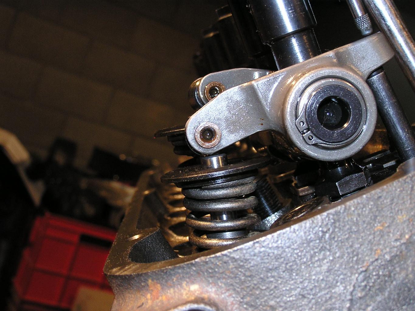

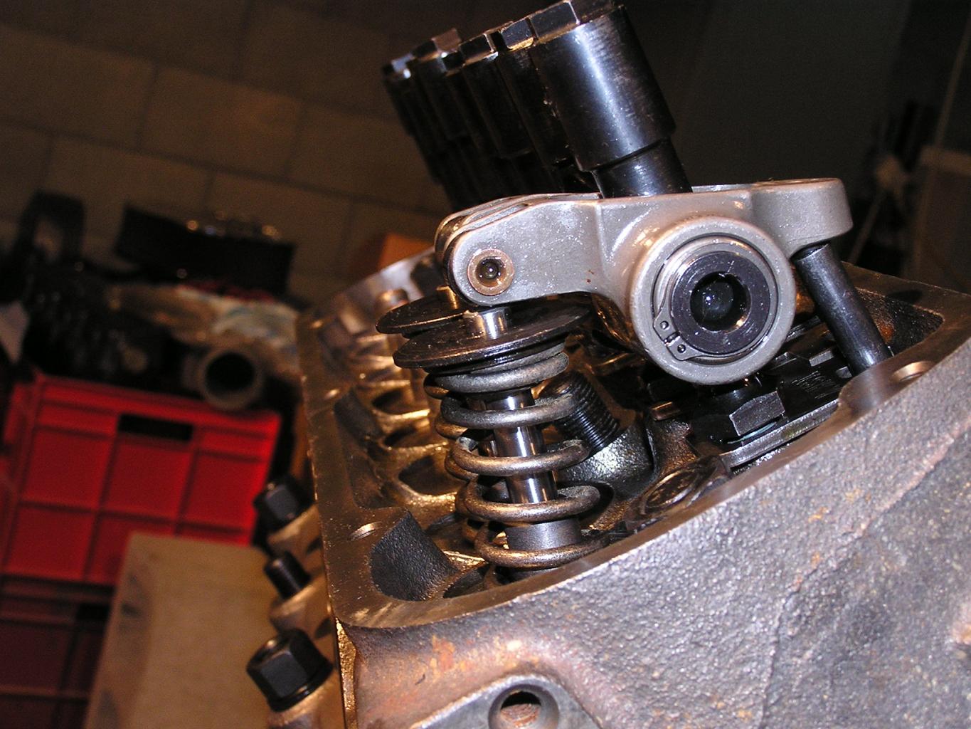

I certainly go along with getting your valve geometry correct. The best way I have to do this is to get an old push rod and cut a fair chunk out of the middle so you can insert a threaded section. Then adjust the length so you get the roller tip travelling equally either side of the centre of the valve stem.

In the mean time you can have a look at the pictures of the valve train of one of my jet boat engines which will give you a good idea. The cam used here was 238 deg @050 and .580 lift.

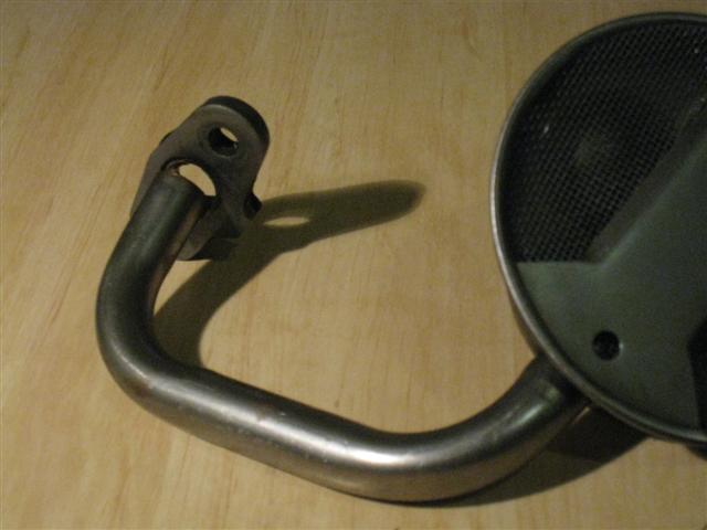

Race weekend -- do a few checks --start 'er up and rattly tappets a bit more than normal along with low oil pressure --tappets pump up --give it a bit of a rev and the pressure comes up a bit then drops off --shut 'er down, FFS !:cussing: -- (I know whats happened)--
Roll onto the hoist , pull the oil filter , all good , drain the oil , all good , pull the sump pan off and as was suspected -- a mostly dismounted POS oil pick up pipe
less than 6 months old.
Is there a better type of oil pick up for Windsors ??
