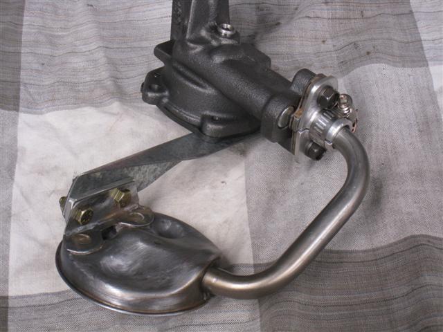

A....what are you doing at a race meeting with a standard pick up like that ?
B.......do as everybody says, brazing, gussets etc, even a strap to a main stud.
C...... you have got a balance / vibration problem, fix that first or it all ends in tears.

Thanks lads--I'll mend me ways --have a sneeky suspicion that it may have been manufactured by a Mr Fu ching of the Orient.
Mike , C.. you got me worried about vibrations --although it was all balanced before assy.
B.. will do
A.. what are the other options ??

Chris,
don't know what combination you have but we have come accross all sorts of balance / vibration problems particularly with the cheaper end cranks and definately with "kits" that come ready balanced.........not !
We have junked loads of cranks, even from some very well known engine suppliers, because of the problem.

Found a good 'ole OEM pre tested pick up and braced it -- all good, running and back to normal again---
