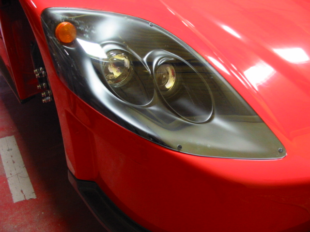

For clarification, by countersunk you mean the top of the screw is flush with the top of the plastic? i was reading that rcr visit thread and noticed that in this picture the screws arn't countersunk?
http://www.gt40s.com/forum/attachment.php?attachmentid=52109&d=1300805764
http://www.gt40s.com/forum/rcr-forum-rcr40-slc-p4-mkiv/34015-rcr-visit.html
(6th picture)
Just wanted to clarify that my definition of countersunk is correct.
