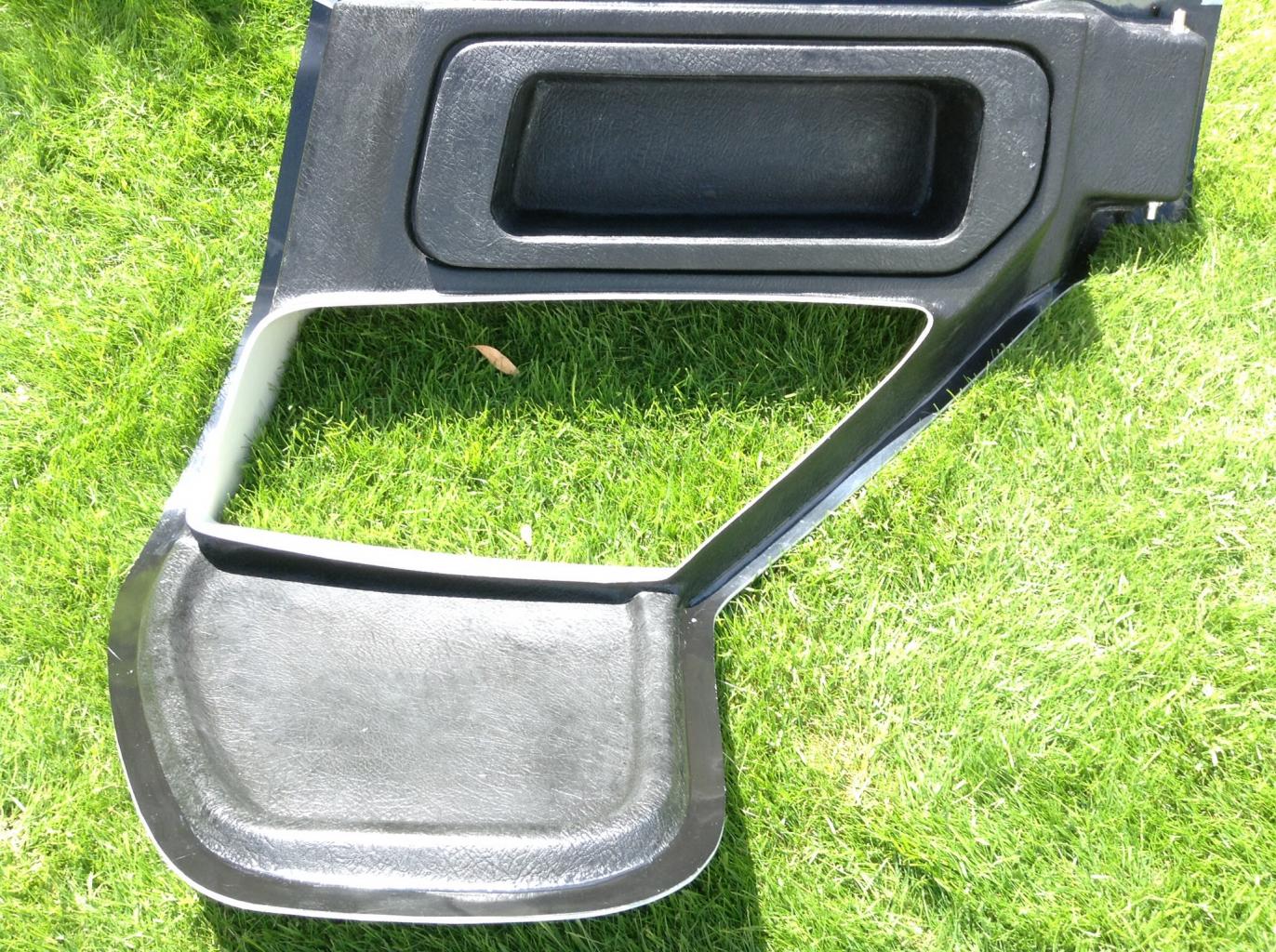

Sorry it upside down.

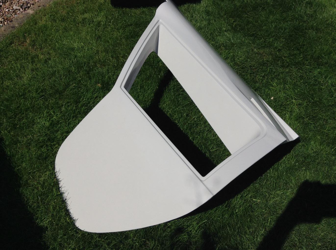

The door box is just balanced in place
The final fit will be better.

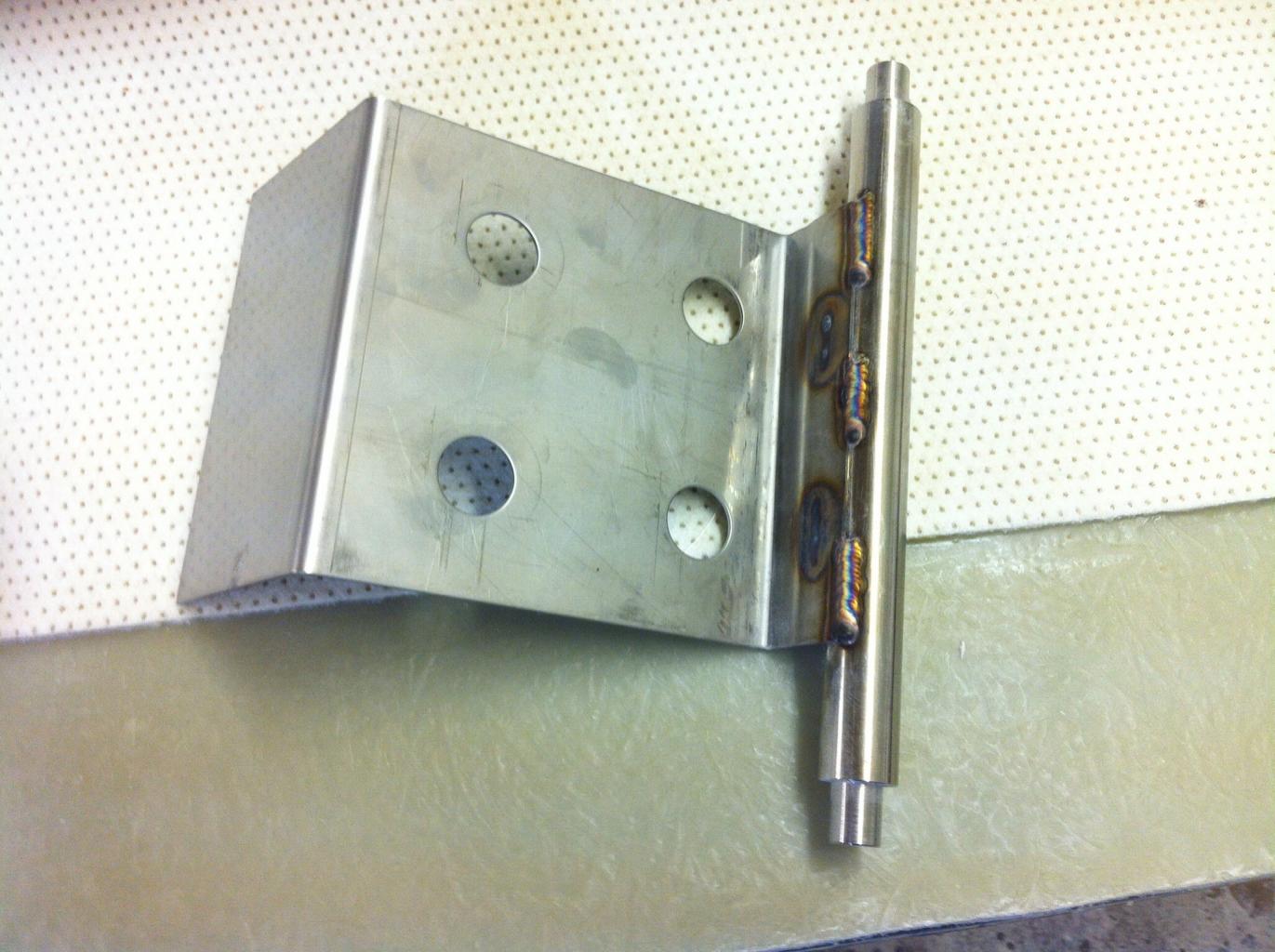

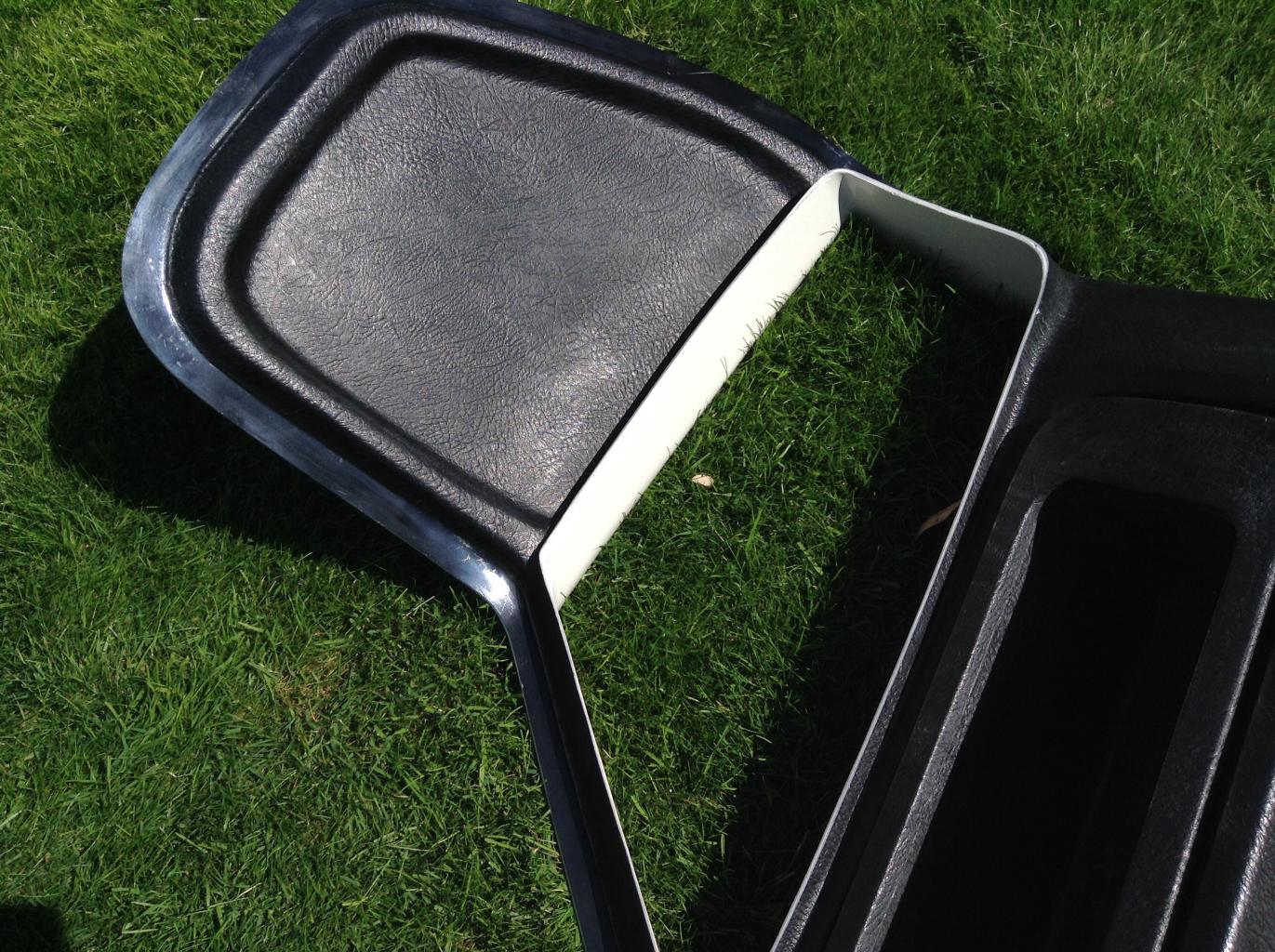

Lee took the time to explain things like how to screw this on from the inside edge so you don't need to have screws showing from the outside.
Hinge pin assembly to be bonded inside a door.
Wish I had turned the camera around and taken some pictures of Lee's workshop while I was there.
It's resting on the inside of a part made door panel.

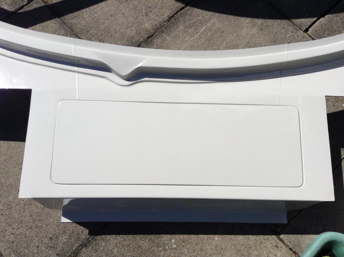

This area is typical of the care taken on bits you hardly even see when the car is finished.

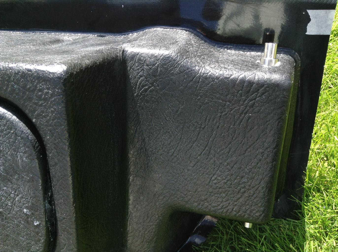

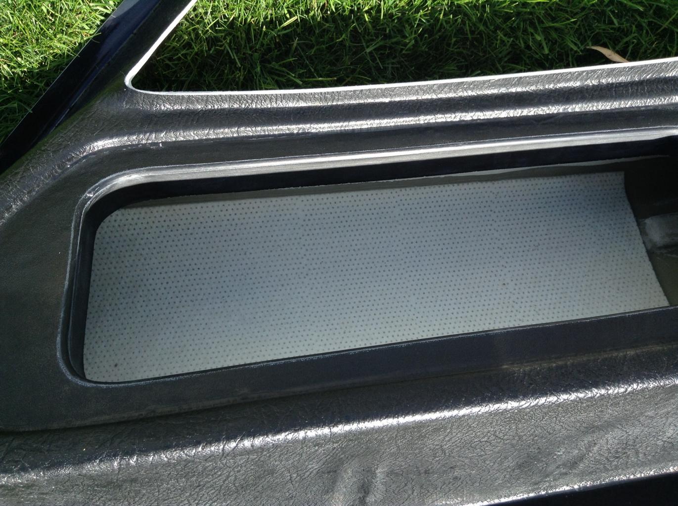

Ok final one.
I havn't shown the sills but they are just as good as the rest and finished inside with the same black surface.
Lee has promised that if the panels are all carefully aligned there will be an absolute minimum of correction or filler needed on them to make the panels fit.
There are lots of his bodies out there so others could confirm if this is correct or not.
I am inclined to believe him

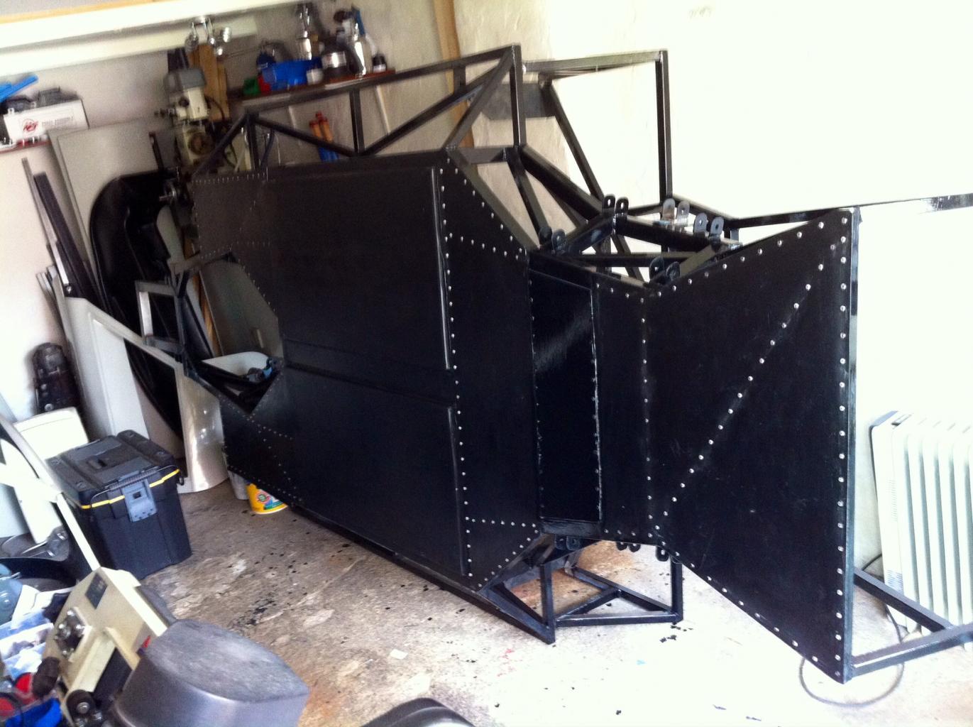

Thanks Mike.
Yes I hear what you say I won't be permanently setting up anything on the body until the rolling chassis is complete.
As a scratch builder I just want to be able to modify the design and weld on the extra bits for this body.
Sorry for the lack of posts recently but have made some progress. Hopefully next week chassis will be outside and right way up.
