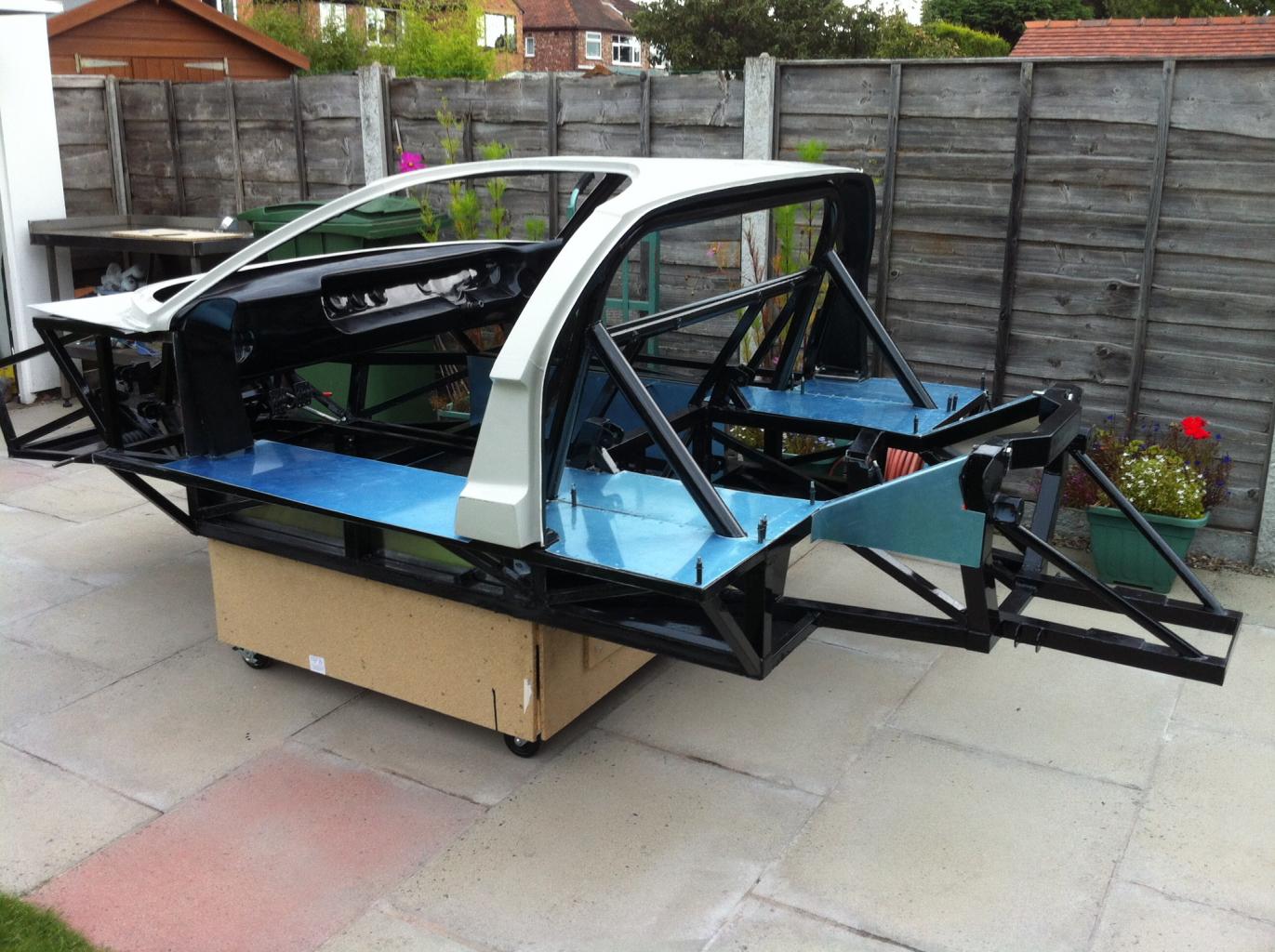

Most of the welding on the chassis is finally done.
Just the door hinge area to sort this week.
It will be good to start throwing parts on.
Taking a fairly relaxed attitude to fabricating the alloy panels.
I don't think many of us see it as the favourite part of the build

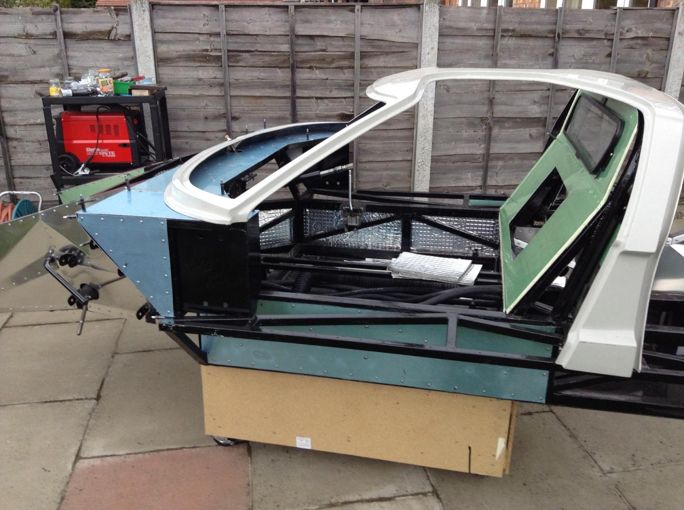

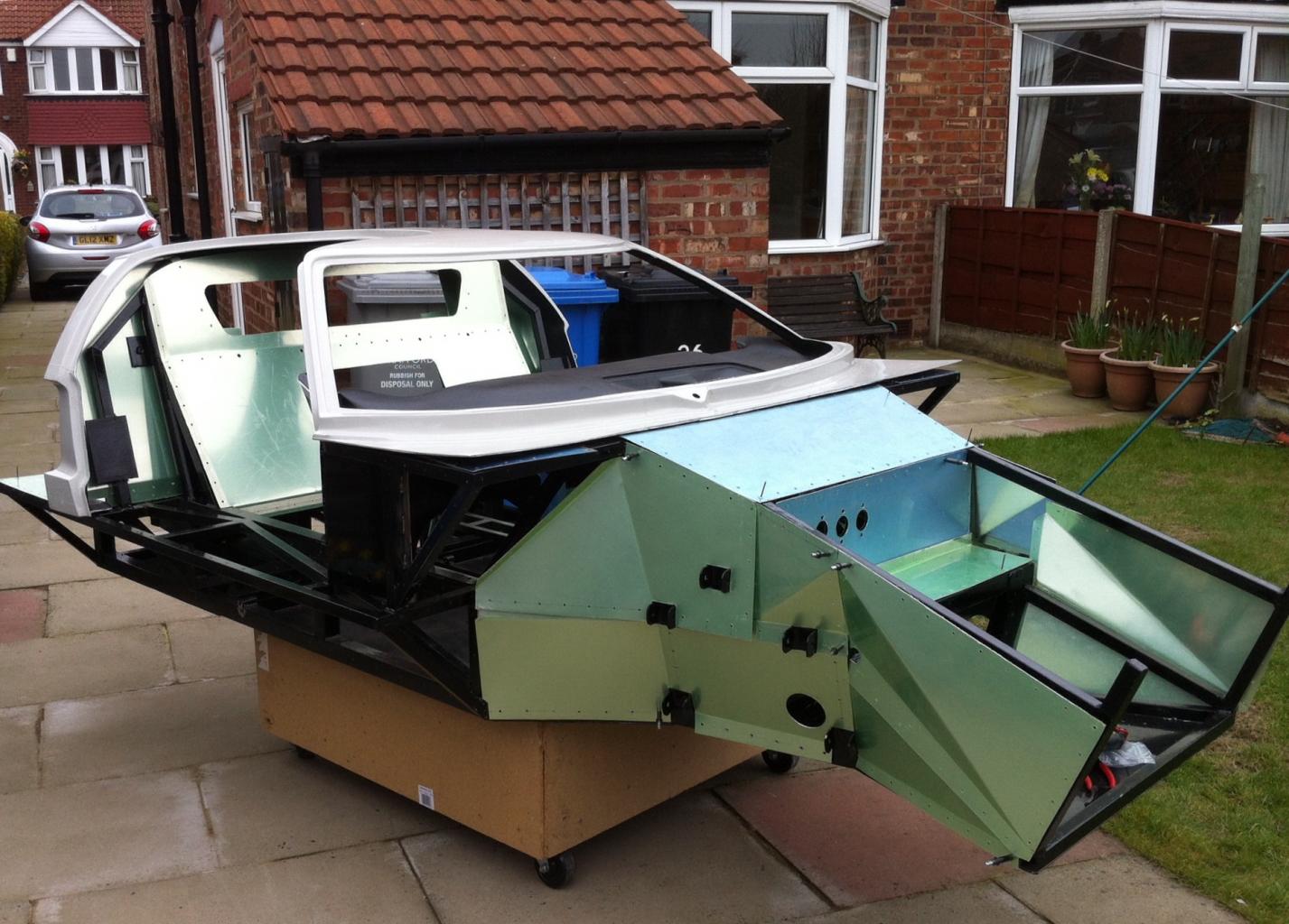

Wow, long time since I posted anything.
After a winter break I have been cracking on with the build. :thumbsup:

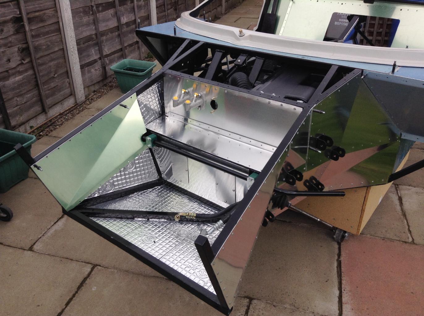

Shiny panels and shiny sound deadening. Makes a change from welding.

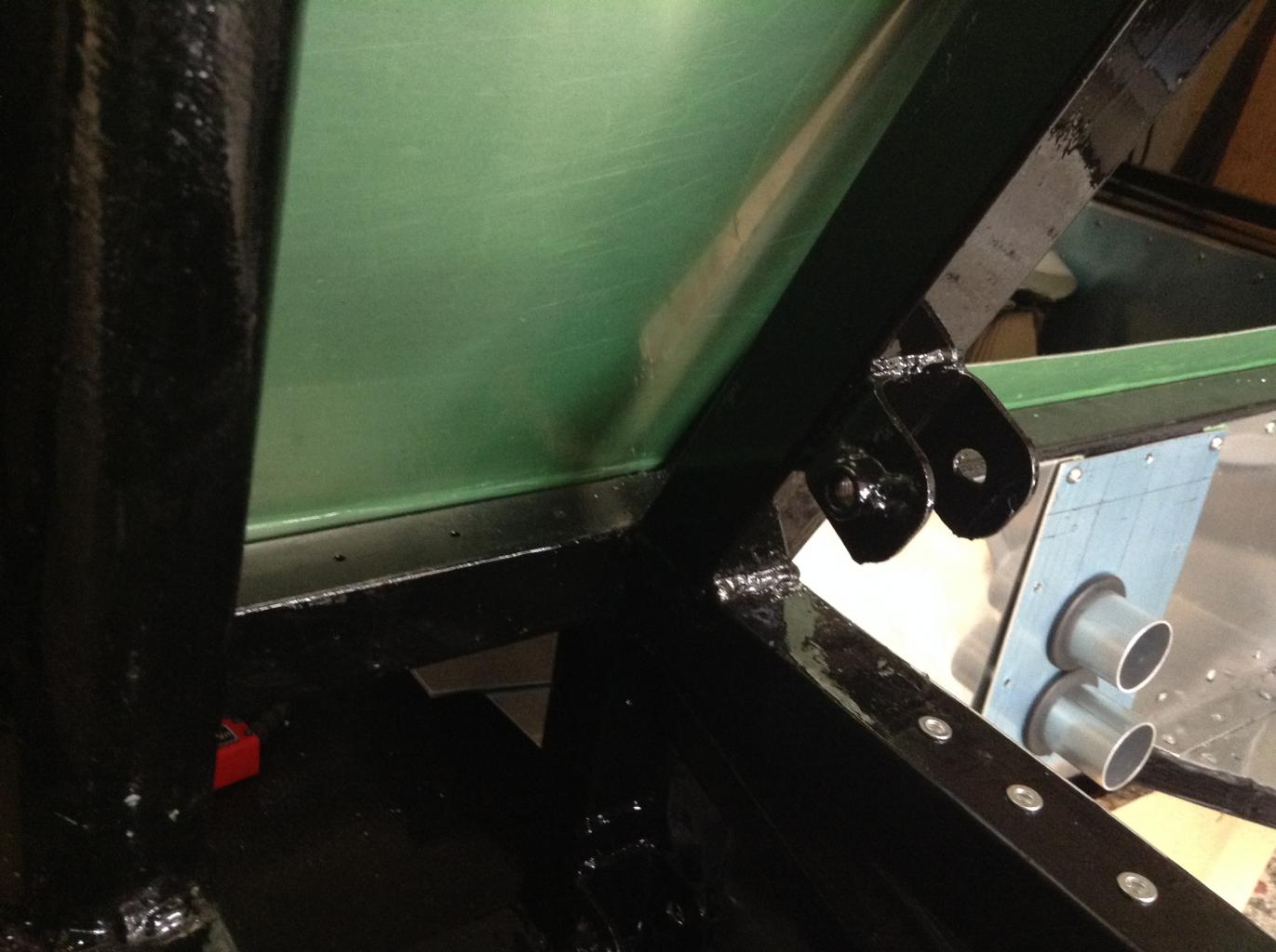

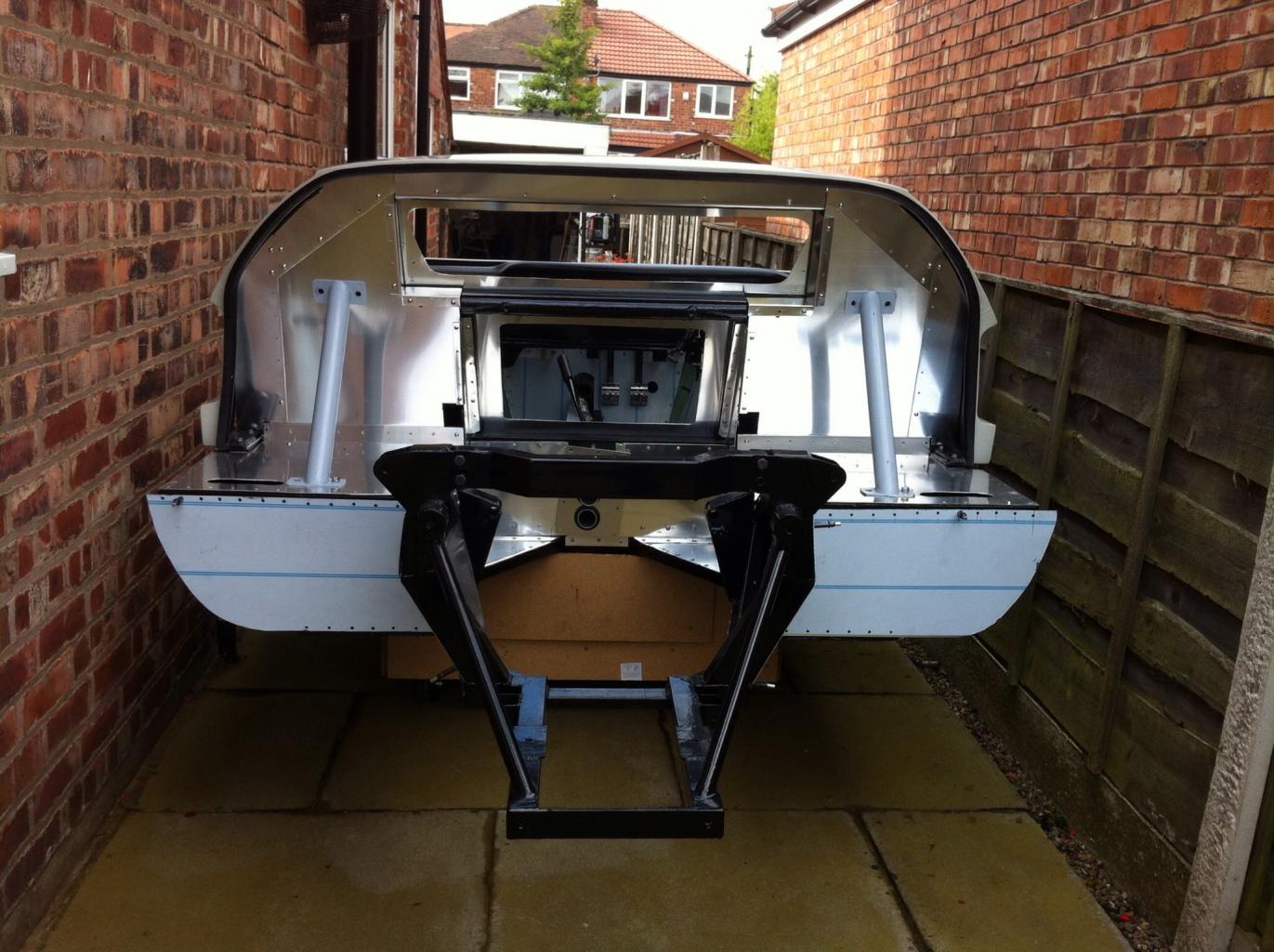

Here's a picture from last November.
I had to decide how to hinge the doors.
I decided to use rose joints in a similar way to Southern GT.
I put the Spyder on and Found it very easy to align the doors/Spyder/sills.

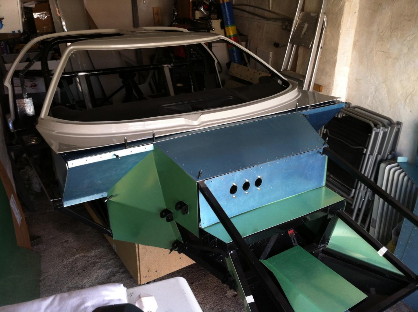

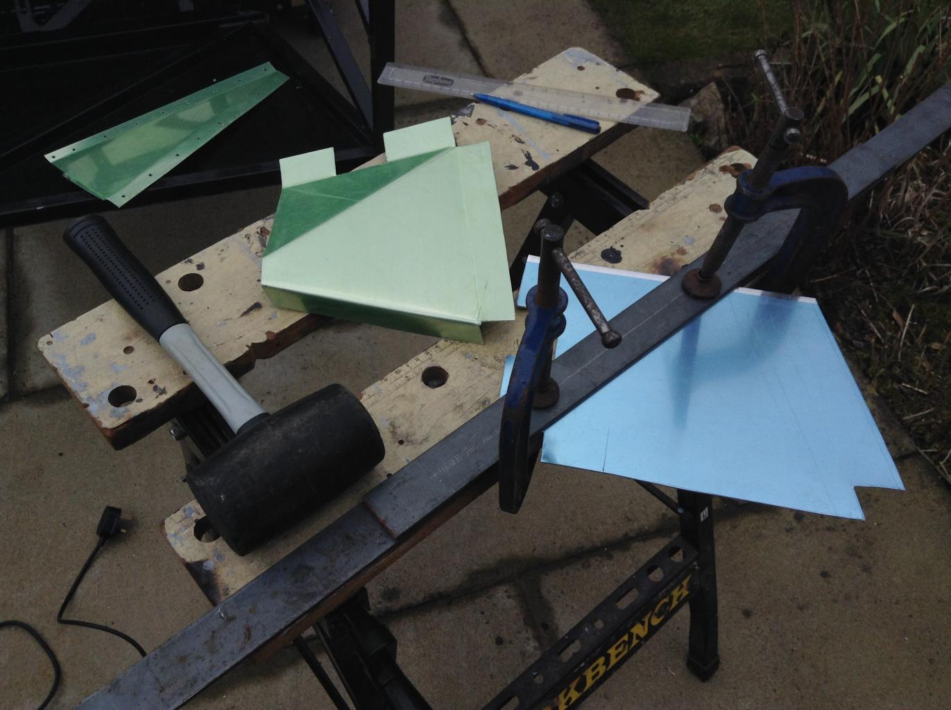

With regard to panels.
I wouldn't advise anyone to tackle these unless they have access to some high quality equipment.

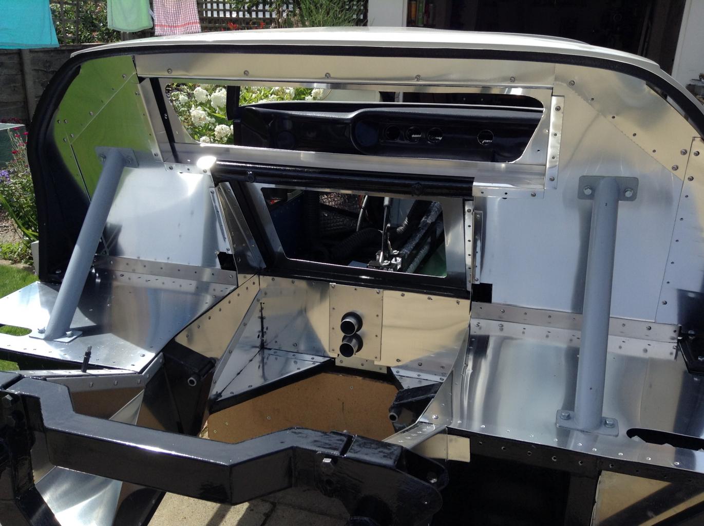

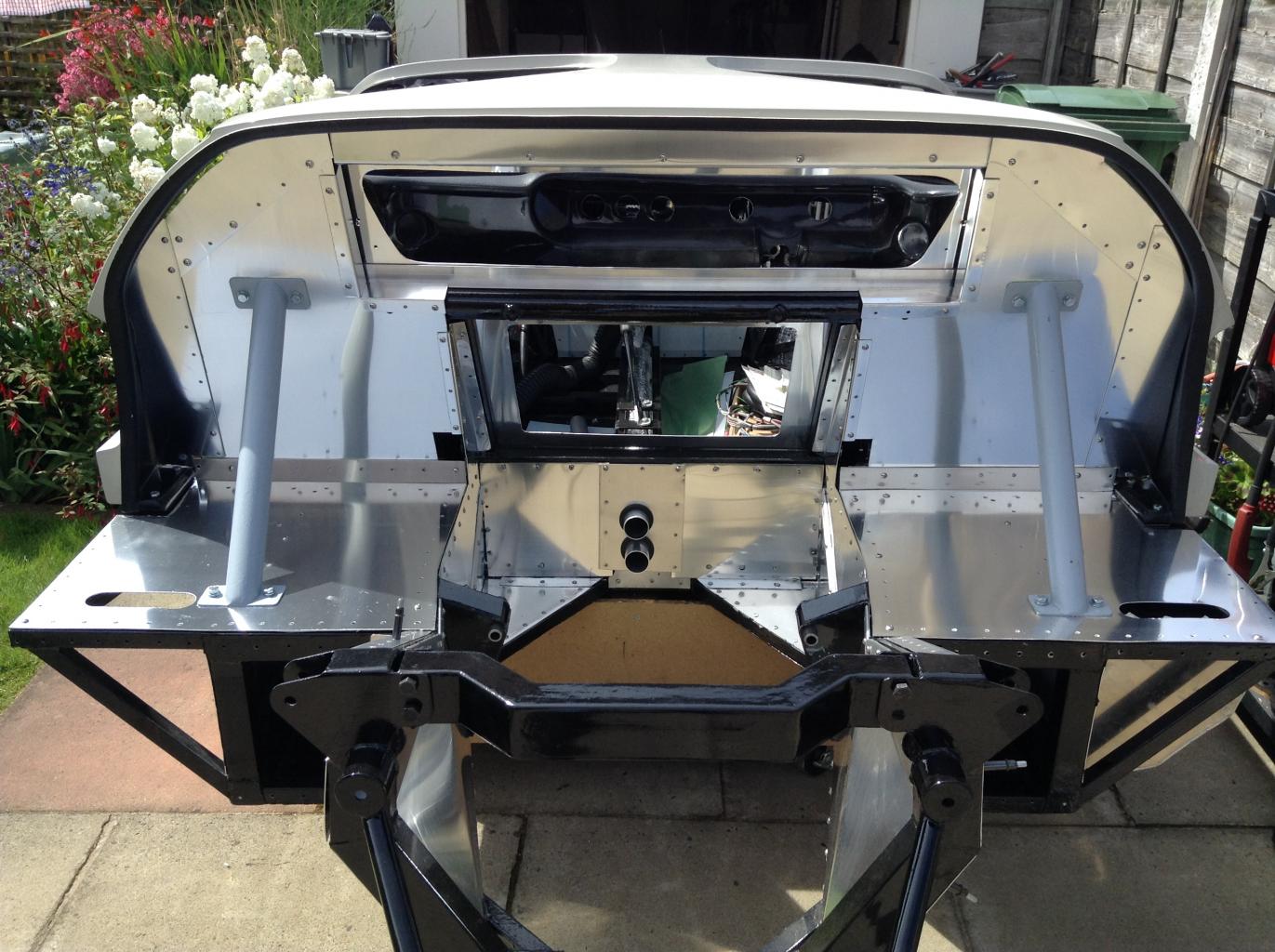

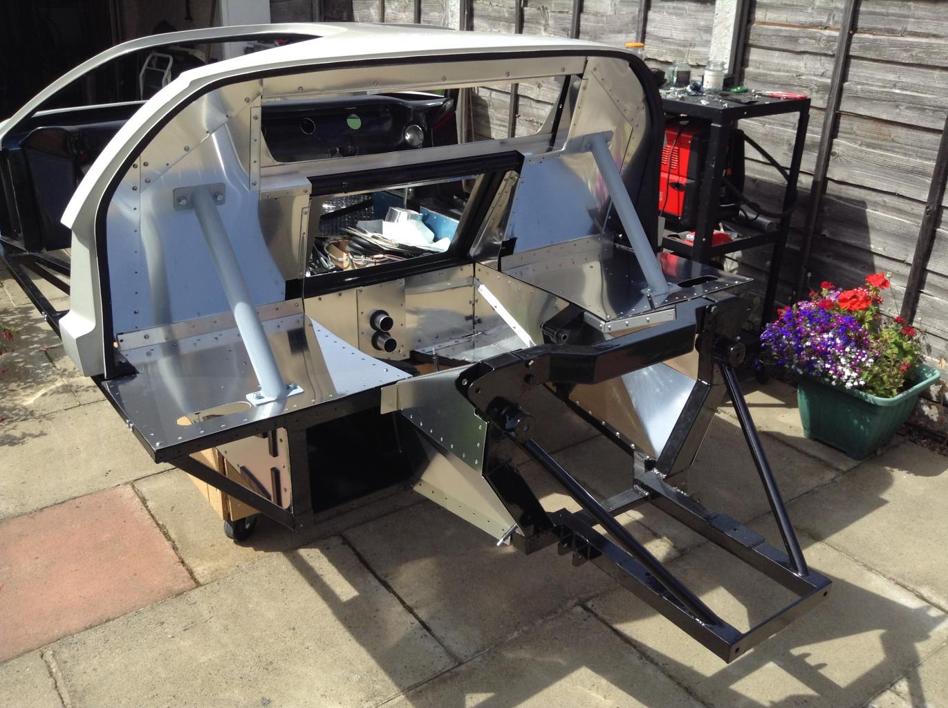

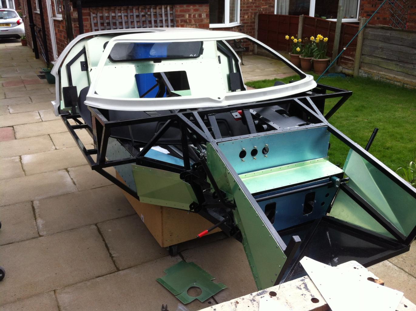

Been getting a bit done.
A bit of summer sun helps.

Thanks Ian.
Yes it is double skinned.
I am using reflective sound deadening mat on all the internal panels.
I plan to use "Fire-foam" on the bulkhead.
All the panels you see are being secured with 5mm stainless screws.
No doubt they will be removed/refitted more than once.
I will finally screw and bond them in place.
I used pop rivets (1000 of them!) on the floor sections and inner panels but I just hate the look of them.

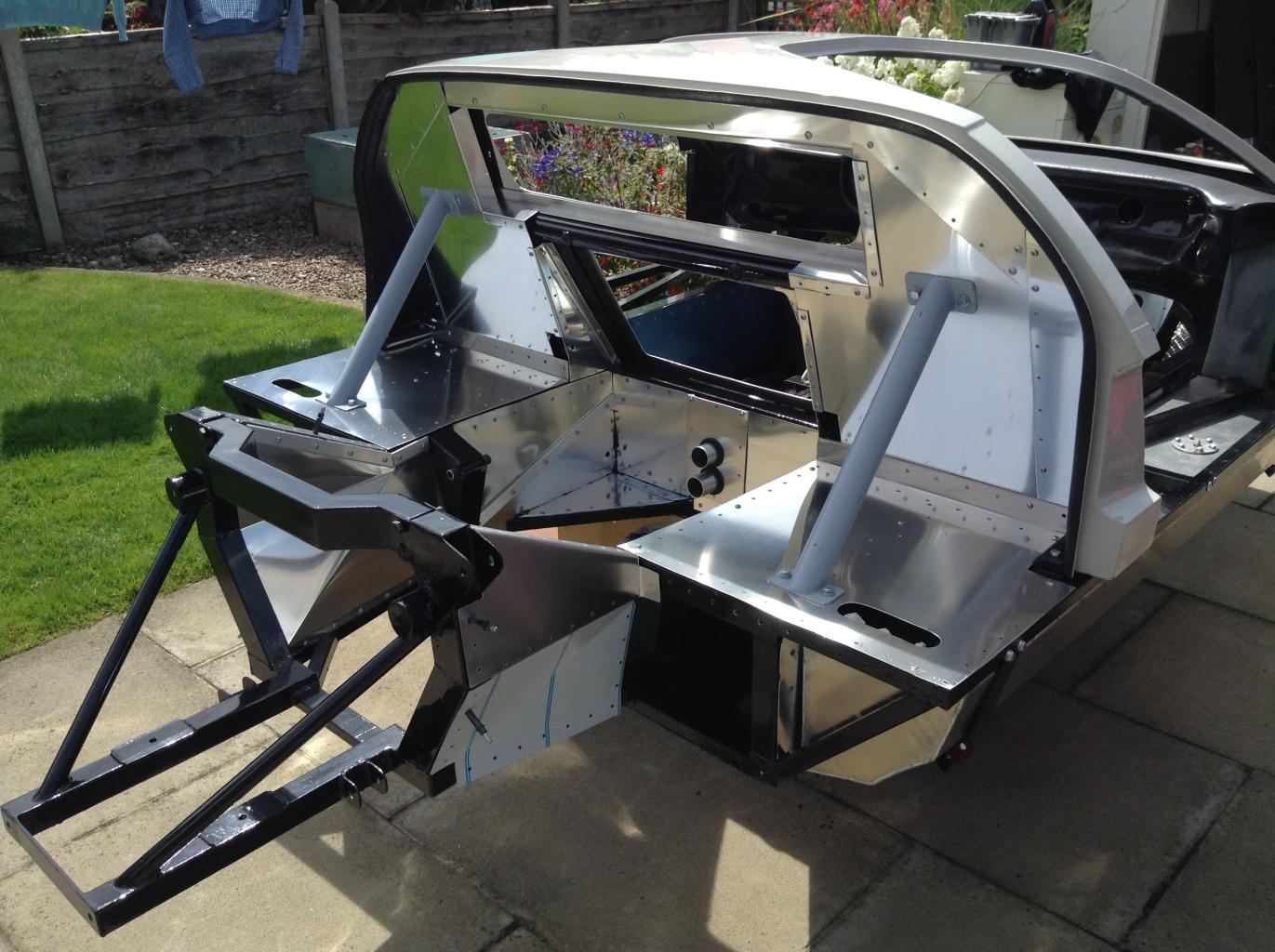

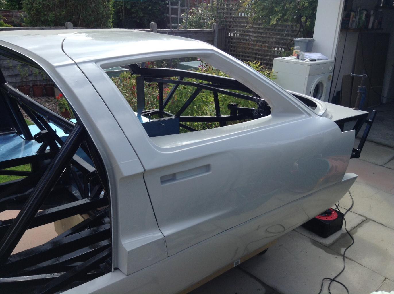

I wasn't keen on the small towers locating the top trailing arms on the chassis so I extended upwards and tied into the cross bar.
Southern GT do something similair and I think I have also seen an arrangement like this on GTD
