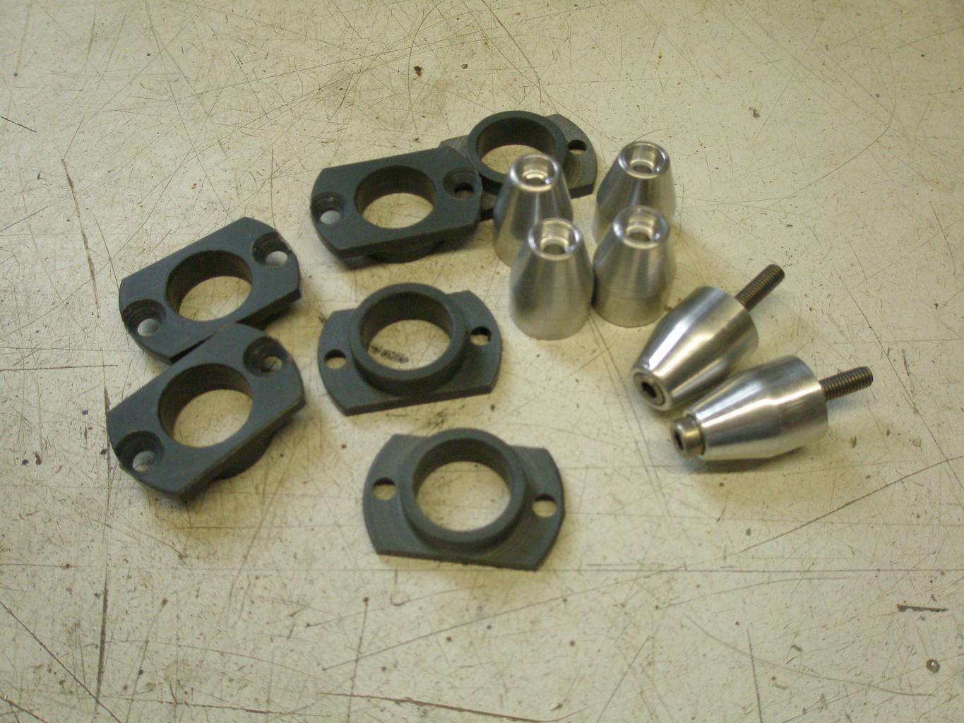

Hi Terry,
I made the attached parts from aluminium / nylon bar stock on my lathe, not a difficult job
Regards
Andy

I appreciate the suggestions and tips. As usual, you guys do well when I'm in a pinch.
I think I'm going to get Chris to send me his set-up. My only concern is that the threads on the screws he includes will be left handed :) :)
I've taken a look at the RX-8 and while the pins look like they could work quite nicely the receivers don't look ideal.
Plus they're no work of art and by the time you've got some receivers to work with them probably end up more expensive.

Got the pins in today, and they look great! too bad it may be next year before I actually put them on the bodywork.
Thanks Chris!
