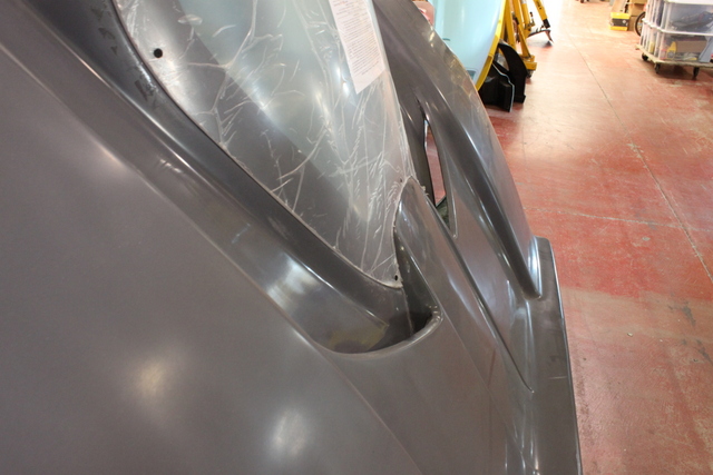

Gel-Coat thickness at parting lines
As part of the molding process, there are parting ridges on the body where the mold sections meet. I'D like to grind and buff the parting lines down to finish the body.
Is there enough thickness of Gel-coat on the body, so you don't grind down into the fiberglass?
Re: Gel-Coat thickness at parting lines
The gelcoat is sufficient to sand down at the parting seams. The seams are all gelcoat and can be successfully worked down and polished.
See Alex's build. He did a remarkable job!
In most places more than enough thickness. After sanding/polishing my whole body I found a few areas where the gelcoat was thin, but we're talking very rarely and in very small sizes (e.g., maybe 1/32'' in width). You'll have no problem sanding them down.
I don't know if I'd grind or use a buffer - less control - the ridge lines are very minimal and easy to hand sand.

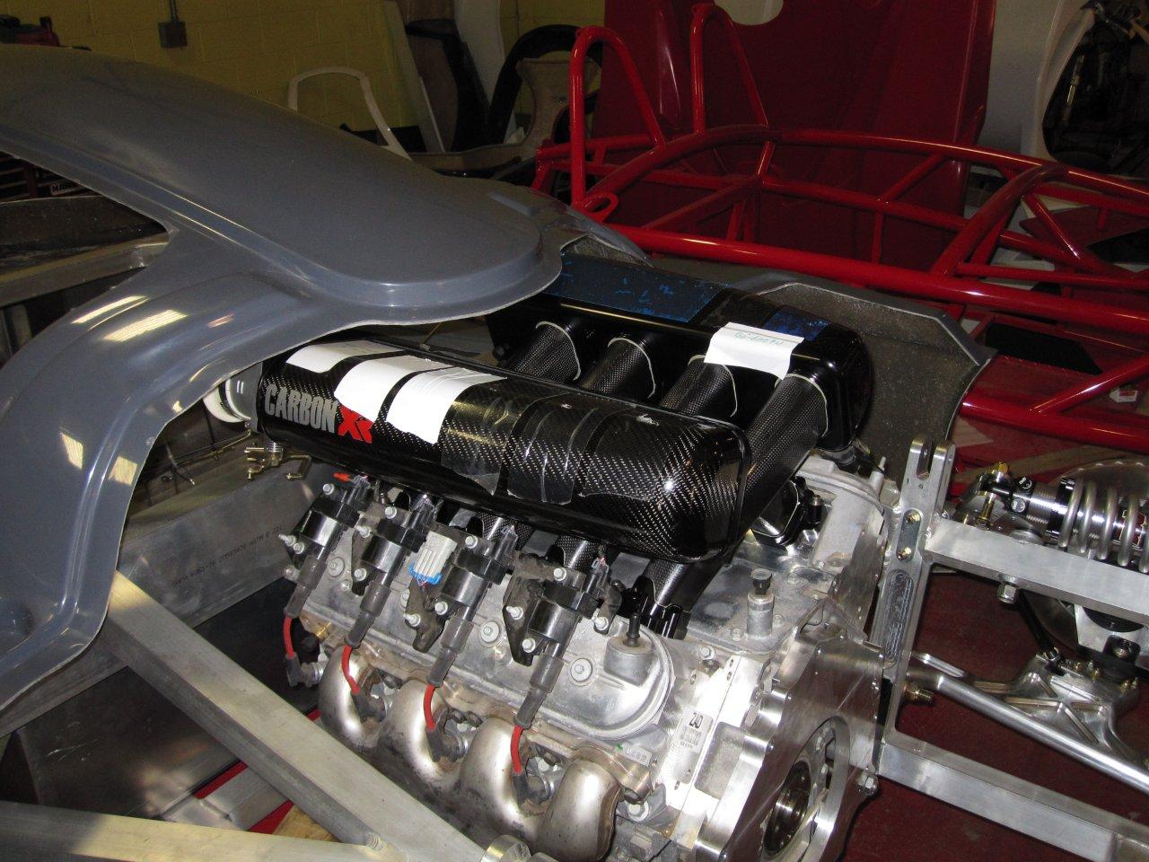

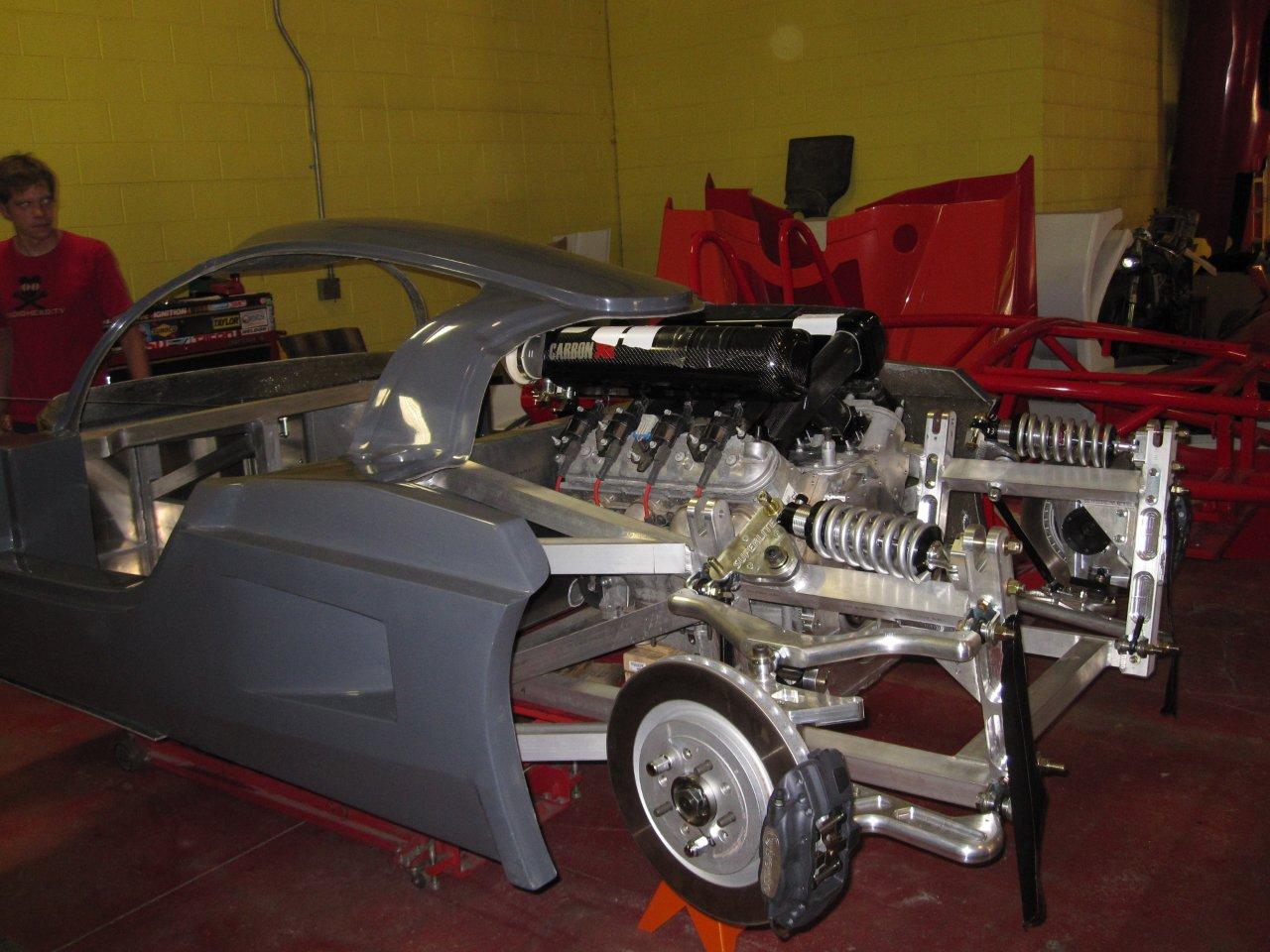

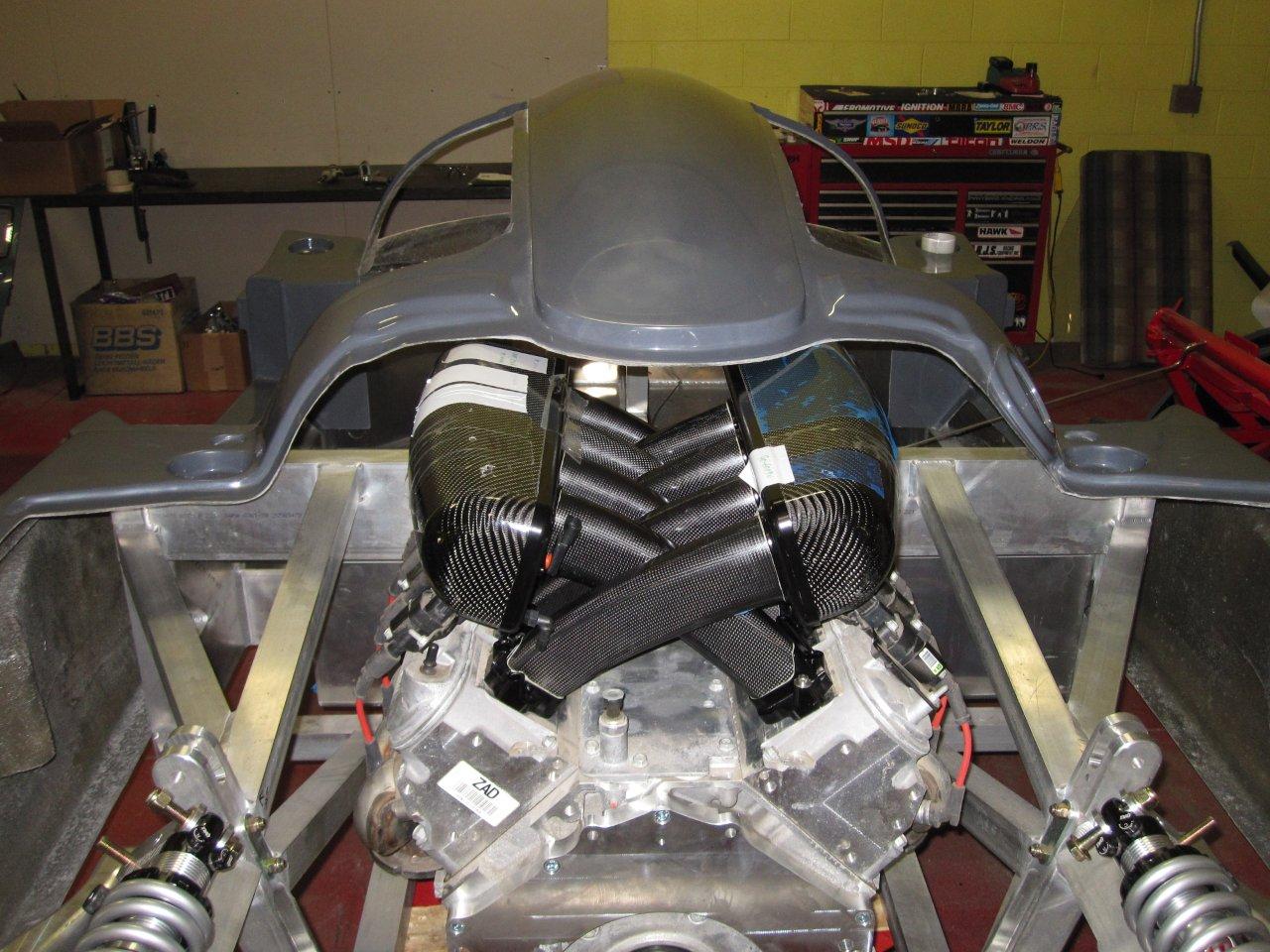

I'm interested in seeing pics of the primer gray. I'd love a dark/gunmetal type gray but the primer gray seems on the lighter side.
Black would be my next option, but I'd like some contrast/accent pieces in the sl-c.
Is this what you are looking for?
Yes, thanks Ben. Do you happen to have anymore pics/angles?
A tad darker shade would be perfect, but that shade looks great too.
I'll look, but remember that a photo isn't always a correct depiction of the color you see (not to mention differences in computer monitors).
I've found 3 more, but as you can see, there isn't exactly a consensus of color.

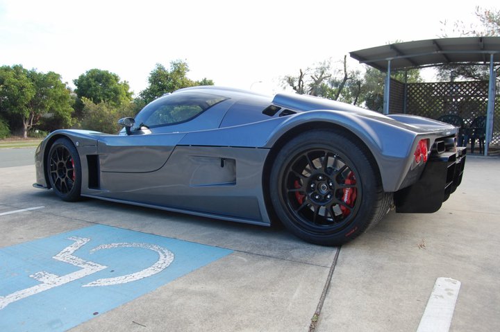

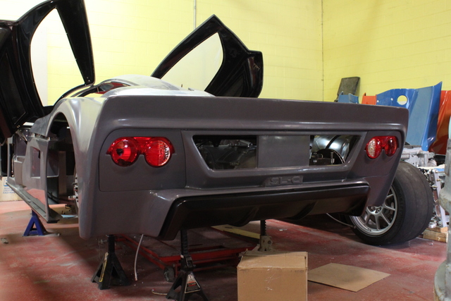

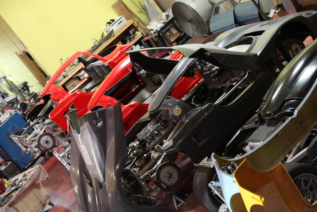

More:
attachment.php
attachment.php
attachment.php
Not sure if this last one is the gel-coat or not but the color is there more or less.
attachment.php
