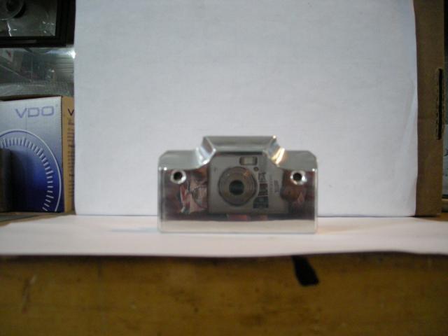

Hi,
Why don't you polish them they will look like chrome, and really look good next to black. Like this.
Bob
