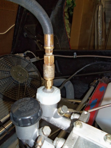

Here is a positive pressure sytem that is easy and cheap. I used an extra cap from a Wilwood or Girling master cylinder and a 3/16" barb x 1/4" MIP brass fitting from Lowes. I drilled a small whole thru the cap , inserted the barb and sealed it with JB Weld. Screw on an air fitting and it's done.
Attach your air hose with about 10 psi +/- and bleed away. Be sure to check fluid level frequently.
