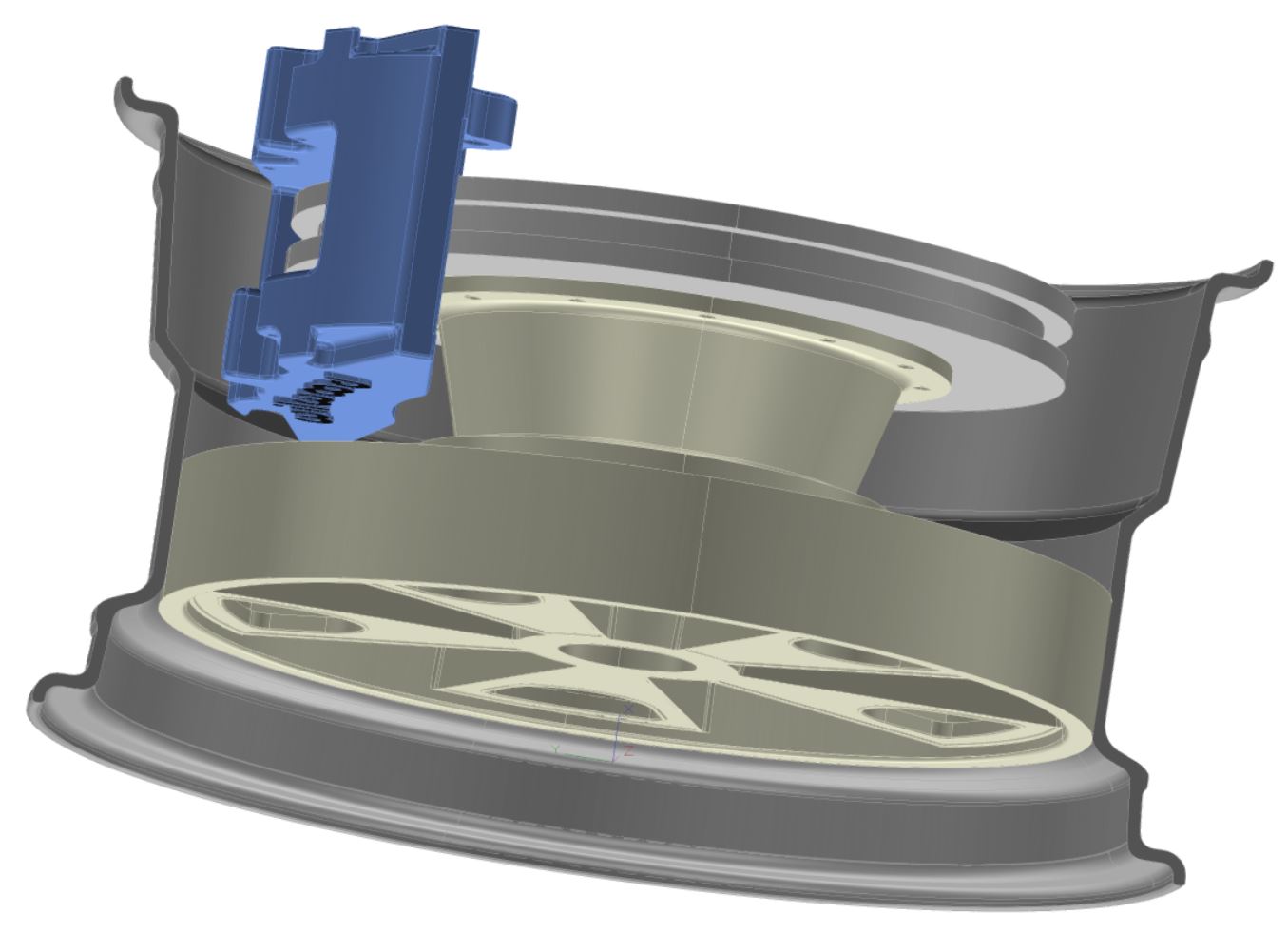

AP5040 max. rotor diameter 295mm
Wilwood - rotor diameter in this exampel 280 mm
Rim is VN427
Morten
Mortified GT

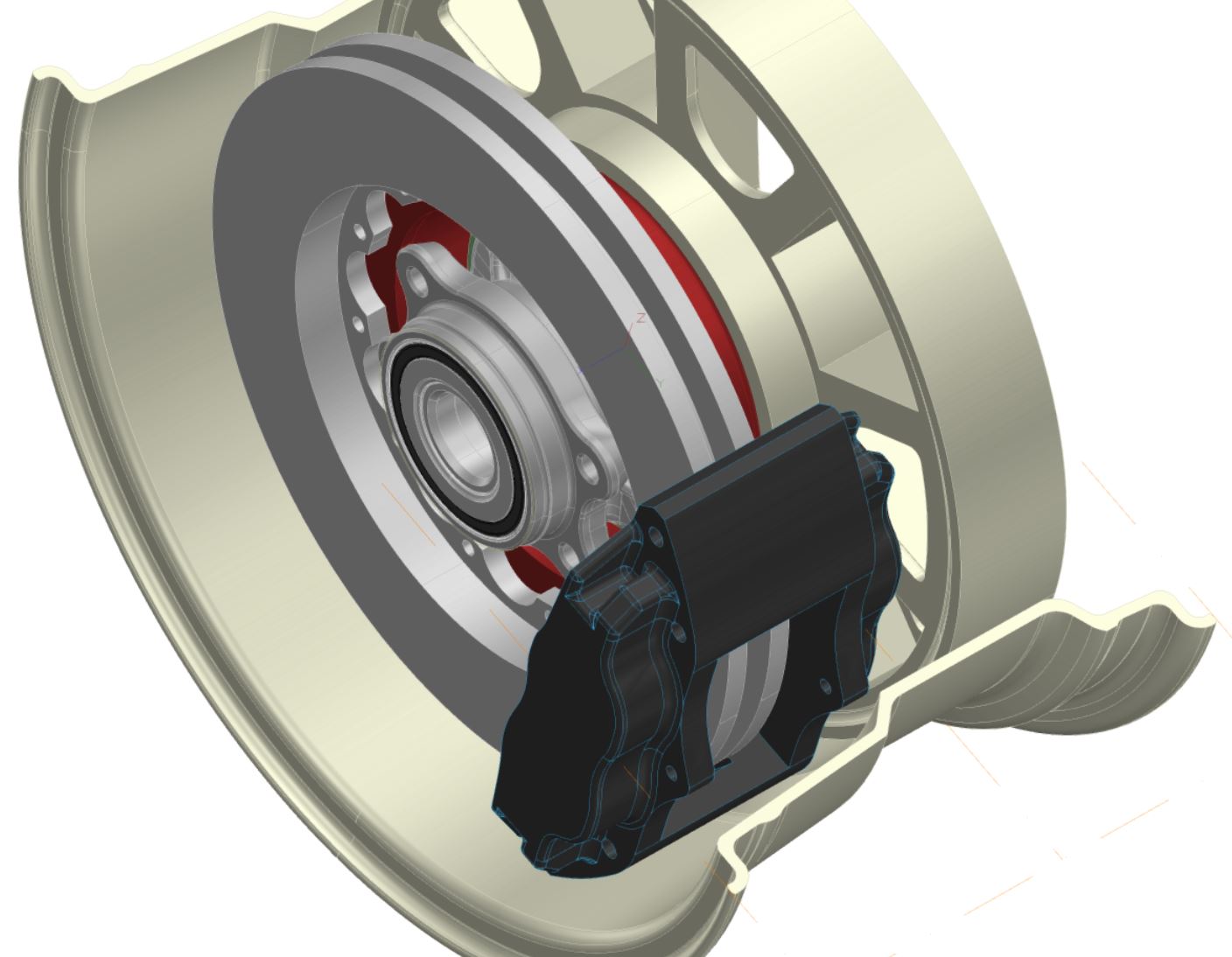

Hi, I have Wilwood 6 pot front, 4 pot rear on 295mm AP discs, 6 peg on SGT mk1, and AP pro5000+ 4 pot front &rear with a brembo handbrake caliper, AP 295mm discs 6 peg for my SGT mk2. Its 4-5mm clearance between caliper and inside rim for both setups I have.
Could possibly do 305mm with other offset on front rims, but no point reinventing the wheel and changing the steering geometry for minimal gain.

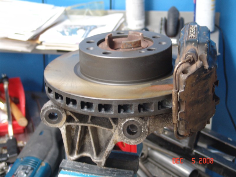

In the rear I used Porsche 928 S4 FRONT rotors & calipers. These fit into 15" Bassett racing wheels.
