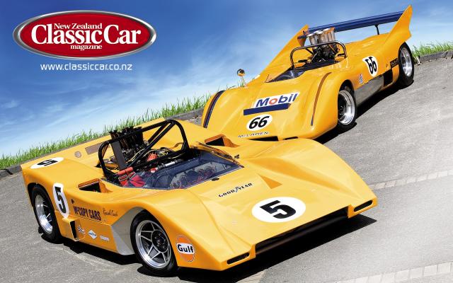

As I work up all the vital aspects of my Mclaren (oops McCopy) I have made a change to my brake cylinders. I have very good strong responsive brakes with a soft pedal. There is major work to change the ratio (6 to 1) and I was running 3/4 master cylinders and wanted 2 things ...less travel and more pedal feel / hardness/ pressure.
I changed to 7/8 cylinders and have not experianced any real change.
Any clues.
