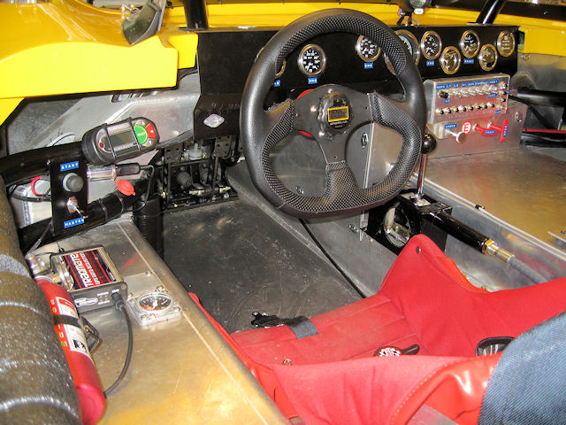

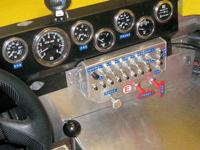

That roll cage mounted masterswitch linkage looks like it could cause a severe case of cranium leakage given the right/wrong circumstances.

And more Cow Bell on those thin battery cables :)
I think that one picture is a bit of an optical illusion. The switch is about 14" off the centerline of the seat. With the side window net/restraint down the middle of the car your head is just about going to need to come off to hit that thing. Still, we need to round down those edges there and protect the driver better. It is a bit close depending on the driver/height but I don't think it'll be a issue with the net and helmet in place.

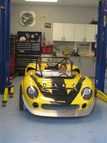

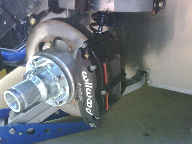

Well I got back from time away this weekend and started looking into getting things done on the car to make it ready to race. Finished up the belts, transponder, nut and bolting up front and having a look to see how we'll align it up.
I really do like it. RCR did we well and there isn't anything on it I would have done differently and lots of things I couldn't do at all. Everything works, fits, and does what it is supposed to, very nice. I've got to adjust the seat back for one of our drivers but that isn't a big deal. Tires should show up tomorrow, the race wheels are here already, and I got the Carbotechs on for the track day. Our local tech inspector is coming over tomorrow night to issue it a NASA and SCCA logbook and I'm hoping to complete an alignment tomorrow night. Here are a few pics from today.

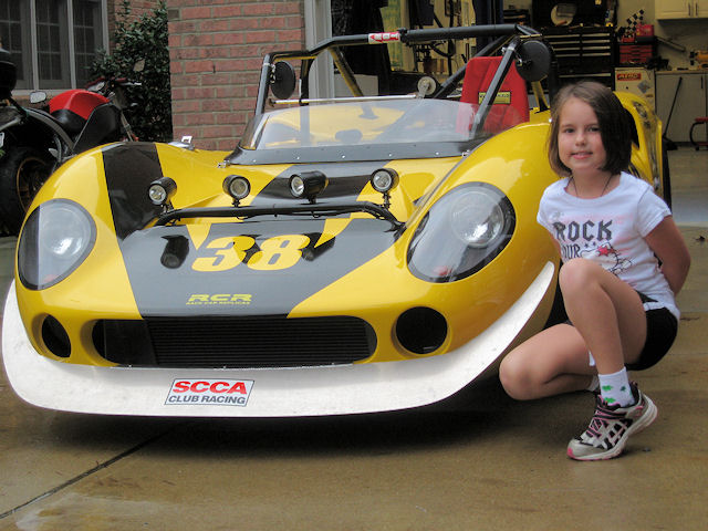

Alright, got a bit more progress. Our technical inspector was over last night and we now officially have a logbooked race car. Sounds sort of simple but a hell of a lot of work went into making that happen smoothly. The technical inspector loved the car and construction, himself being a Lola fan who watched the real deals race back in the day. No issues with respect to tech inspection so we are legal to compete in sanctioned races now.
We got the race tires and wheels in yesterday so we spent time aligning the front of the car. Pretty simple to do and we settled on about -1.7 neg camber, around 1/16" toe in, about 5.5 on the caster, with a ride height of right about 4". Car looks mean with the Aero wheels (blacked out with yellow pin stripe) and the Achilles Tendon Slicer a couple of inches off the ground.
We've got a track test day Thursday but it'll be tough to make. Weather is pointing to rain and we've got a lot of prep to do before she's ready to go out for the first time. If I didn't have this JOB thing I could get on with this important stuff.....lunch over, back to the job.....

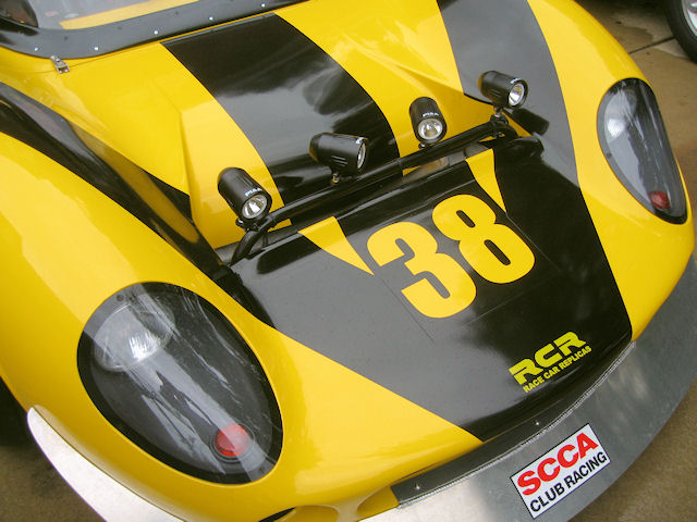

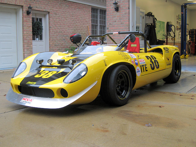

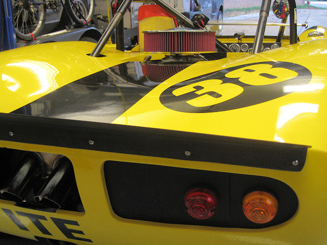

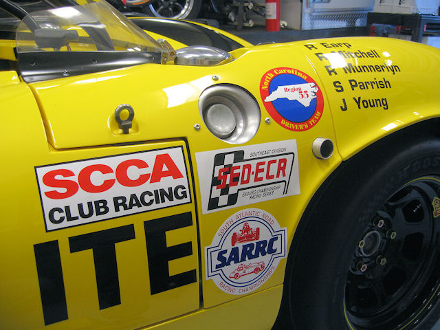

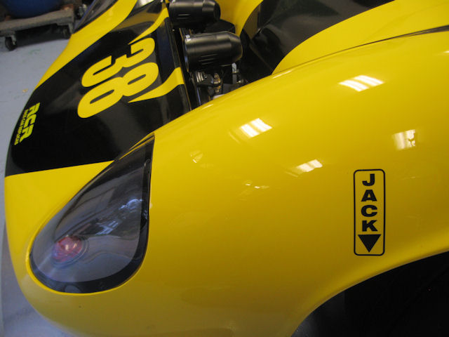

So, due to flu not much has happened on the car since last report. Fran Hall did an awesome job making some spacers for the Aero bolt on wheels I'd selected and got them down to me in record time. For you RCR knock on guys who need some good looking, strong, and inexpensive bolt ons you might want to have a look at them. One of the test days I'd signed up for to run the Lola will not allow knock on wheels so for those doing track work standard wheels might be necessary.
Today Jeffrey Rousel, our pit and graphics man, came over and graphiced the car up. It looks fantastic, very nice. I was only able to go out and peek at it since Jeffrey didn't want to be exposed to the creeping death. I'll get some pictures up as soon as I can of the car back together with the wheels, graphics, and hopefully ready to race. I'll also put up Jeffrey's contact information as he does graphics to order and does a great job. It is one mean looking car!

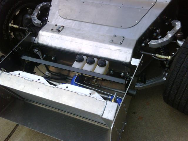

Just a small suggestion: you need a screen in front of your radiator.
