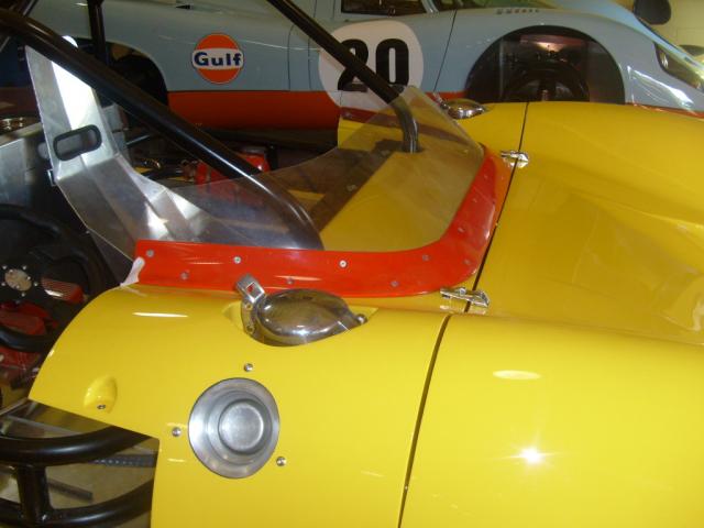

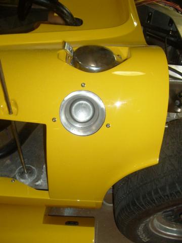

Thanks much, make sure you practice your squats and lift-carry before coming. Here is a shot of the installed NASCAR dry break fuel port. Those cans with 12 gallons of fuel will be heavy!

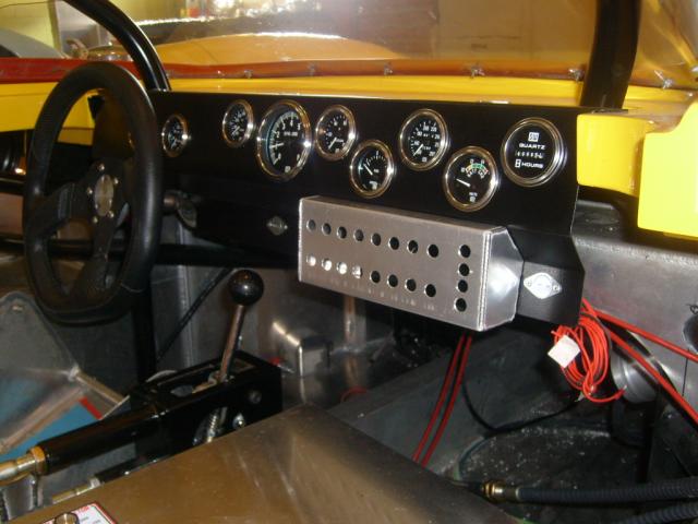

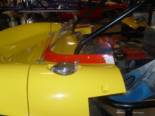

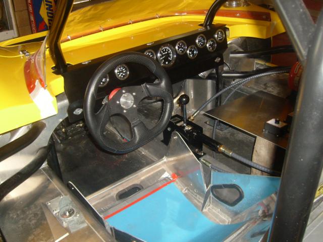

A lot more progress was made that might not show in the pictures. But, here are a few anyhow. The upper cage structure had to be modified to accommodate the various drivers that we've got lined up. A bit less ascetically pleasing but it looks ok. After all, doing a street legal car that is able to win a modern sanctioned race with proper class rules isn't easy.

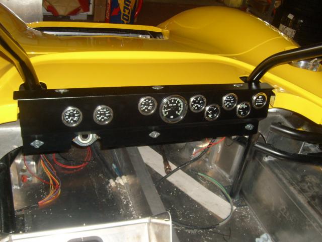

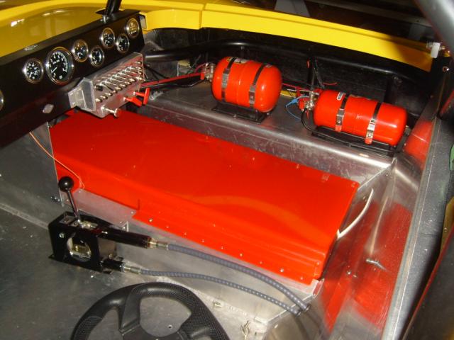

Two fire systems were installed and the gauge panel put into place with dzus fasteners for ease of access. The shocks were setup with double adjustable units and the finishing touches are being put on the fuel system, switch panel, and engine oil plumbing. I think it is coming together rather nicely and barring unforeseen problems we should make the test day toward the end of the month, with two more test weekends between that one and the 13 hour. October is going to be one busy month!

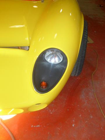

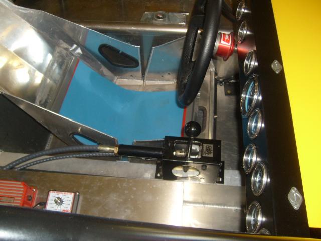

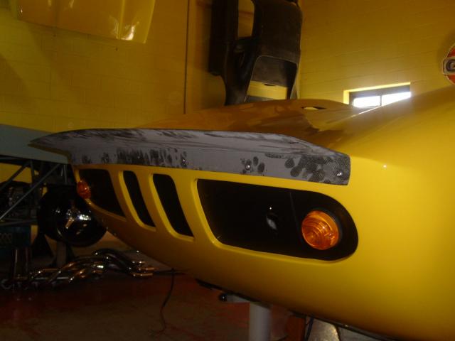

I got a few more pics that I missed because I turned in so early last night. More cockpit pics with mock up of the ignition location. Front lights, it is looking good in my opinion. With some black graphics to break up the yellow, this thing should look mighty sporty as my grandfather used to say.

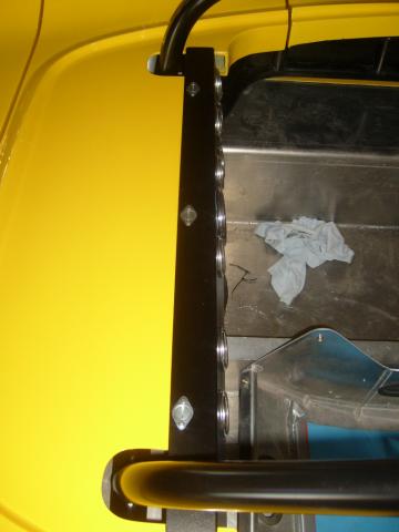

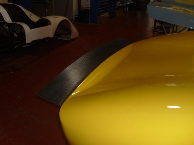

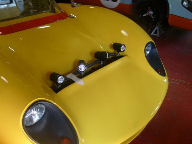

I have a few more pictures - rear spoiler, panel, and the removable light bar. The rules for the aux light state that the aux lights must be below the bottom plane of the windshield. Not easy to do on the Lola.
So, the fellows at RCR devised a light bar that plugs into female receptacles on the chassis. The bar will carry four HID PIAA lights on two circuits. All connectors and pins are captive in the area where the bar plugs in so on the twilight pit stop in goes the bar with lights. Jeff young donated the lights and if they are as bright as they are expensive then you'll see us from wherever you happen to be!

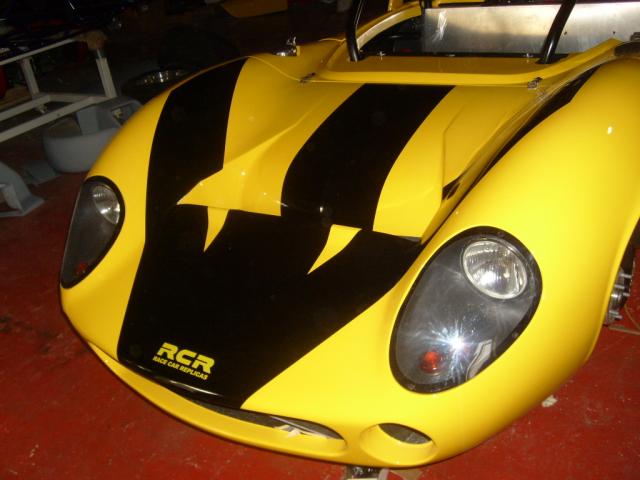

A couple more pictures as the Lola nears completion. The seat is out for install of the fuel cell and additional firewalls. The cell is a custom made job that holds 25 gallons and bolts into the passenger seating area (removable for street use). It has some fancy plumbing to get the NASCAR fuel dump into it and the dry break valves plumbed but all is finished up there.
Graphics are going on the car too! I like the look, has a nice black Lola arrow and we're planning all the other graphics in black trim too. The car has to run permanent numbers, all the sanctioning graphics, plus sponsor graphics, and electroluminescent panels. Mighty yellow. As Jeff said, Float like a butterfly and sting like a bee....I like it!!!

Graphics are going on the car too! I like the look, has a nice black Lola arrow!
Crikey Ron you HAVE been busy...;)
Regarding the arrow graphic, sorry to be pedantic but I think you mean the Team Surtees Arrow graphic, yes?
