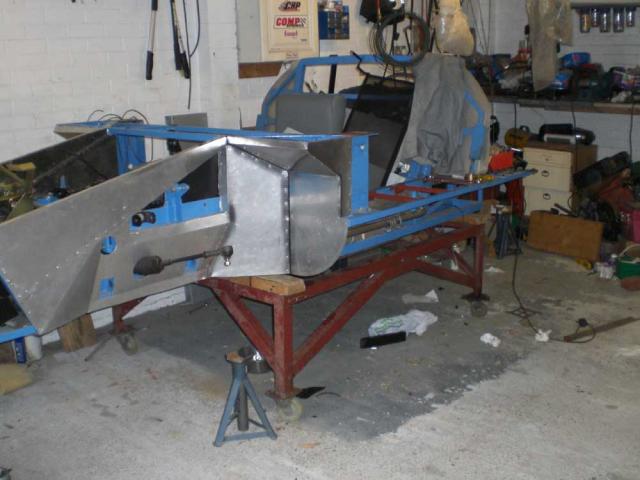

I built this table when I first started my build. It has castors on the corners but I fitted the larger wheels when I needed to move it about outside. It is made of 2" angle and will take the weight of the chassis with engine and transmission. Once the wheels were on the car then went on the floor.

I am now the custodian of Brian's build table, many thanks Brian and Chris.
I will make the table available for another GT40 builder when I have finished with it (however that may not be for another decade at the rate I'm progressing!)
Simon

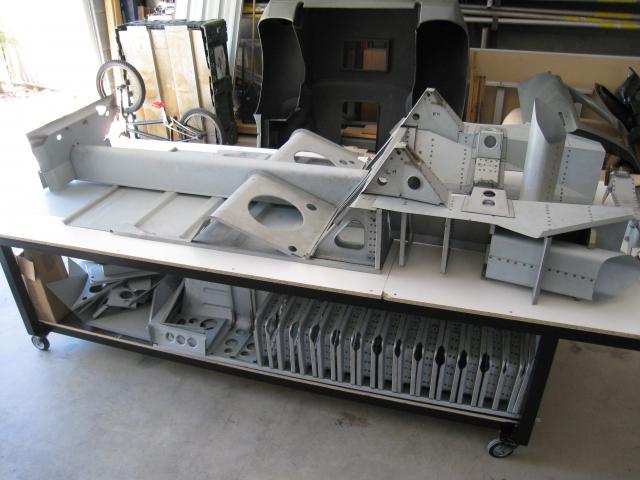

A bit late now Simon but just my version of the build table, I also included full size shelf so everything is together. Wheels are 125kg ea rating but in hindsight will need to be up-sized

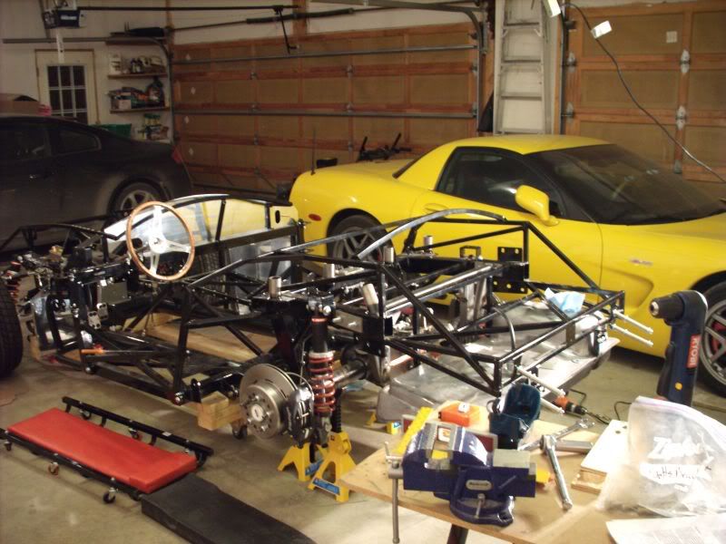

That's what I did on my cobra and will re-use on my rcr - bunch of 2x4s and 4x4s nailed together with locking casters. Great for rolling around the frame and hasn't failed me yet.
(you can kind of see them under the frame in this really old pic)

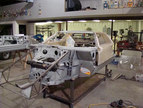

Heres the build table we built in our shop. Its 2 x 2 tubing. 2" angle and a shelf on bottm to hold parts and is on 5" casters. This can be built for $300 and last a lifetime.
