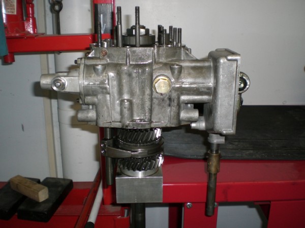

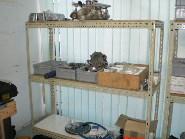

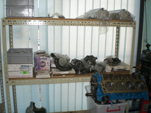

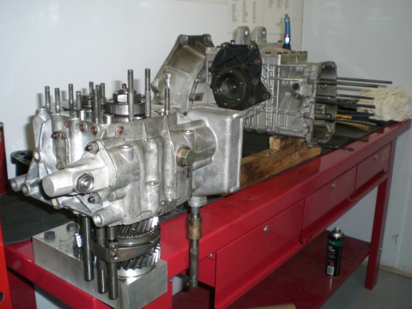

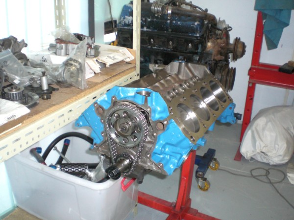

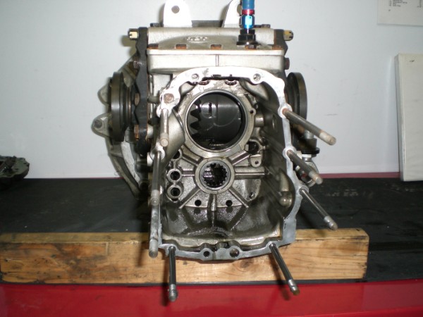

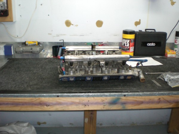

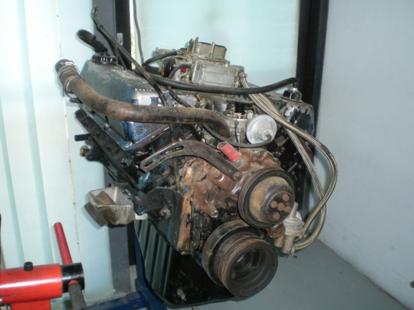

Here are a few photos of my engine room, ZF stripped for 2nd gear synchro replacement. 351 Cleveland from Pantera on stand and 302 short block I have recently rebuilt (basically stock but with nice light Mahle pistons). Plenty of work to do.

Hi Ross, do the pistons touch on the way past each other???
I guess you don't have to relieve the bottom of the bores to clear the big end bolts..... That is big displacement for a 302 block!!
Best of luck. :thumbsup::thumbsup:
Regards, Gus.

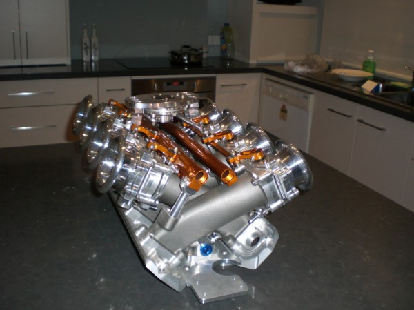

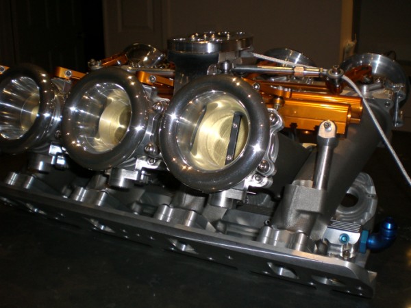

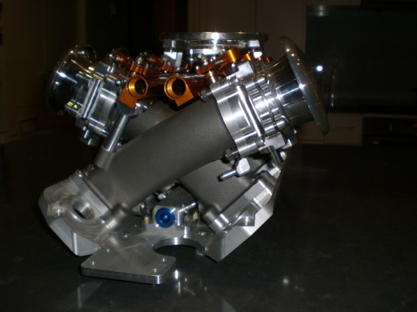

It's taken me 5 years to get my hands on one of these. It's a Morrison manifold and it is a beautiful thing. These photos don't do it justice. We went to see Steve Morrison today (one of natures gentlemen) to buy parts but came away with a complete unit. I am very happy.

Hi Ross
Very cool manifold, looks very much the same as the one I'm runing only mine was second hand and yours is still shinny. I love that it takes pride of place on the kitchen bench.
P.S Dont worry about your rod ratio. you will be fine! You will never notice it from the drivers seat.
