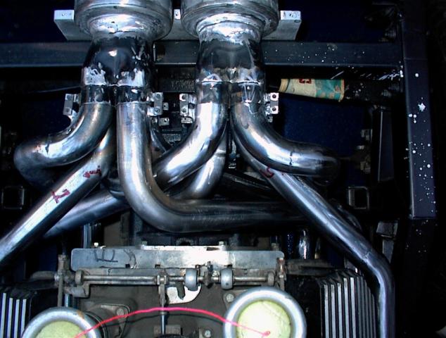

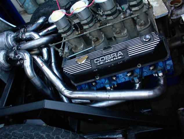

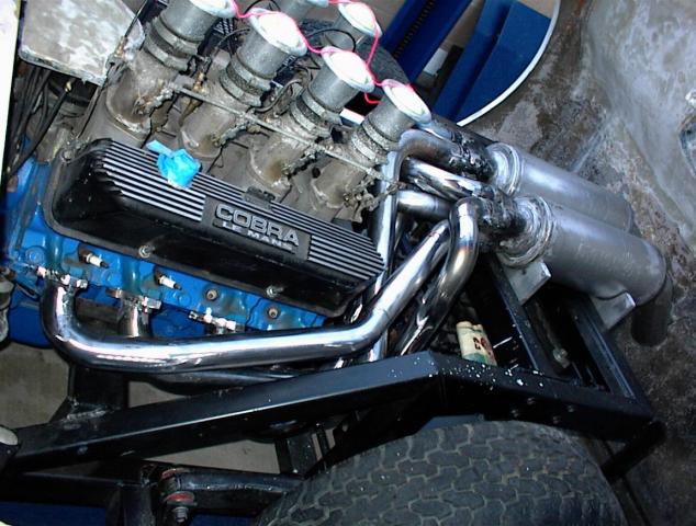

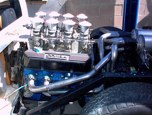

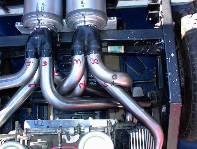

Here are some Pix of my headers during making them.
