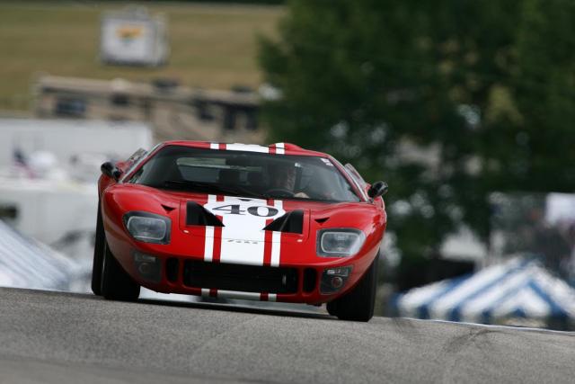

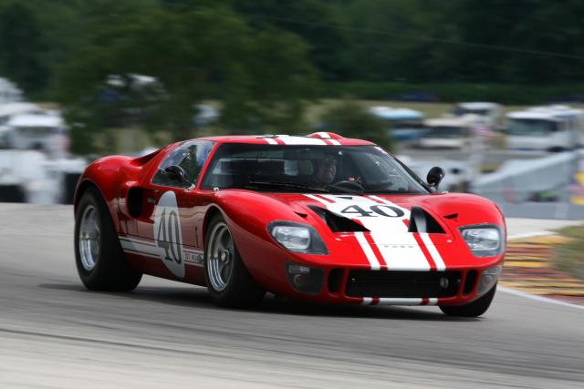

I bought two sets of them, one from Pegasus racing and the other off ebay, they both showed up at the same time, the ebay mirrors where less than half the price and better quality, so I sent the others back to Pegasus.
I hope you can see in this picture the wedges I had to make to push the mirror out far enough to be useful.

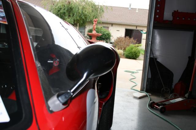

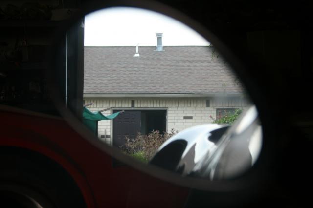

You will be able to see over the top of the fenders but will have a big blind spot with the flares you have to the right and left. Here are some pictures I took from inside the car. The picture of the mop bucket with a funnel on top of the mop is 20 feet in the back of my car on the right hand side, the other is of the left hand side our drivers side. This should give you and idea of view.

Thanks for the pics. I don't mean to offend, but do they have to be mounted in such a way that they look so angled, or is that the best view of behind? Is the housing and mount adjustable for angle beyond just being adjustable at the base?

No offense taken, no they don't but if you want the best view possible you will have to mount the same. If you look at #1083 mirrors, you will see that they cut and modified the base of the mirror to make it fit, I just made the wedge offset.

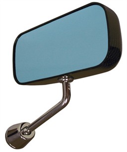

I am worried the CV mirrors will not see past my Gulf hips.
I am looking at F1 type mirrors but can't find any with flat glass(required for rego in Oz). Any body converted this type of mirror to flat glass or know where you can get them?

I don't think flat glass is mandatory, as our standard diesel Golf has noticeably convex mirrors on both sides. I'm just thinking that you get a much better field of view from the GT40 external mirrors if they have slightly wide-angle glass.

I agree with you totally........but
According to the NCOP L01-3 Engineers check list page 6
ADR14/00
Reflective surface of RHS mirror flat? May be convex if E marked with Approval number.
Easier to fit a flat mirror driverside then no E marking or approval numbers needed.
What Manufacturers get away with and what we can do is 2 different stories.
