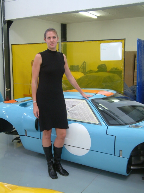

Hi all GT40 lovers.Attached please find the pics proving that tall drivers will fit the new CAV GT.With a 4" ground clearance, the overall height is still 40".( see the next posting for second photo )
Re: Can one get a 6\' 3\" in a GT40? ....I believe so !
Second photo....

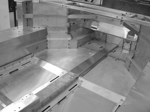

Hi Partick
We had to do two things: we lowered the seat area/floorpan with an inch and then also redesigned the seats to find another inch.The rails were removed and a sliding mechanism designed wereby we could avoid the seat being raised due to the rails. Attached photo shows the floorpan. As Roy Sales commented:" 6'5" no problem "......

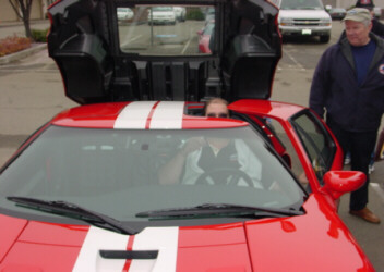

I notice the picture is a of a tall girl sitting in the passenger seat.
Obviously it's more difficult on the drivers side with pedals to contend with. Can the CAV accomodate tall drivers?
I know that the new Southern GT can as I sat in it during it's development.
