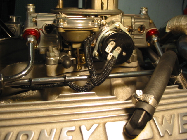

Here is pic of the spacer with an air gap.
Works great. No issues at all. Levels the carb with the engine and rear clip on the GT.
Go for it. Easy solution.
chuck
