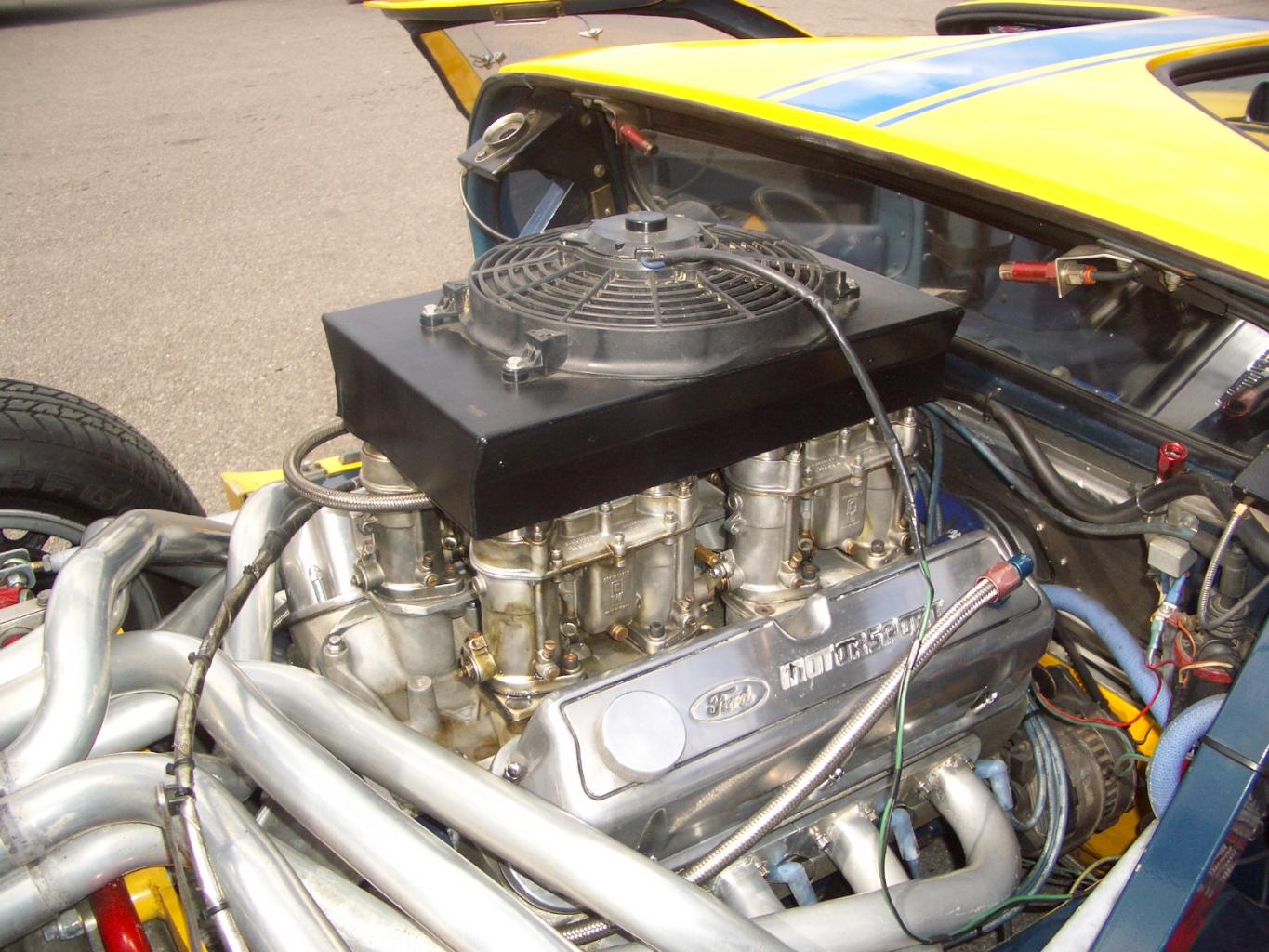

I know this shows it on webers, but we use a fan box on top of the carbs fitted immediately after coming off track to draw excess heat away from the carbs, only needs to run a few minutes to prevent fuel vapourisation, works well.

no i don´t, i have thought about it, but i rather try a simple mechanical shielding approach first, would like to keep the engine compartment as clean and lean as possible.
Frank
good idea for track use, but unfortunately not very practical in daily situations. Any specific reason why you are not using a turkey pan to shield the carbs a bit ?
