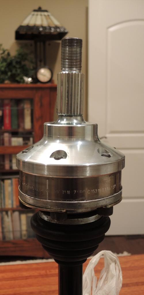

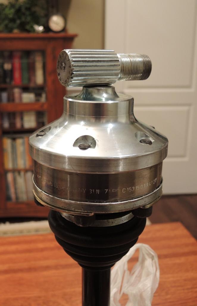

I'm looking for some help in identifying the manufacturer and P/N for a replacement stub shaft which I managed to cleanly twist off during some spirited driving (the half shaft, inner and outer CV joints all appear to be in fine shape so I'm hoping to just replace the splined stub shaft and wheel bearing).
The transaxle is an Audi 01E and the stub shaft is a 26-spline ala Audi 5000. The outer CV joint has "GKN 15 GERMANY 31N07LBO C153150184027" stamped in it. I've looked searched the posting on this site, have been Googling for days and pored over the GKN catalogs available online but I can't find a match.
I would greatly appreciate any advice or guidance anyone would care to offer.

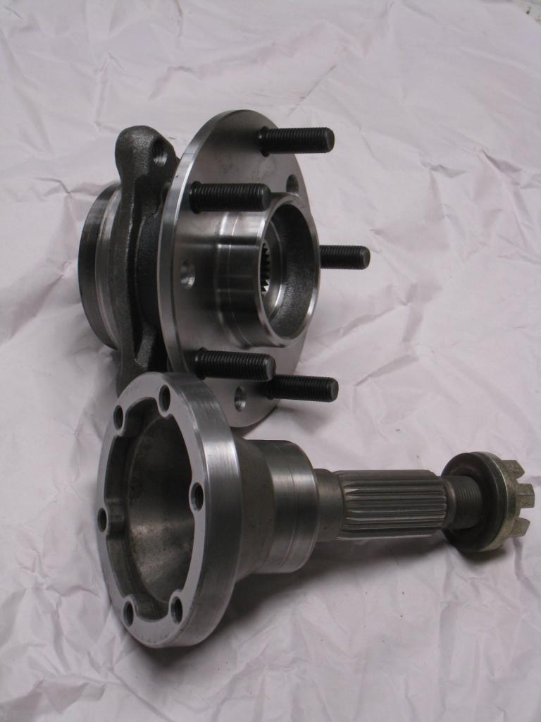

I dont know what the CAV spines are but Tom is correct...we use a standard USA C4 Vette spline .
We make our own stub axles from 4140 and we roll form the splines instead of broaching for added strength,
We then heat treat them and we now CAD plate them too.
flatchat(Chris)
The C4 corvette hubs are popular here too
The spline is ~1" OD and 27 teeth --the thread is 15/16" UNF
Jack -- looks like some other issue has caused it to break --like the nut, being either too tight or too loose

Jack, I'm being an idiot I think here, but are you talking about the output shaft (stub axle) of your audi transaxle? Or, do you mean there's a separate stub axle attached to the outboard end of your CV axle which has failed?
On my CAV (pre-100 with 016) the outboard CV has a splined axle (to engage the drive for the rear wheels....) but it is one-piece cast as part of the outboard half of the outboard CV itself. In other words, it's not a separate stub axle bolted to the outboard CV, it's part of the outboard CV itself.
If, instead, you're referring to the output shaft (stub axle) for the transaxle itself, I have some of those laying around and can send one along to you. Shoot me a pm with your address.

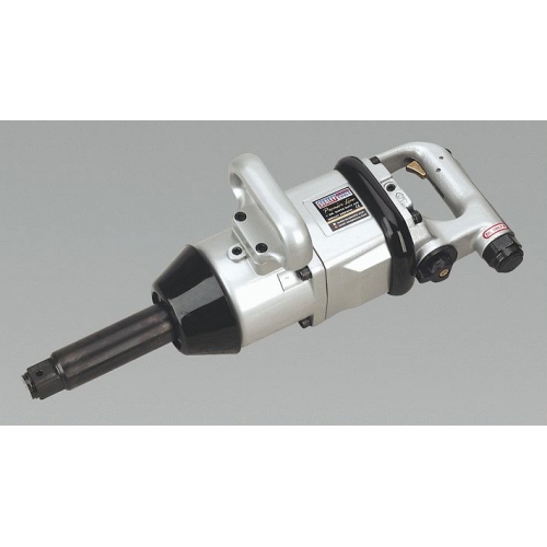

Those outboard axle nuts go to something impressive like 400-500 ft/lbs....here's what I have to use to get them on/off my car
400 - 500 ft/lbs Whaaat! ? 118 ft/lbs is all thats needed for the wheel drive stub nut
Hhhmmm...maybe you're right...? I know somebody in the know about CAVs (Jean or John in SA??) indicated that was the right torque setting for this particular nut.
Perhaps Johann would know? He's a pretty smart guy.
