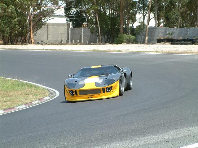

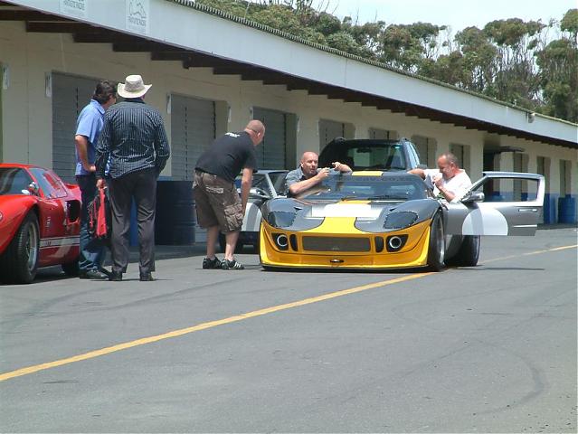

I have been 'begged' to post some photos of the latest GTR testing. Well, here they are...
further testing next week, as well as report.
Regards to all.
jean

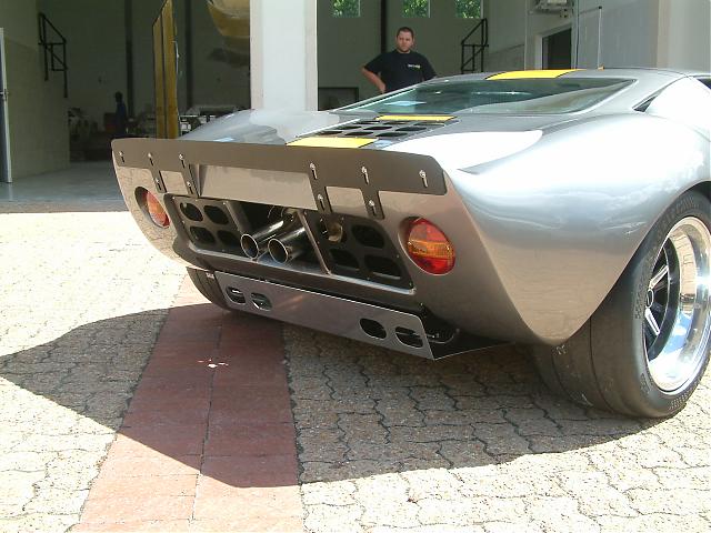

Do you have any aero work on the back half of the car? I thought with a chin spoiler like this you could put a 0.5 to 1 inch lip where the sills screw to the chassis under the car to prevent air sucking in from the sides. Then with a venturi at the rear you should have quite a good downforce set up? Unless this would be in breach of regs?
Hi..
We are at present getting aprox 120-140kg downforce on the nose. The rear is fitted with a Gurney-tab as well as plate below the length of the engine and gearbox.
Working well!

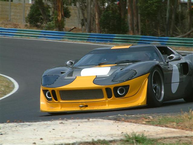

What Transaxle and Engine in the company car?
What is ground clearence at the front????
It looks awefully tight.

What kind of down-force do you think you are generating at the rear from the Gurney tab? The 2 inches I have on mine above the existing bodywork duck tale is quite effective. I have guessed, AND I really mean guessed, that it has to be worth at least about a 100-150 pounds at speeds above a 100mph or so. Do you think I am in the ballpark with this figure?
I also have front wing-lets (canards) on the front like the originals but they can't be doing much. My guess is less that 20-25 pounds @ +100mph.
I do like the front air-dam. How do you attach it to the bodywork? Will that be a part that will be for sale at some point in the future.

The front ground clearance is 2". The wear plate has shown minor signs of contact, but that is mostly under extreme braking and due to very rough track surfaces on our local circuit. Nothing to worry about. The nose is SO stable, its worth the effort.
Chat again soon.

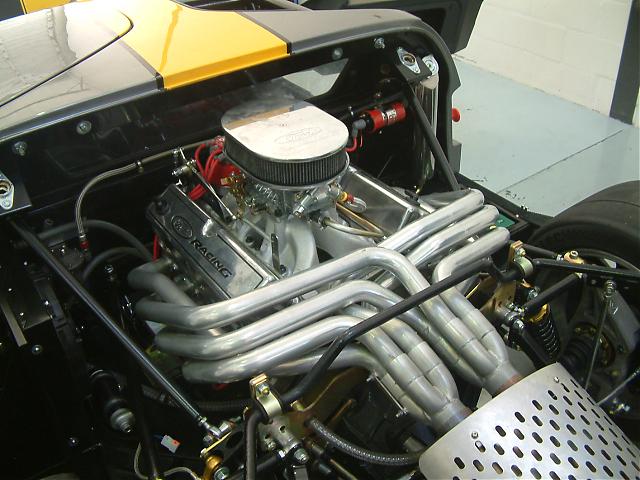

2) Any shots of the roll cage, including the supports into the engine bay? I am
always curious to see how the cages are developed and fit by manufacturers and
builders.

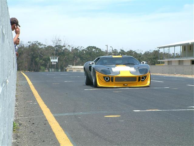

3) It looks like you have break ducting coming in from where the driving/signal lights
normally go. Was this because of greater airflow?

The wheels are 17". They are made locally and on this car I am using 10" at the front and 14" on the rear. They are available to CAV owners, but for now only in the Halibrand style.
I have attached a photo of the engine bay. You should be able to see the roll cage extentions onto rear crossmember.
The front airducts are for the front brakes. Photo attached.

It's difficult to see on the front upright photo, but the 45' bend actually enters the upright, forcing the air INTO the centre of brake disc. The disc is designed to 'throw' the warm air out, and suck cold air in from the inside.
