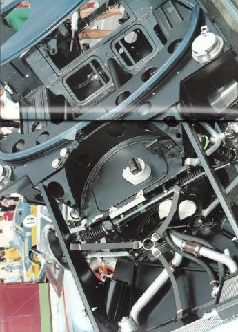

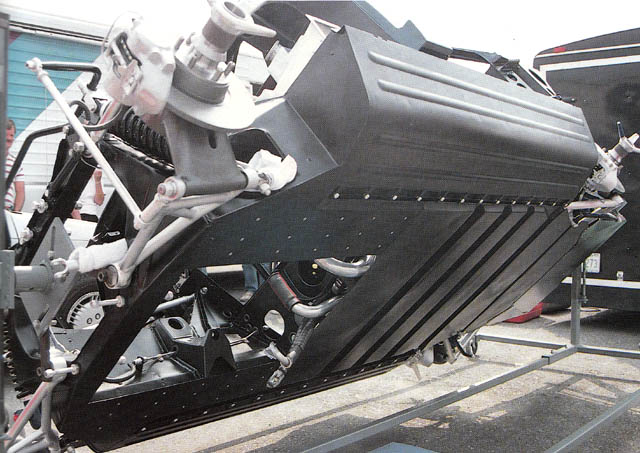

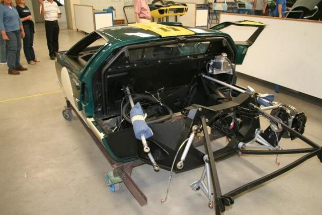

The SPF chassis is complicated and stiff!
Jim Rosenthal
Those photos look a lot like the assembly photos of 1149s tub. The blue paint is interesting; original GT40 tubs were painted that color-Ford blue, I suppose. However, the rear metalwork and sway bar do look different.
Rick Muck- Mark IV
GT40s Sponsor
Jim,
The rear framework IS different as that is a MK II tub. And yes, all of the early cars were blue painted. Superformance offers painted chassis as an option. I really like the blue myself.
Great pictures, Rick. Thanks for posting them.

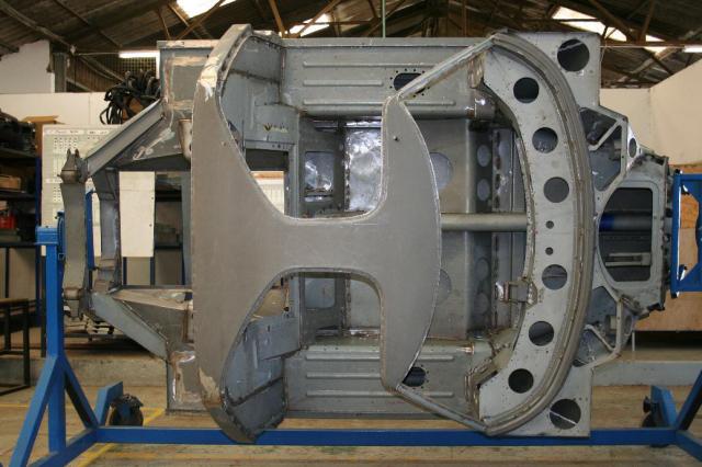

For comparison purposes, here are some chassis pics of 1033 (on a trailer before it was restored), 1036 (on a stand), and an ERA chassis (speaks for itself).

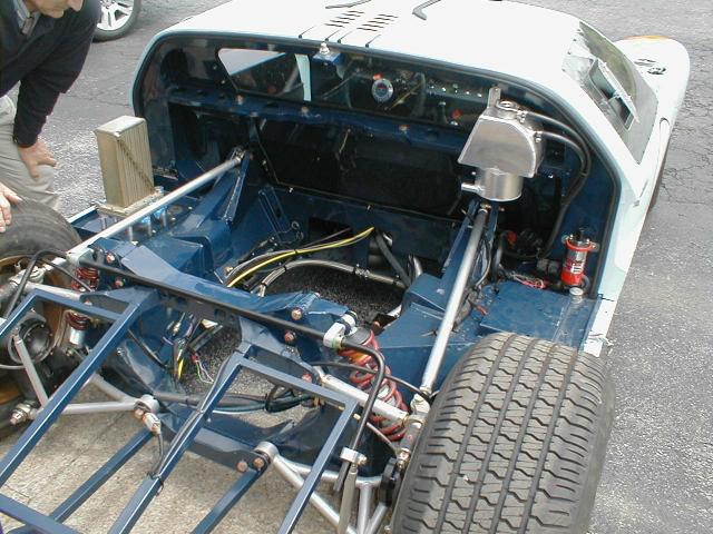

More tub pictures....

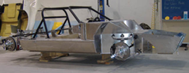

Getting back to rigidity, it's interesting to note the stiffening ribs along the sills in both the original and SPF chassis. They have to add a lot to the torsional rigidity of the structure. With the SPF, including them is a nice detail that stays true to the original and surely must add to the expense of construction.
The ERA chassis doesn't have the stiffening ribs nor do CAV and RCR.
(The pictures below are taken from the CAV and RCR websites. The first two pics are CAV's chassis, the third RCR's.)

The RCR car is done out of heavy gauge aluminum and the ribs wouldn't really add much. I believe the CAV car is also heavier stainless and again would not get much added stiffness.
The sheet steel used on the SPF and FAV cars needs the ribs for stiffness and to prevent "oil canning" on larger flat surfaces. Note the SPF and FAV tub also have ribs on the top of the sponson sills.
Of course the welding systems used differ between the RCR alloy, the CAV stainless and the mostly resistance welded SPF GT40 tub. There are some MIG/TIG type welds on the SPF/FAV tubs, but there are a buttload of spot welds.

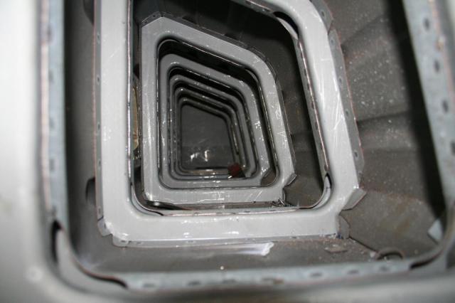

Jim Craik
This is a very interesting discussion.
I would love to know just how different the Abbey and the SPF tubs are.
During the months I was waiting for the (very slow boat) to deliver P-2264, I spent a lot of time going over books and photos of both tubs. They certainly look the same to me.
Seymour Snerd
I was just doing some work on my rear-hoop cross member and in peering into the hoop ears noticed a bunch more spot welds I hadn't seen. So I think it's at least 1.1 buttloads.
