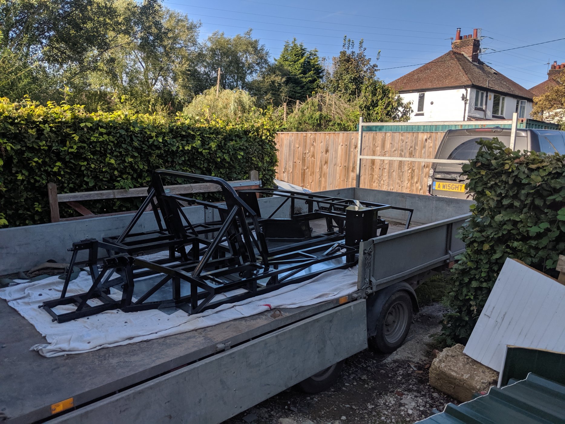

I have been a bit slow to post but picked my chassis and panels up from southern GT about a month ago and since then have been none stop with work but I have finally got my garage wired up with power and air compressor ect so ready to start my build!!
I have a bit of a question for some of the people who have done black panels I was thinking of spraying them instead of powder coating i have tested out spraying nitro on a spare piece of metal I have and love the Finnish but wondering if it will be a strong enough to take the punishment especially in the wheel well areas and floorpan.

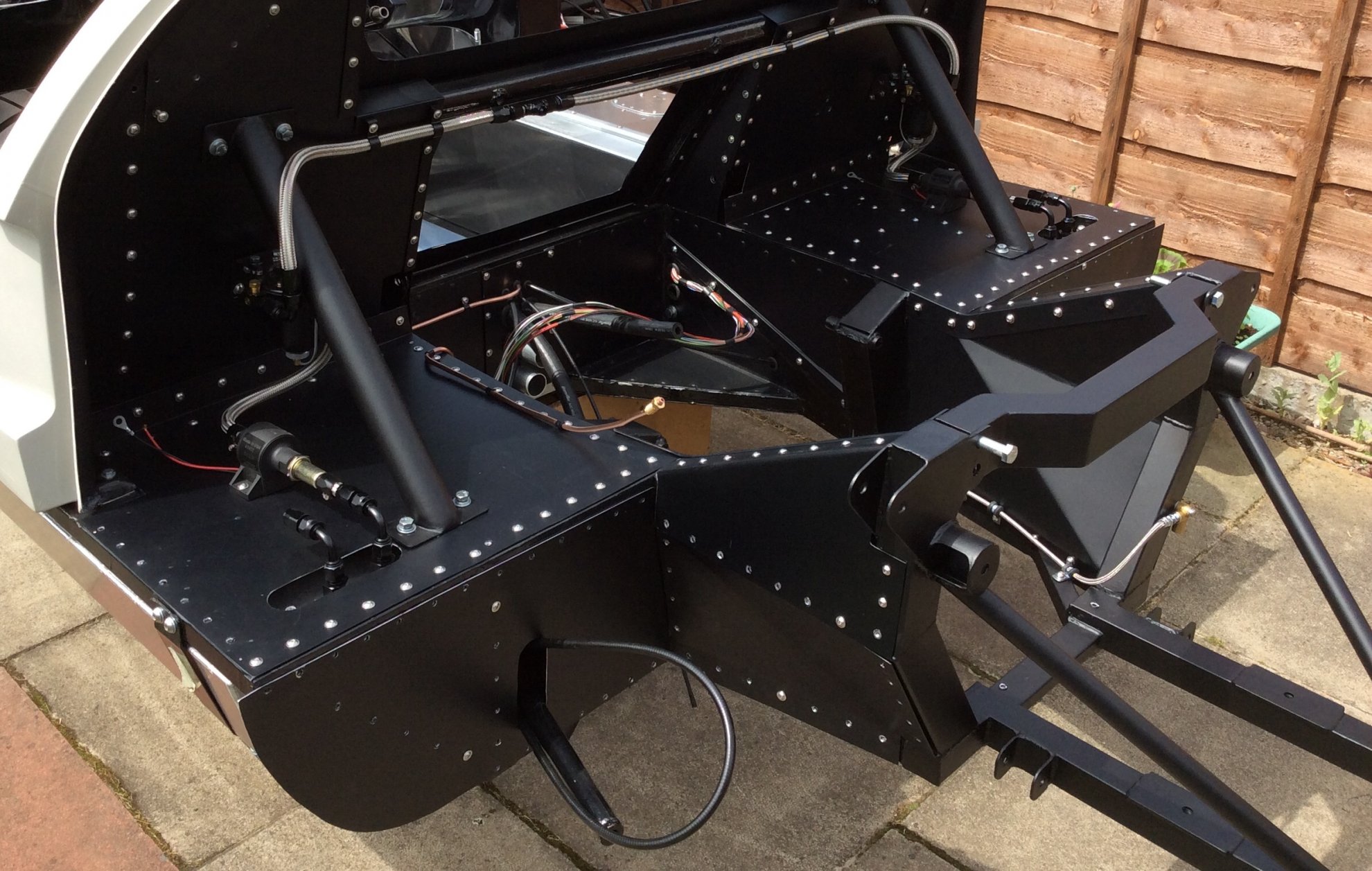

Great choice with the Southern GT. I’m in the cheaper seats with a gtforte.
I used Matt black vinyl wrap on the inner panels. Time will tell if I’m crazy or not!
My thinking is I can always rip it off and go back to bare aluminium.
That looks great somebody said about paint and then putting the pain protection film on to protect it didn't think about vinyl but sure it should hold up well and yeh the option is always there to remove it at a later date
