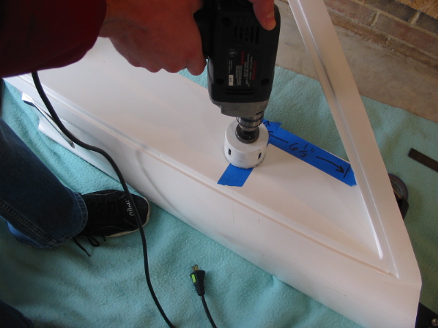

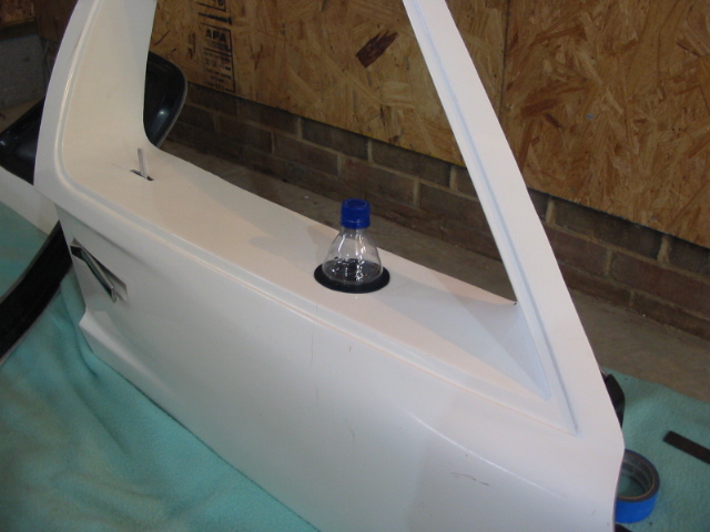

The RCR does not come with cup holders. In this day and age of multiple cup holders per passenger, this is a significant oversight, but one which can be easily remedied.
A flimsy cup holder hanging from the door or secured to the windshield with a suction cup is not acceptable. The holder needs to hold a hot cup of coffee securely when subjected to a G or more of cornering forces. Accordingly we turned to the marine environment, where the rocking and rolling of a sail boat traveling at 8 knots creates similar needs.

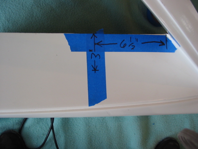

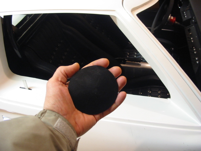

West Marine sells a cup holder insert, part # 395160 (black), $5.99 each, which is ideal for the GT. (www.WestMarine.com). It has a 3 ½” flange and a depth of 2 7/8”. Simply drill a hole on the door sill and drop it in. The hole should be slightly undersized to assure a tight fit in the event of a roll over. The inserts can be ordered in either black or white, so an appropriate color to coordinate with the cars décor should not be a problem.
One could add a second cup holder on each side for miscellaneous items. This handy receptacle is an ideal place to set that pesky cell phone when racing around the track or driving to the office.
We found that a 12 ounce bottle of water fits well. A Burger King “Cup of Joe” is a tight fit (as you can see in the picture), but a Starbuck’s “Tall” is easily accommodated.

I appreciate your concern about the hole, but don't worry. No damage was done. See pic attached.
