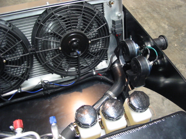

Radiator, Part II

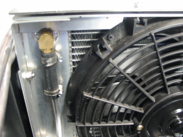

A vent line was added, connecting the cool / input side of the radiator to the connection on the top of the expansion tank. This permits any trapped air to vent from the radiator. Three eighths inch aluminum tubing was used to fabricate a long, straight line, equal in length to the long coolant tube extending through the center tunnel. This was run through the tunnel on top of the two coolant tubes. Two additional aluminum lines were fabricated to complete the connections at the front and the back.
Three eighths inch hose was used to complete the connections. Be sure to use heater hose, not fuel line hose. It is available at most car part stores. Fuel line hose does not hold up well to antifreeze.
The drain fitting on the top of the radiator on the side where the coolant enters the radiator was replaced with a right angle and straight fitting. Teflon tape was used so it could be positioned tightly where we wanted it.
I found very little information regarding this subject. Carroll Smith describes this technique in one of his books. Some suggest using a smaller line, perhaps a quarter inch. Based upon our initial experience running the engine, this set up seems to work appropriately and the three eighths inch tubing should, hopefully, not be an issue.

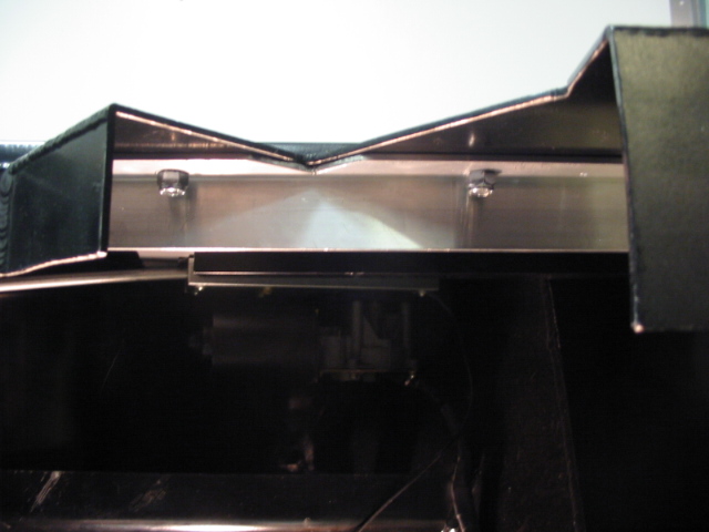

Six lines run through the tunnel: two 1 ½ coolant lines, a 3/8” coolant bleed line, two AC lines and the fire suppression line. All the lines, except the fire suppression tube, were placed inside an insulating sleeve from Cool It Thermo, Inc. It had to be a thin sleeve since there is little extra space with which to work.
Before placing the lines the brake fittings adjacent to the tunnel were secured, since doing so after the pipes are in place would be a challenge.
Various holes were also drilled for the shifter and center console before the tubes were placed.
The copper line for the fire suppression system will be fed through the tunnel later. Since it is a small diameter copper line, it should slide easily through the tunnel.
Now that the tubes are in place there will be NO MORE DRILLLING on the tunnel.

Steve: The other advantage of a separate bracket for the fans is one can easily remove the fans as a unit without removing the radiator, shoud servicing ever be needed.

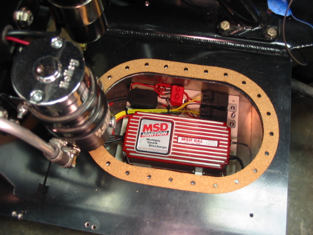

Rear Power Board

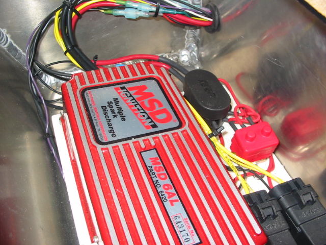

In an earlier post, we noted that an opening in the left rear tank was cut out and covered with an oval plate. This chamber was used for wiring components. The MSD ignition module, fuel pump relays and a central wiring point were mounted on a section of white half inch Star Board (marine lumbar) measuring 9 ½” x 8” inches. This rear power board was then mounted on half inch nylon spacers with 3/16” button head stainless bolts.
Star Board is a wonderful product. It is used like wood, but is chemical resistant and requires no finishing. It provides an insulated surface for mounting electrical components. The white finish makes components, particularly in a dark location, easier to see. (It is also available in black). It should not, however, be used in temperatures over 200 degrees, so it cannot be used in close proximity to the engine or exhaust system. West Marine is a good source.
A Jegs Terminal Block, 555-10521 provided a central wiring point. It was fed with an 8 gauge wire from the alternator post, which was then connected to the starter and battery through a 50 amp fuse provided with the wiring kit per the Painless directions. The 50 amp fuse was located as close as possible to the battery – starter junction. The Jegs terminal block was the common point for connecting fuel pump relay power sources (which are also fused closed to the relays), the dashboard power source, and any other electrical needs not running through the dashboard. Another 8 gauge wire runs from this terminal block to the front power board. This keeps the wiring simple and accessible. It also keeps the high current accessories separate from the dash wiring. This is likely over kill, but adds a safety factor for little additional cost.
Bulkheads
The fuel pump wires and ignition coil wires were fed through a grommet on the inside wall of the bulkhead. The fuel pump wires were connected with removable connectors. The fuel level sending units have screws securing the wires which are accessible through the access plate. The coil wires are also secured with screw terminals. All the wiring behind the bulkhead can be disconnected through the access panel. Thus the bulkheads can be removed without having to cut any wires, should that ever be necessary.

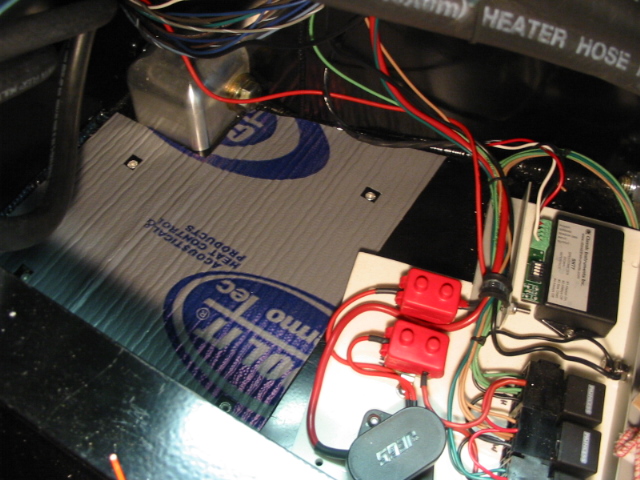

Forward Power Board

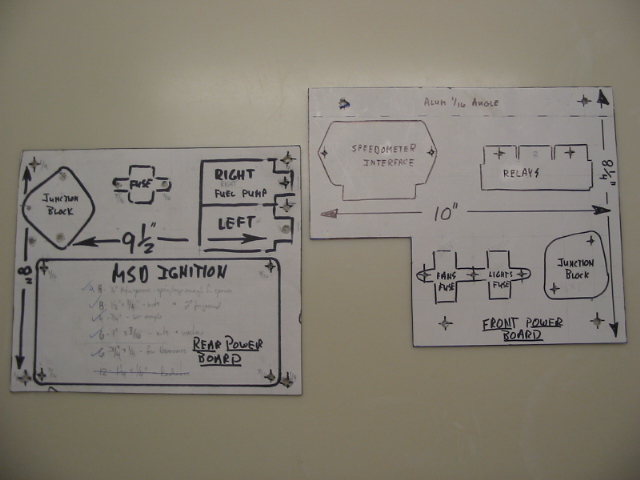

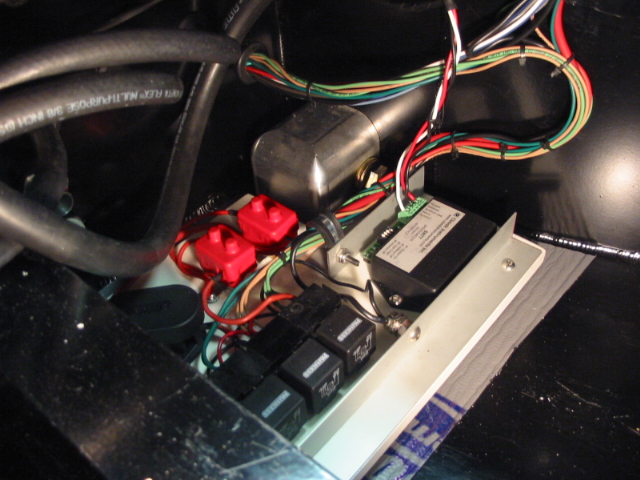

A section of Star Board measuring 10 x 8 ¼ inches, with a notch for the lower control arm housing, was used for mounting the speedometer transducer, high beam, low beam and driving light relays. It was mounted on the floor a couple of inches behind the right front firewall to provide adequate clearance for the fittings mounted on the firewall. It is easily accessed from above and the white panel makes for a clean and easily seen mounting surface. It was fed with an 8 gauge wire connected to the Jegs Terminal Block mounted on the rear power board by the MSD ignition.
The power lines to the fan and the lights are separately fused. A Jegs terminal block provides a convenient junction point. Be sure to use a jumper between the two different size studs on the Jegs terminal block, since they are not internally connected.
The one inch aluminum angle on the rear edge provided a convenient mounting location for another grounding bolt (which is separately grounded with a wire to a chassis ground, since we don’t want to rely on the mounting screws for a proper ground in this location). Another aluminum angle was mounted on the front edge by the speedometer interface. If there are any issues with electrical interference a cover can be easily fabricated and placed over the speedometer interface using these aluminum angles as supports. Hopefully that won’t be an issue.
The speedometer interface connections were kept separate from the main wire harness to minimize the risk of interference.
A means of securing this panel so it could easily removed was sought in the event future servicing of any of the accessories or removal of the lower control arm bolt would be needed. Nutserts seemed the ideal solution since no real stress will be placed upon them in this application. Four were used. Now the screws can be easily removed from above. Enough slack wire was left in the harness so that this board could be lifted up and out of the way for easy servicing. Before the panel was installed for the final time a section of thermo acoustical insulation was placed beneath it, then four half inch nylon spacers raised the panel to clear the hardware on the bottom side.

Good observation. Short answer: I don't know. But I have been thinking about ventilation options should heat be a problem The easiest: take the cover off. Vents could easily be added to that compartment as well. The more elaborate solution: add a small vent fan to that compartment (which I doubt would be needed).
I appreciate your comments and observations. Keep them coming!
Jac Mac
Do you know what MSD stands for? My Spark Died... Don't ask me how I know....
Depends on how much exhaust pipe heat is in the general area. MSD boxes work pretty well in most engine compartments, so they are probably good to about 200 degrees. Also, DON'T LET THEM GET WET.. Again, don't ask me how I know about that one either....
Steve C
Steve
Manny,
You are correct re temp and wet. I always insure a non wet location but to preclude condensation causing board components from shorting is good idea to spend a few more bucks and get the MSD box with a "HUMISEALED" PWB (like a glyptol coating)..
P/N is 6ALN..."N" denotes the coating.

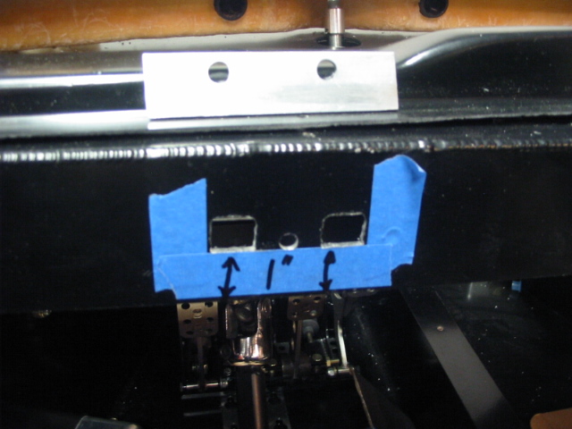

Dash Bracing

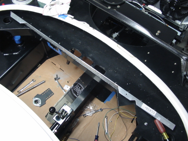

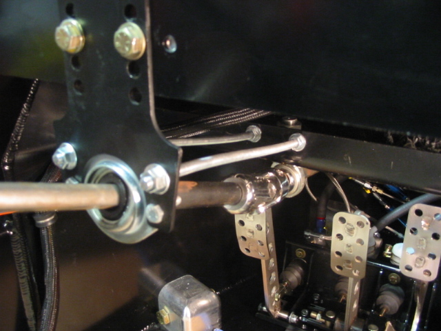

The nibbles and bites taken out of the chassis to clear the speedometer and vents as well as removing sections of the square tube supports on the underside had weakened the structure a bit. This was noticeable when one grabbed the steering wheel and pushed it up or down. Accordingly we fabricated a support, four feet long, from a section of aluminum angle, 1 ¼” x 1/16” thick. This was cut and trimmed to fit flush aft of the evaporator. Once secured with several ¼” bolts we noticed a significant improvement in the strength of the chassis. The up and down flex was greatly reduced.
The first picture shows the angle support bracket, cut to fit, resting on top of the chassis in the same position it was secured below the chassis. The second picture shows the right side of the bracket behind the speedometer opening.
The support bracket for the steering column had a bit of in and out flex. To eliminate the flex two lengths of 5/16 inch threaded rod, ten and a half inches long, were placed on either side of the steering support bracket to secure it to the chassis. This simple modification had a dramatic effect on the rigidity of the steering assembly. Don’t forget to tighten the tiny set screws on the steering column support, which are not easy to see.
To give us a bit of room for up – down and left – right adjustment of the steering column, the two holes for the bolts securing the bracket were enlarged, and made rectangular in shape. A backing plate was fabricated. This arrangement enabled adjustment of the column so that it is perfectly centered within the dash opening as well as permitting proper height adjustment. The top of the backing plate rests just below the bottom of the cross brace described above on the backside of the chassis. In the last picture the backing plate is setting on top of the chassis before it was installed.

That looks like it is for the speedo. I thought there was plenty of clearance, now that my gauges are installed I need to go test fit mine.
The opening on the right is for the speedo. We cut as little as possible off the sides of the fiberglass dash board to clear the roll bar (see earlier post) which then requires a bit of a juggling act to slide the dash and roll bar into place together. This means that the dash needs to drop down and back as it slides into place, hence the larger opening. The AC air plenum also drive the dash "up" as it is slid into place, adding to the need for the larger opening. The fuse box and the three turn signal relays mounted on the bottom of the dash board (see earlier post) also made for a tight fit, so the hole was further enlarged.
It is like a puzzle. Depending on how the pieces are shaped, it goes together differently. If we had opted to take off more off the ends of the dash to clear the roll bar so that the dash would slide in after the roll bar was bolted in place, the opening would have been smaller. But keeping more of the dash required taking more of the aluminum so that the dash and roll bar could slide in together.
Once the opening for the speedo was cut we found we had taken a bite that essentially went to the to of the vertical metal. This would have been necessary regardless. The 'integrety' of this section was then compromised and flex was noted. Taking more did not really make much difference in the integreity of the structure, so we opted to take out what we needed and than added the brace as noted.
I am definitely not saying that our apporach is the 'right' way to do it. The nice thing about the RCR is that one can approach different issues differently to reach the desired result, depending upon ones priorities. My goal was to keep as much of the fiberglass dashboard intact as possible for asthetic reasons. There are clearly different ways to approch the project which may work as well or better.
As I reflect on it, perhaps removing the speedo, installing the dash, then installing the speedo after the dash is in place would enable one to make a smaller hole and slide it together. Our speedo wires have slack in them and knurled nuts were used to secure it, so this would have been an option, but I doubt it would have had much effect on the final result given the size of the opening needed to clear the speedo.

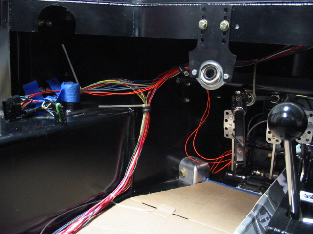

Chassis Wiring, Part II
Wire Harness

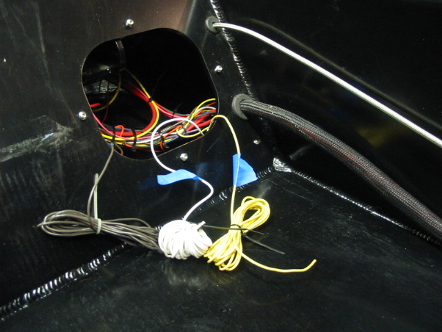

The chassis wires coming from the dashboard had previously been separated into groups. Each group was separately labeled to indicate which side of the dash and whether it would go to the front or rear of the car. Within each group the wires had plugs attached to match the plugs already placed on the dash assembly. These separate groups of wire were placed in the car and loosely secured with wire ties. A collection of wires extends across the area behind the evaporator which was secured with a padded hose clamp. Additional clamps were added on the left and right sides of the chassis. The group of wires that goes to the back of the car was run along the left side of the driver’s seat, where there is a nice gap when the seat is installed. (Recall that the center spine is off center giving an extra couple of inches on the driver’s side). With the harness temporarily in place the separate wires could be pulled snug before securing them and placing a wrap over them.
Additional wires had to be added, which are not part of the dashboard harness and Painless kit.
(1) A blue wire was run from the compressor to the trinary switch.
(2) One 8 gauge red wire was run from the alternator / battery to the Jegs junction block located on the rear power board at the left rear. Another 8 gauge wire was run from the same junction block to the Jegs junction block on the front power board.
(3) A wire was connected to the engine block electrical thermostat switch and run forward to the cooling fan relay.
(4) Three wires were twisted tightly and wrapped with tape to connect the speedometer to the speedometer interface mounted on the forward power board. These wires were kept separate from the other wires by an inch or so to minimize interference. The three wires are for ground, B+, and sensor input. Remember that the power source comes directly from the accessory connection on the ignition switch and the ground connection is directly to the chassis, not to the dash ground bus used for instrument and switch ground connections. The speedometer connections must be directly wired and not share connections with the other switches and gauges.

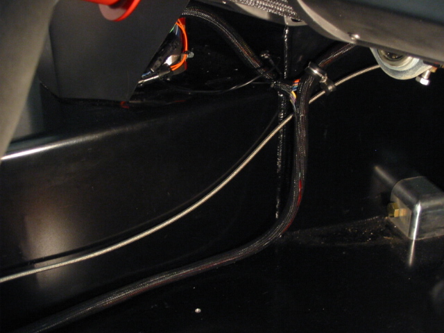

The rear light wires were run along side the brake lines on either side of the engine, then routed straight back toward the respective lights. This results in an inconspicuous, neat layout.
The wires were wrapped with Painless Powerbraid Wire Wrap. This is a new product which provides a really clean, professional result. We prefer it to the convoluted tubing usually used. It comes in ¼”, ½”, ¾” and 1 ½” diameter. Although it stays in place well, an occasional wire tie is a good idea.
There will be a group of wires running vertically on the left side from the floor upward, forward of the dash which may be visible. Check out some old pictures and one will see a similar cluster of wires on many of the original GT’s. With the black wire wrap it will be inconspicuous. Whether we cover it with carpet or leave it exposed remains to be seen.
Four ground posts were placed, one on each side of the dash and on both sides of the engine compartment (by the rear power board on the left, and the battery on the right). We used quarter inch stainless button head screws. The holes were drilled and tapped so that the screws could be tightly screwed into the chassis to assure a good electrical connection. (With a bare aluminum chassis, tapping the hole would be less important). A star lock washer and standard stainless nut was used to secure the ground wire lugs to each bolt. Recall that we have at least two ground posts for the dash. One cannot have too many ground connections!
Our goal was an engine compartment as free of visible wiring as possible, yet all the wiring remains easily accessible.
The forward section wires were routed along the lower edge of the radiator. The wires for the head lights, driving lights, turn signals and marker lights were bundled on the left and right sides, to be connected later. Connections for the trinary switch and windshield washer were run behind the brake and clutch fluid reservoirs. All of these wire groups were wrapped with Painless Powerbraid Wire Wrap and secured with padded clamps. A ground terminal was placed on the lower center of the radiator fan bracket. Although it is grounded through the mechanical connections, a separate 8 gauge wire was connected to a dedicated ground stud to assure a solid ground connection.
In the third picture three coils of wire are visible. These are extra wires for the oil temp gauge (which we do not yet have), an auxiliary fan in the engine compartment, and a connection for the red dash warning light. These wires will be left in the aft compartment for future use. The stainless braided line is the throttle cable, which will be concealed beneath the carpeting.
