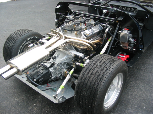

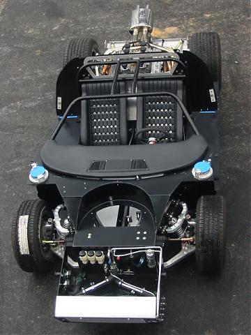

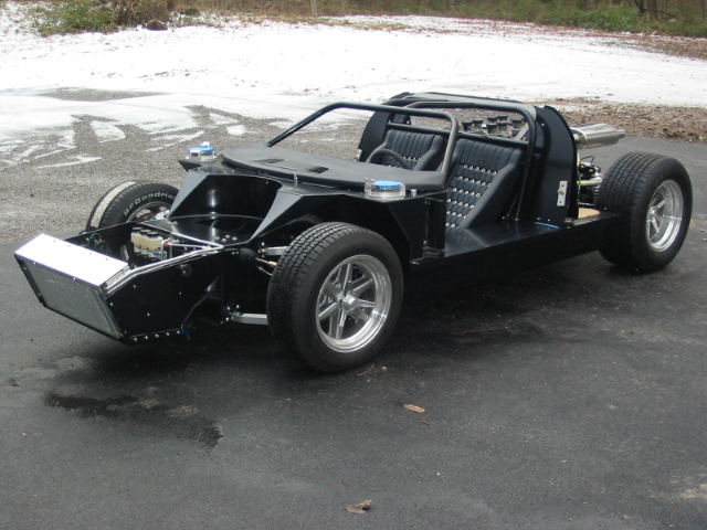

Sunday, February 3, 2008, while 95 million Americans were preparing to watch the Super Bowl, Ryan and I were putting the finishing touches on the chassis. The last parts keeping us from driving the car were the half shafts, and when they arrived last Thursday, Ryan was rather insistent that we drive the car this weekend. He is a real slave driver.
It all came together Sunday afternoon after two long days of work. It was about 45 degrees. No excuse not to give it a try. We rolled it out and fired it up.
The engine started right up and quickly settled into a nice idle around 1000 RPM. There was bit of popping that will need to be addressed. It always amazes me how those Webers can idle so well so quickly without a choke. Engaged the clutch for the very first time under power and slid it into reverse. Engaged the clutch and shifted into first. We drove out of our driveway, and just kept going to the end of the subdivision, about a half mile. Managed to get up to third gear, turning over only 1500 RPMs or so, but the engine did not mind. Got back to our drive way. This time it was Ryan’s turn. Of course the pedals had to be moved forward two notches so he could fit, but fit he did, so we repeated the circuit.
Our first outing lasted all of two miles. We sampled the first three gears and the shifter adjustment seems to be just about right. The clutch is light compared to our 427 Cobra. It takes up smoothly. The brakes engaged smoothly as well. The engine seems to be running nicely although the Weber’s will need some adjustment to get rid of the occasional popping and back firing.
All in all, it was a good day.

Have you tried fitting the rear clip yet? I think you will have problems with the mufflers hitting the clip. I had to cut a pie section from my collectors to lower them.

Jon: Have not tried the clip since we put the exhaust system on. The body work comes next.

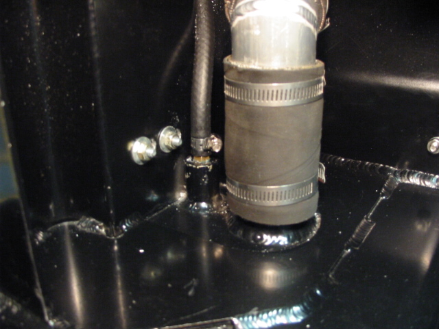

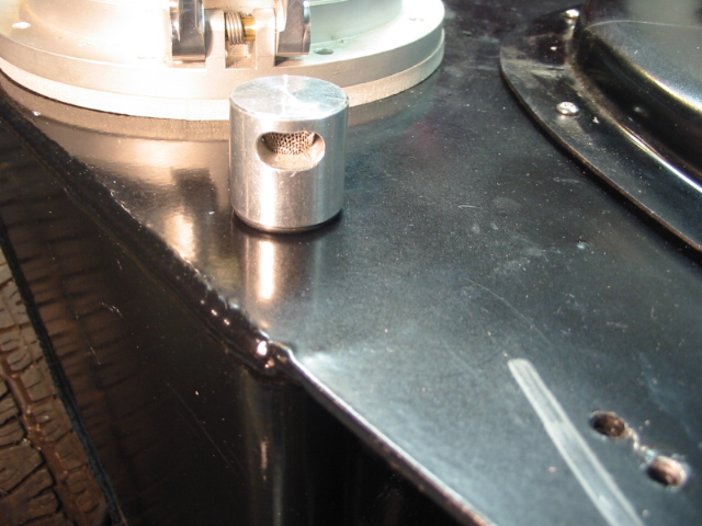

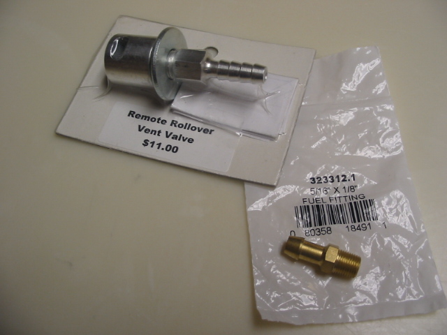

Fuel Vents
The RCR has a threaded opening adjacent to the fuel filler for a vent. A 5/16” x 1/8” fitting fits perfectly.
A roll over vent valve was obtained from Street Rods by Michael, Inc. www.srbymichael.com. A 5/16” section of fuel line completes the package.

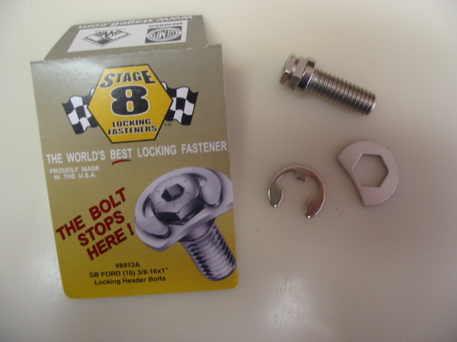

Exhaust system
The manifold was secured with Stage 8 locking fasteners. They can’t come loose.
