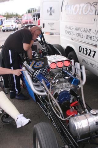

Was out at Santa-Pod today playing with a competition altered car that was running.
Anyway, whilst I'm familiar with the 350SBC - I've not dealt with any that are out-n-out drag power with no water used for cooling.
Has anyone on here got hands on experience of such motors and use thereof - just want to bounce a few thoughts with someone in the know..:thumbsup:

This one seems to not idle well with cyls 4/6 cold at idle and plugs basically dry. (plugs leads and fuelling checked) Picking up the throttle give slightly warmish exhaust gasses on 4/6 but lots of popping/banging on those cyls on lift off. Anyone got any ideas? As it is the centre pair of cyclinders I'm guessing a head gasket has failed.

Yeah - suggested pretty much that already Howard.
What I'm intrigued about is how can the motor stand this sort of treatment? - I know it is warmed before a run and that after the run they get towed back to pits so it has some time to start to cool. What sort of temps do you think are acceptable for this type of use.?
