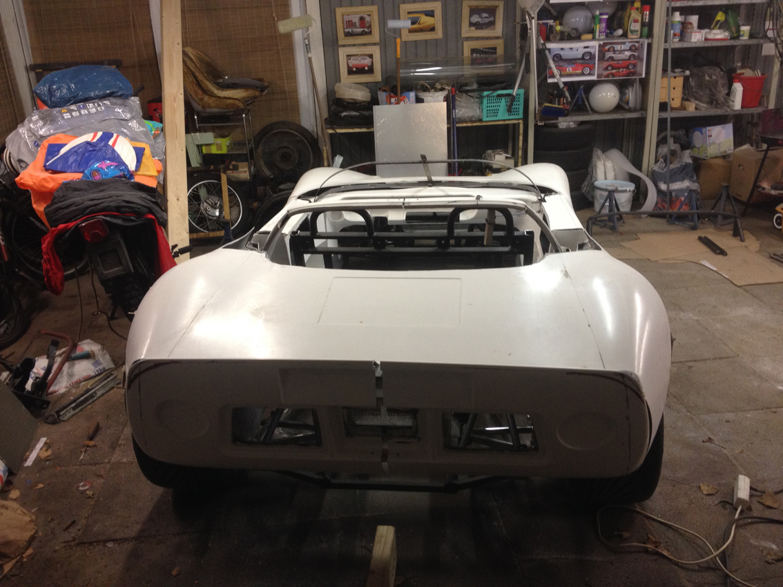

Re: German GT40 interpretation

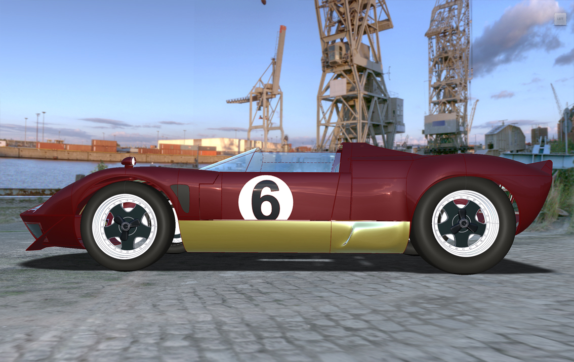

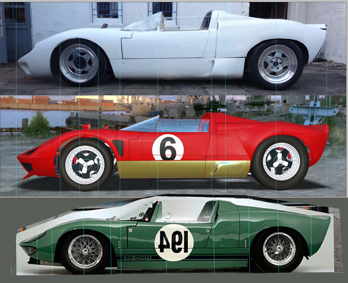

here is a comparison between the 3D, the original roadster, and my car.
What worries me is that my frontend looks like it has a tendency to "hang down"...
Wonder if I should rebuilt this or if this a minor issue because you will not notice after adding lights, lightcovers and paint...
Personally, I don't think it does. It's the lower light cover's edge that is not parallel to the ground I think that causes the illusion of a 'droop-snoot'. Try some tape stuck on to square the opening off, parallel with the ground, and re-take the photo. I then think the front end will appear as in the other examples.
If you hadn't have mentioned it, chances are no-one will have noticed.
If you want to modify the lower light opening, that would be far easier to 'square-up' compared with the rest of the front end which I think looks fine.
Nice job.

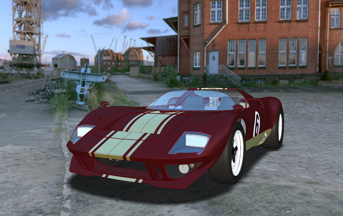

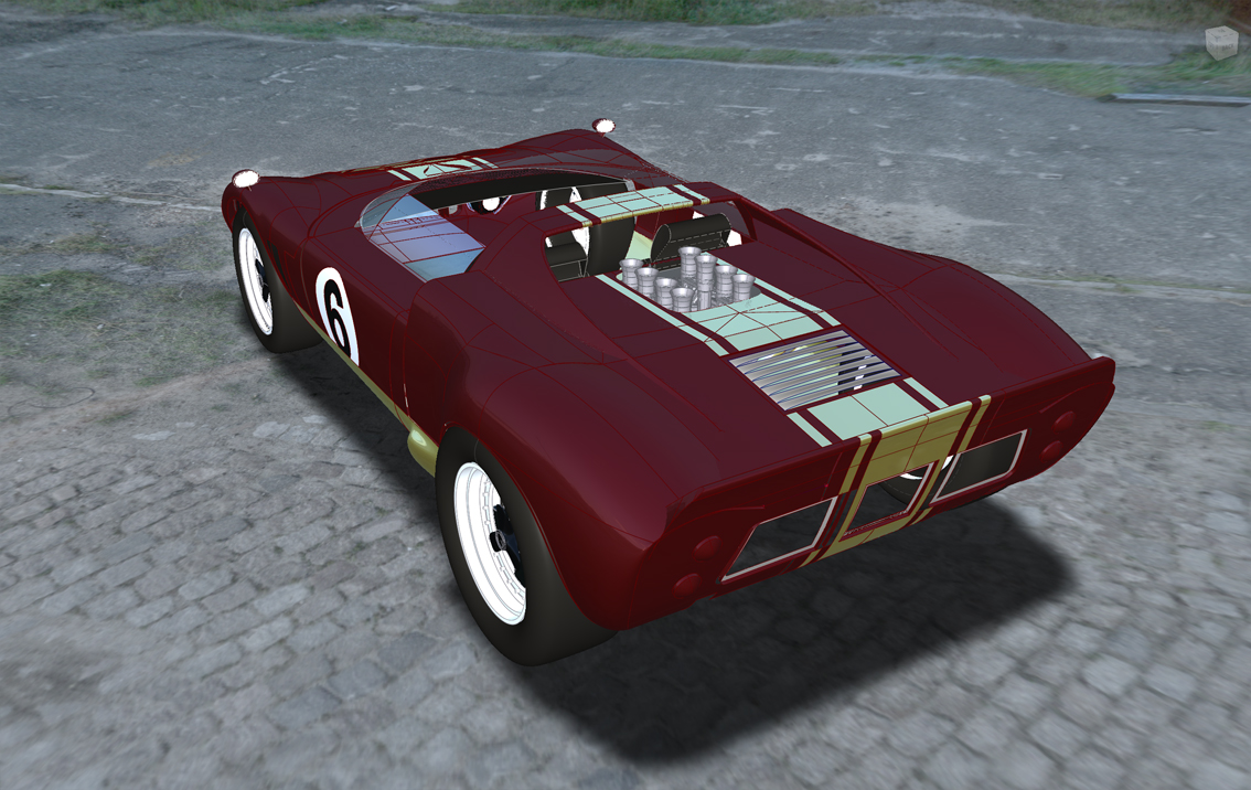

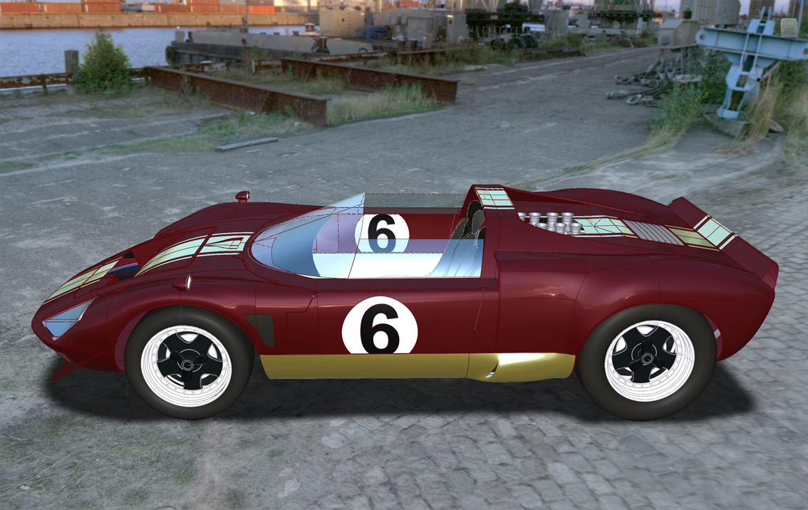

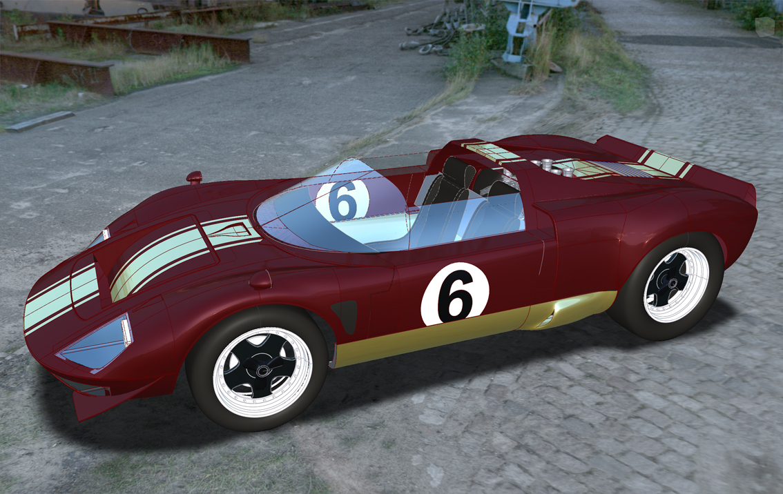

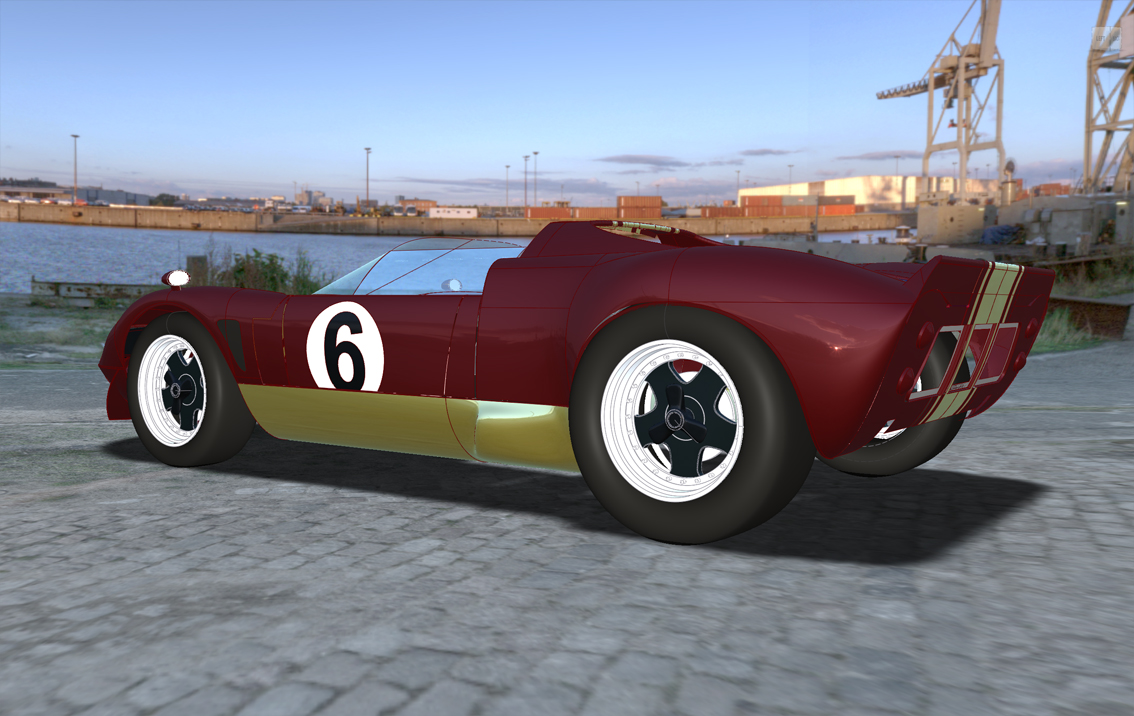

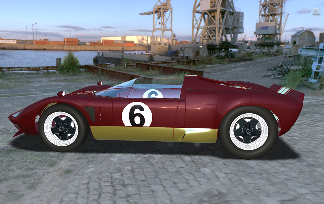

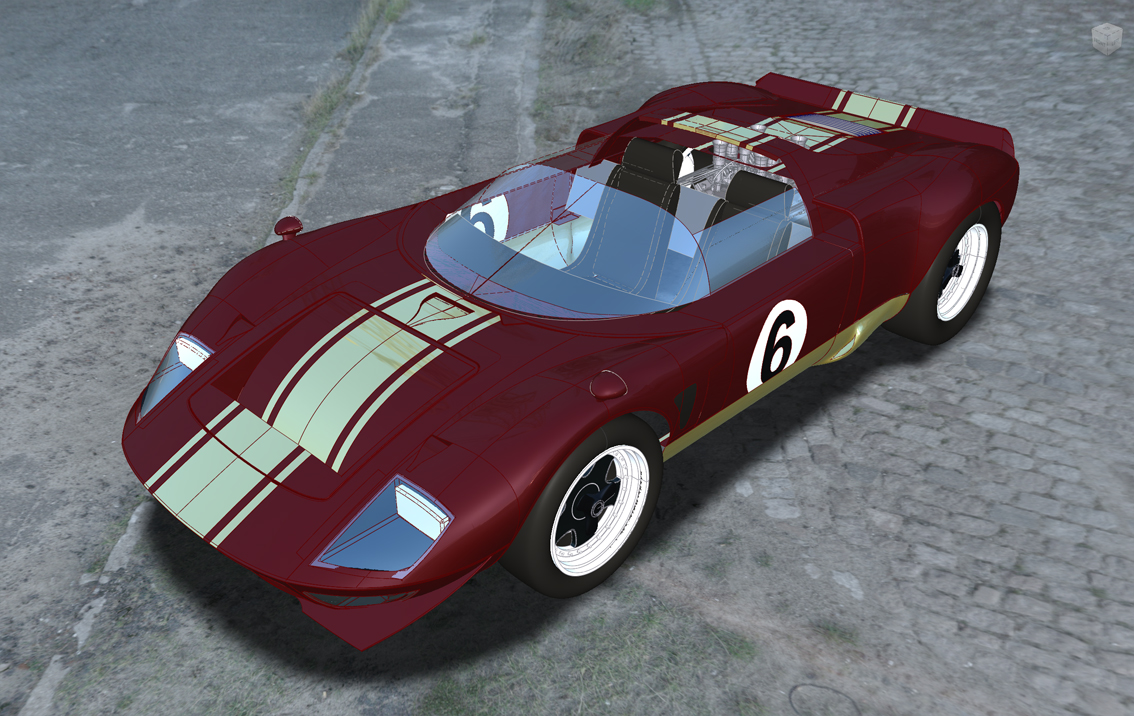

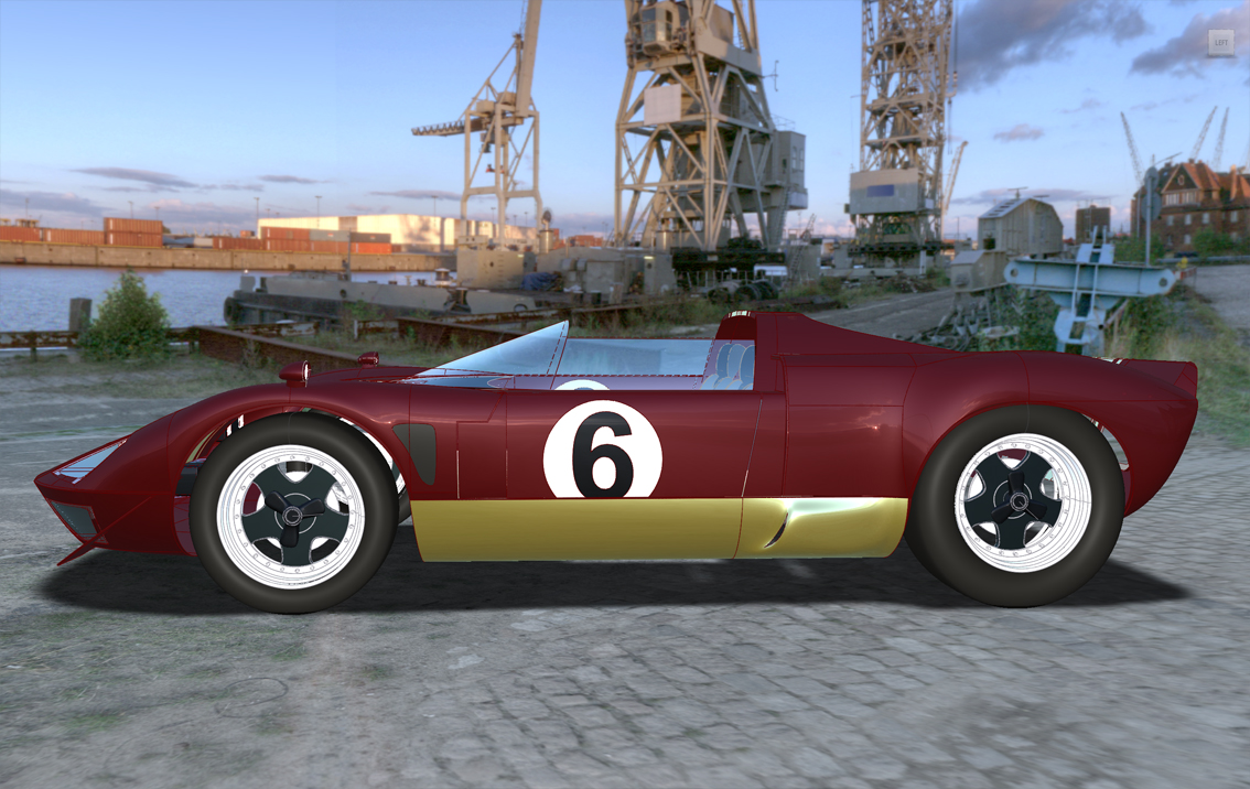

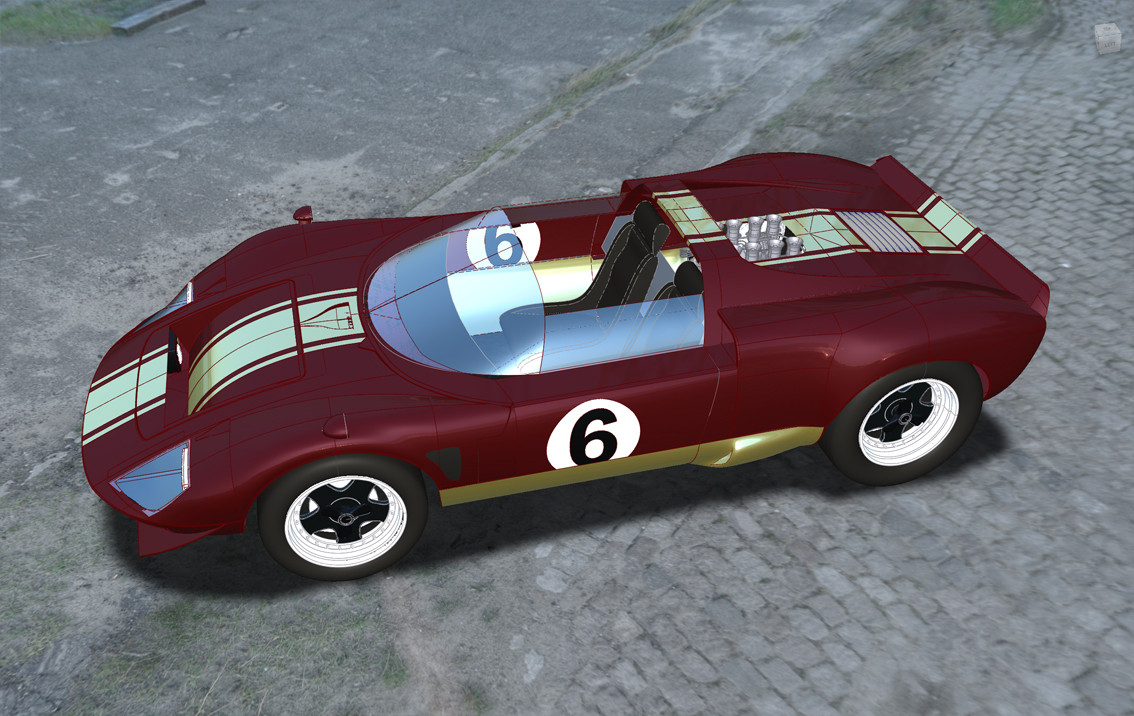

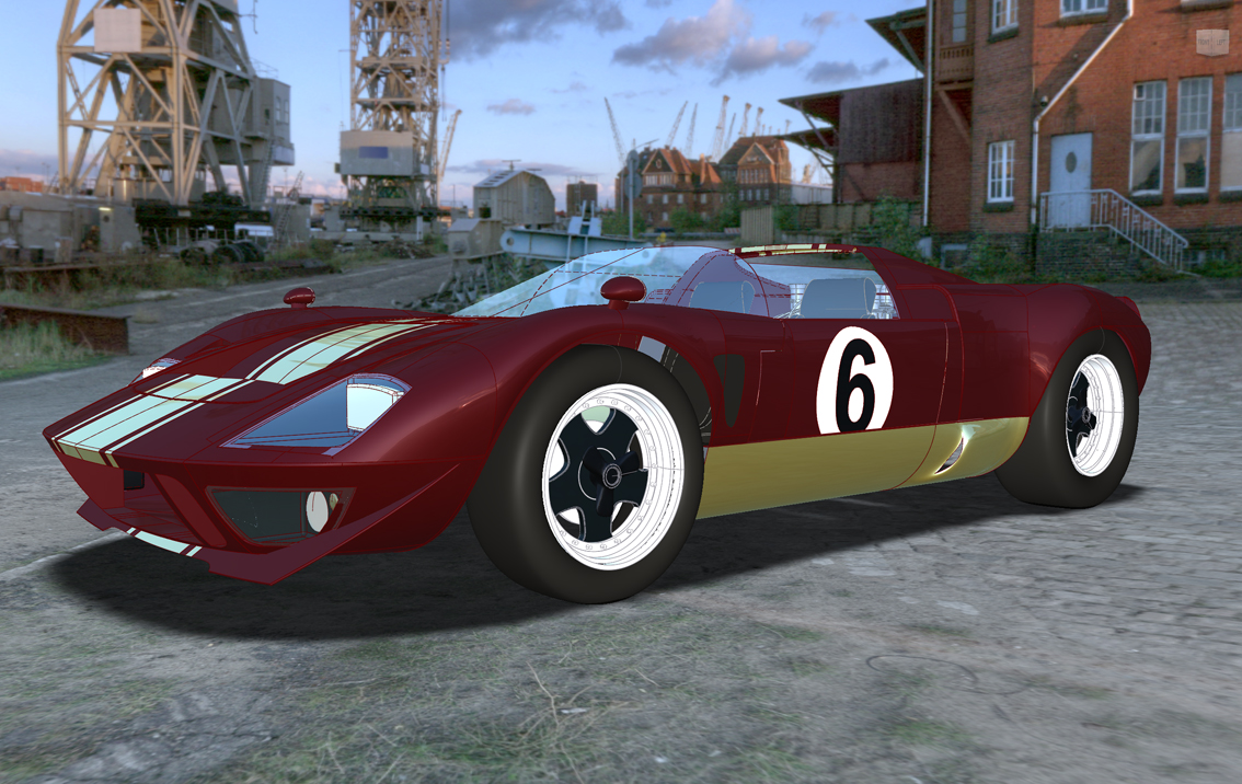

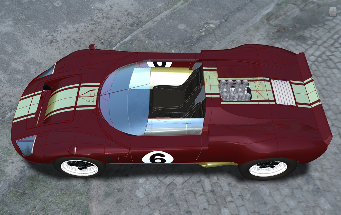

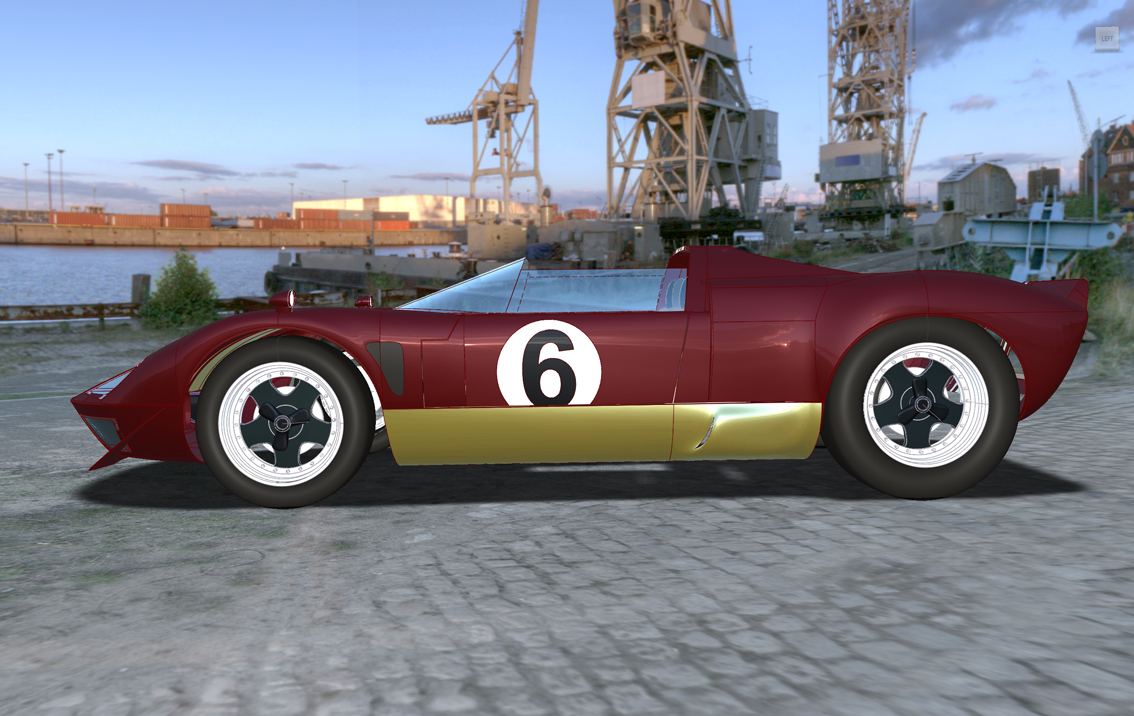

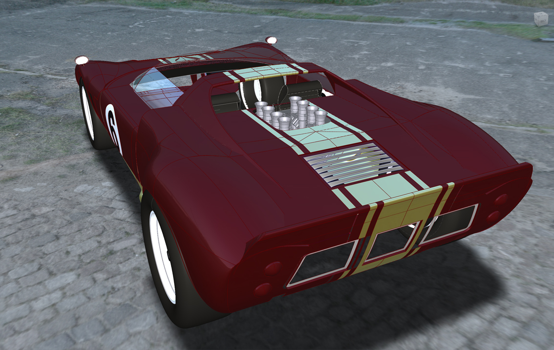

It is a better model now, worked out the rear fenders with the upper vents, and improved some other bits, and darkend the red colour ;-)
Wish I would have more time and my workshop would be much warmer so I can transfer my ideas into the real car...

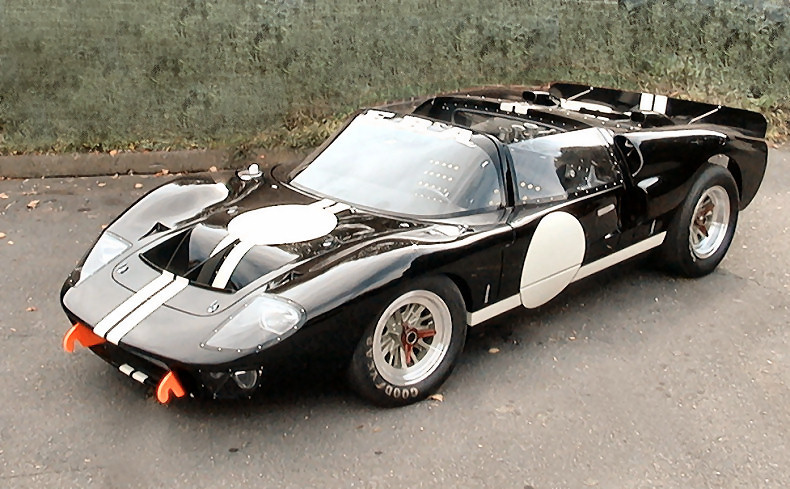

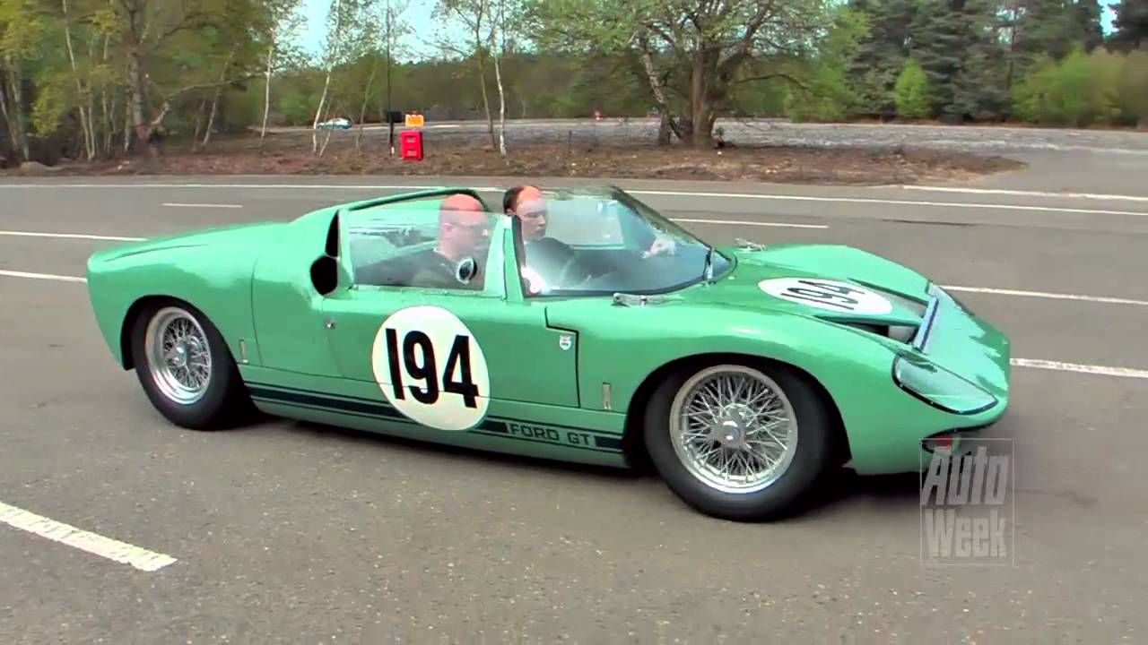

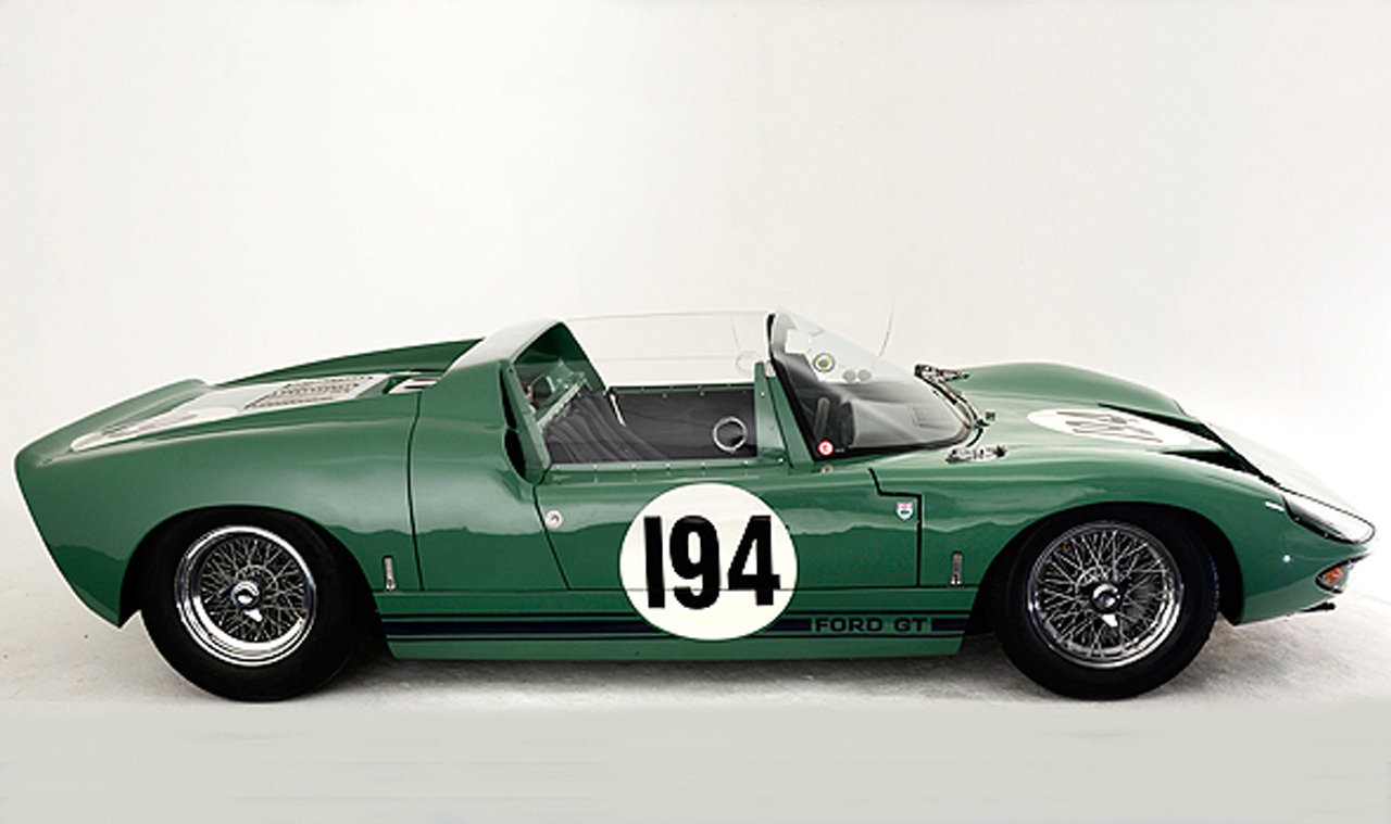

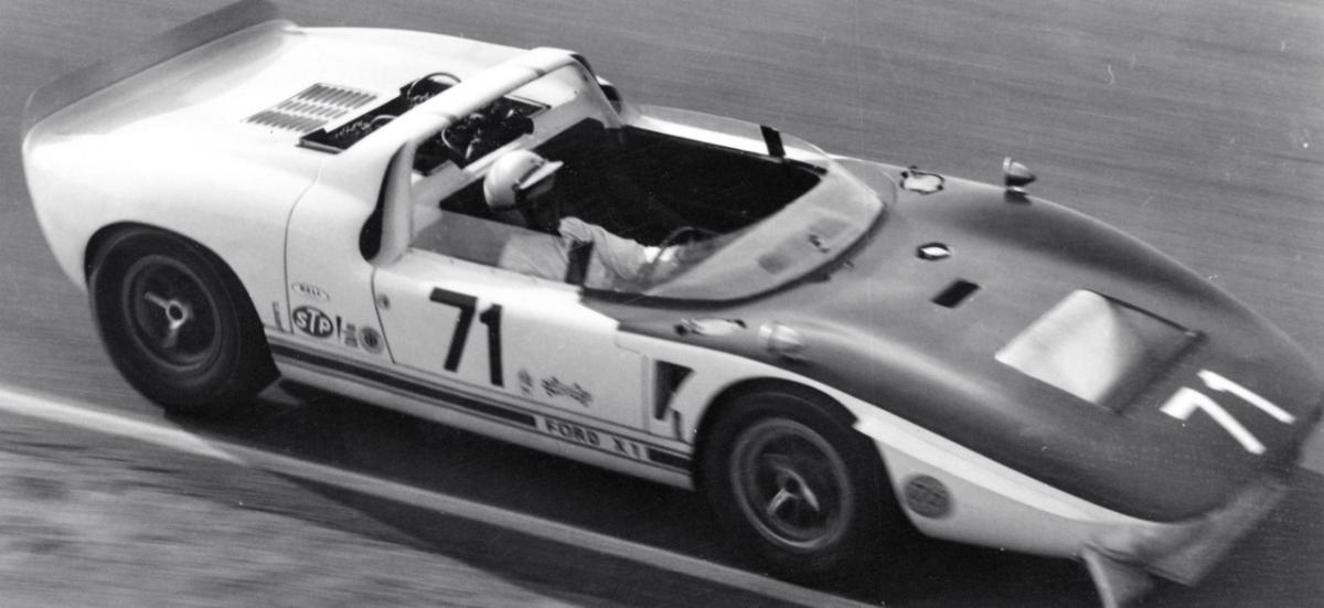

some original roadsters as a comparison

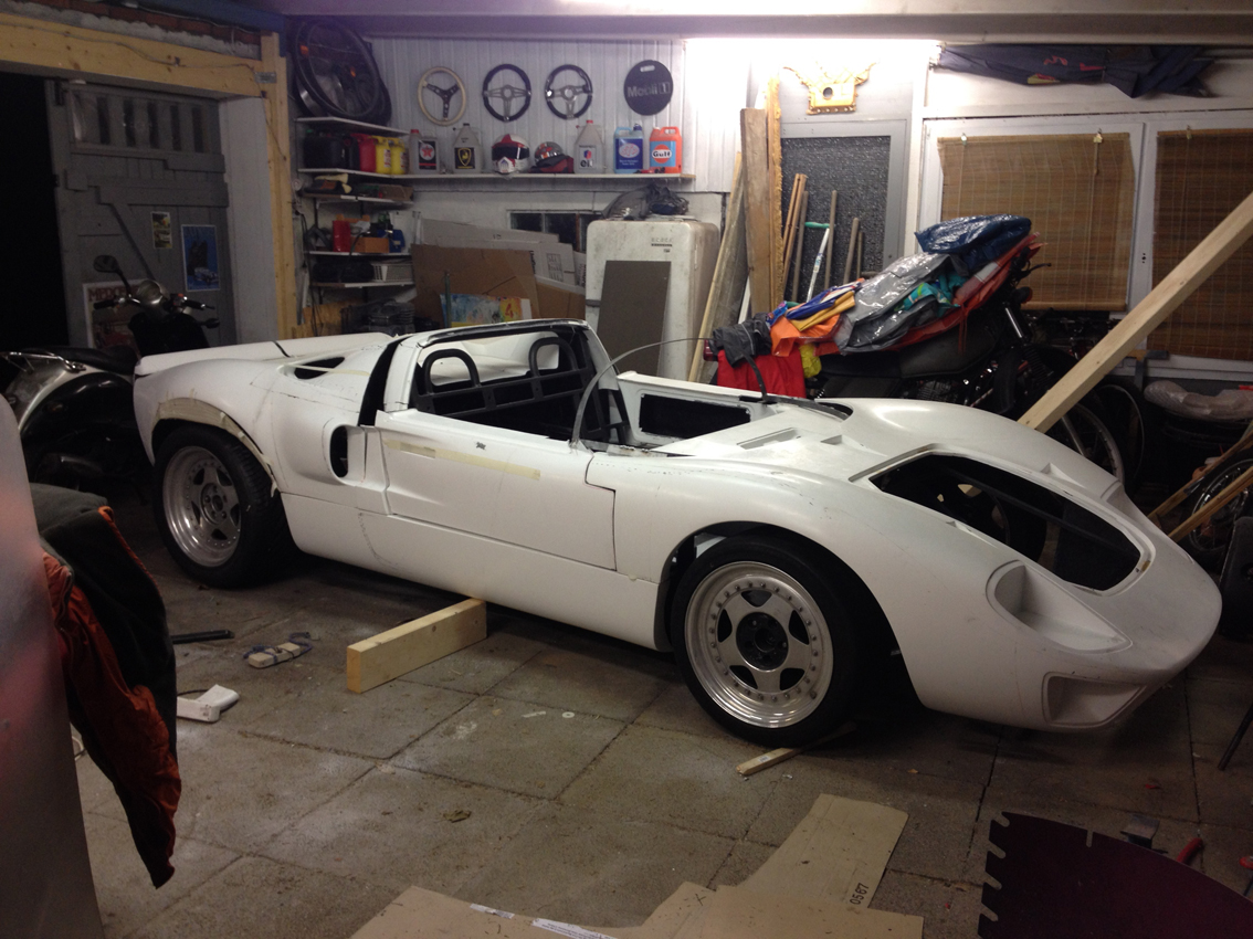

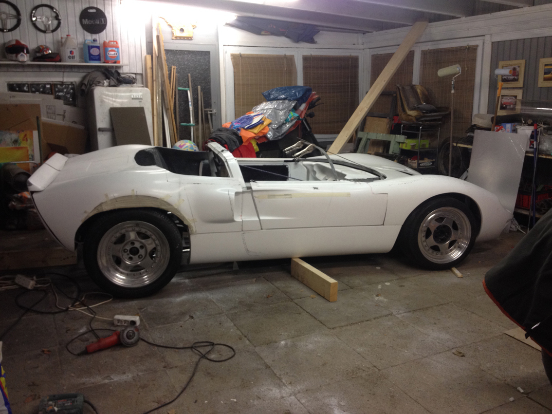

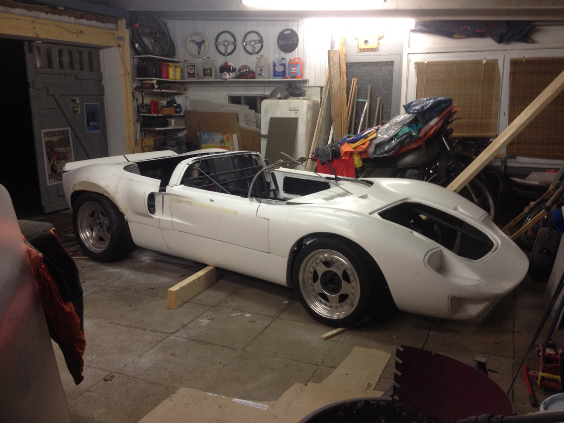

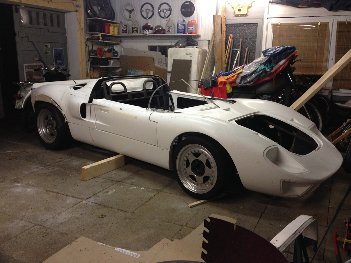

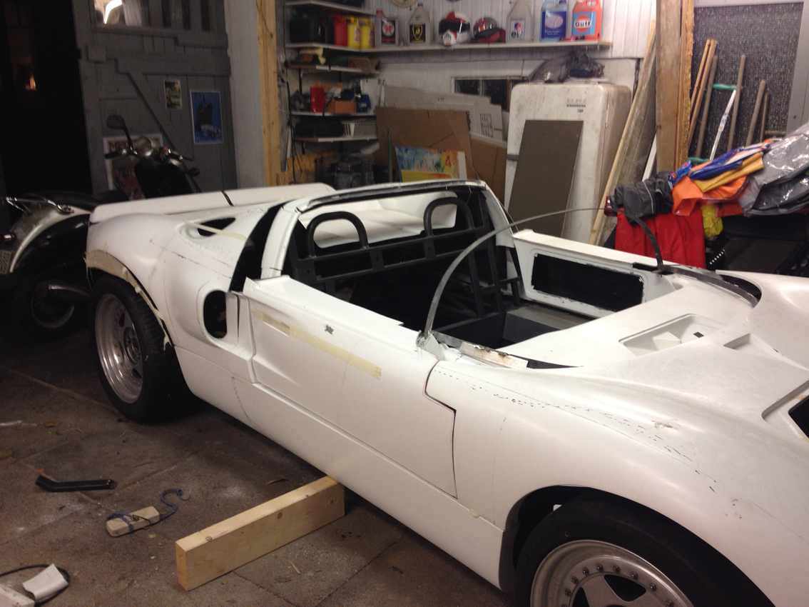

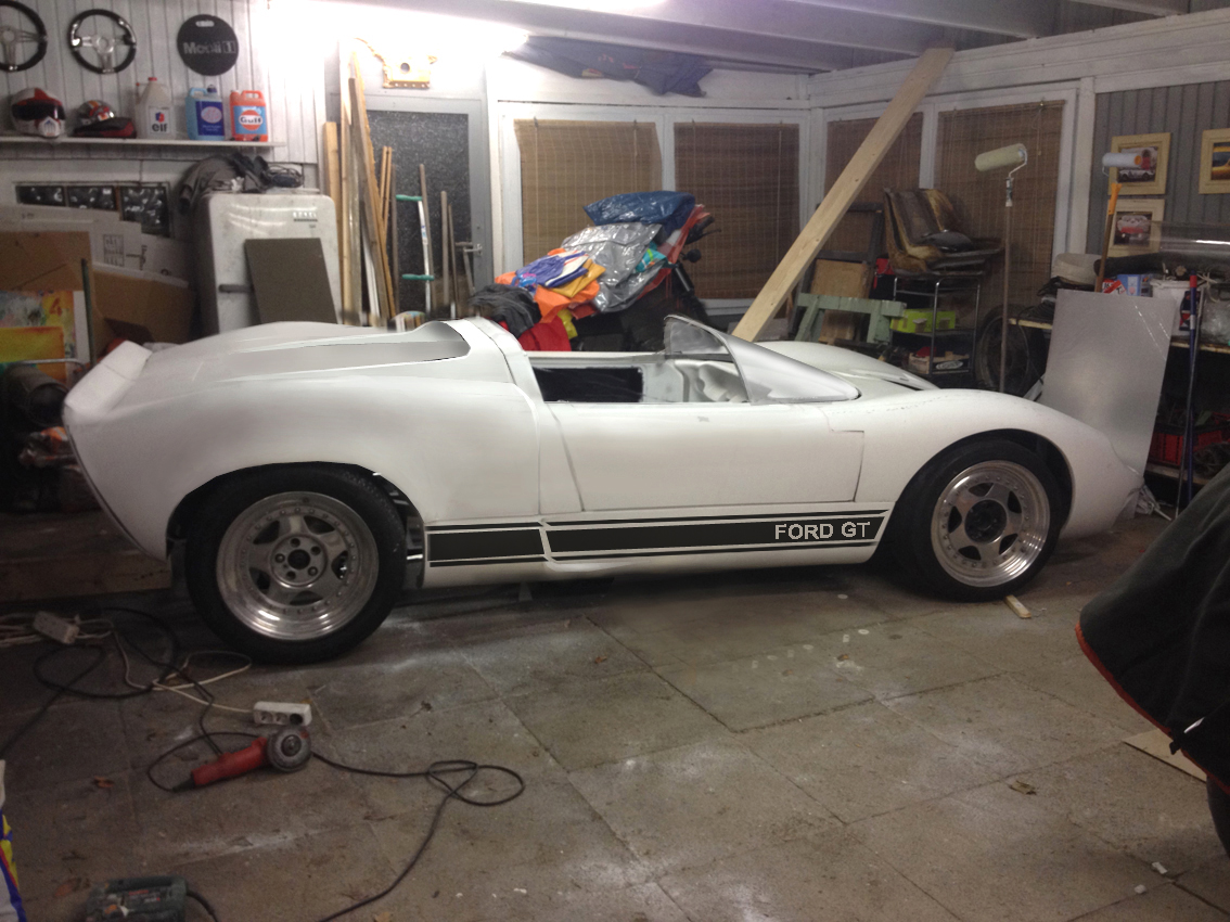

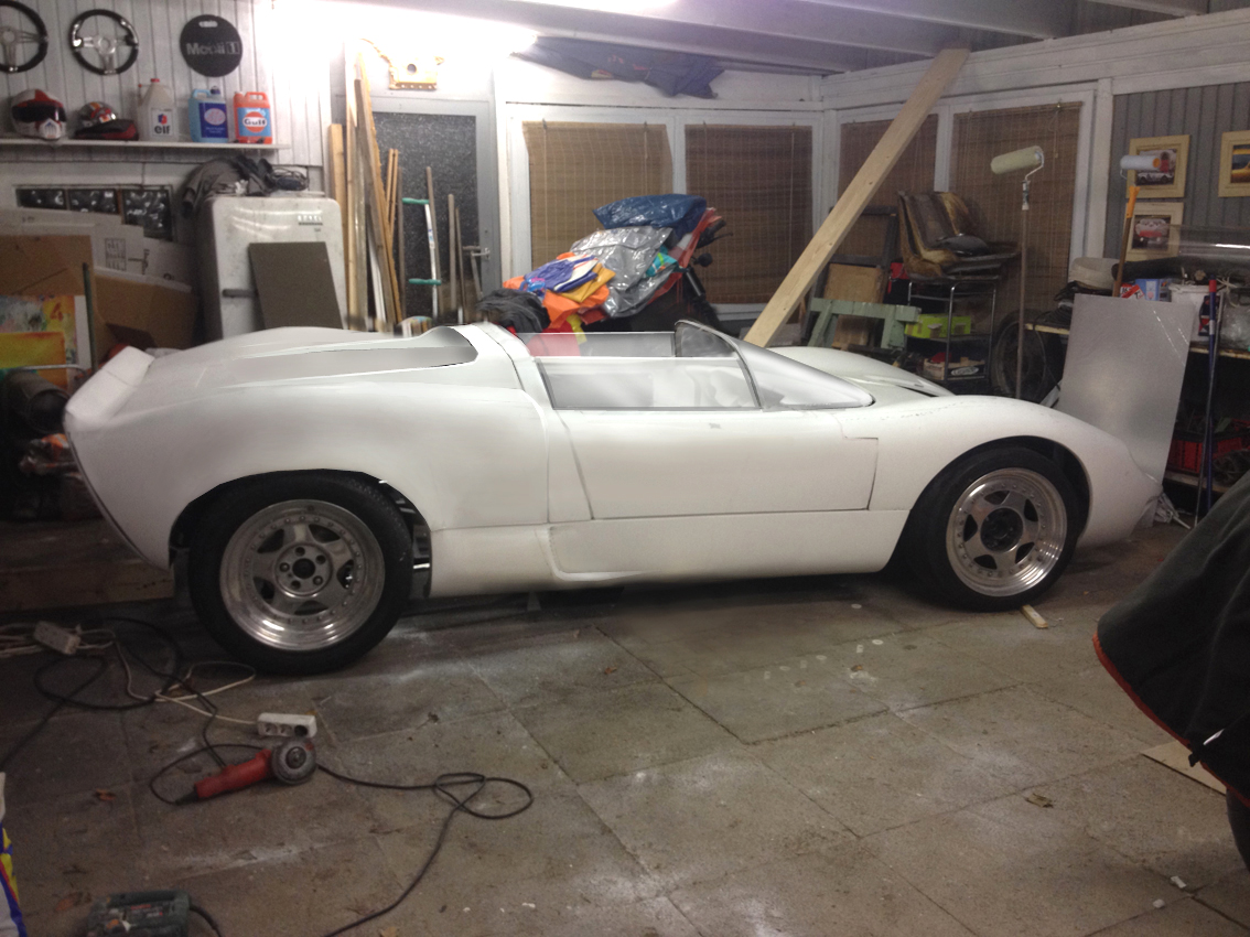

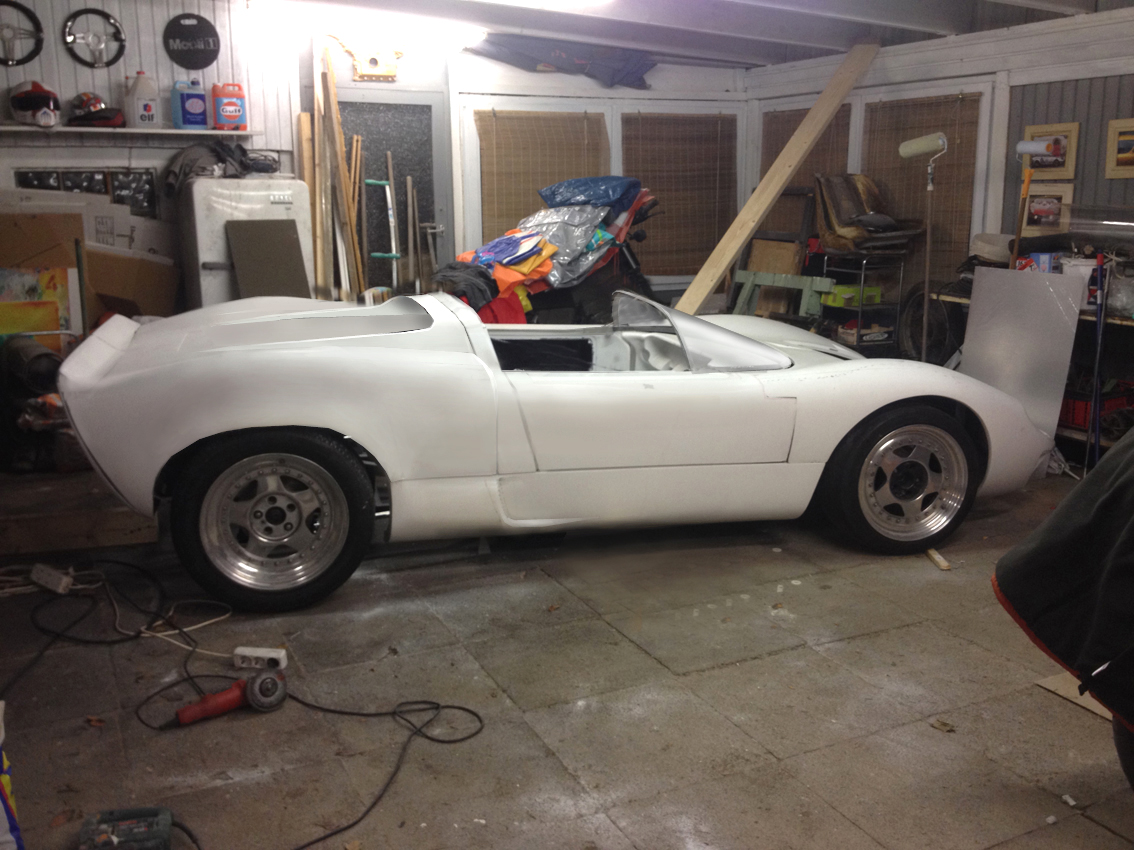

starting to modify the b-pillar, and removed it after I have noticed I cannot keep the upper frame...it is too wide :-(
This is the moment when you realize how much work it will be...and when you realize now there is no way back...!
Am I going the right way? I always try to convince me with photoshop experiments...

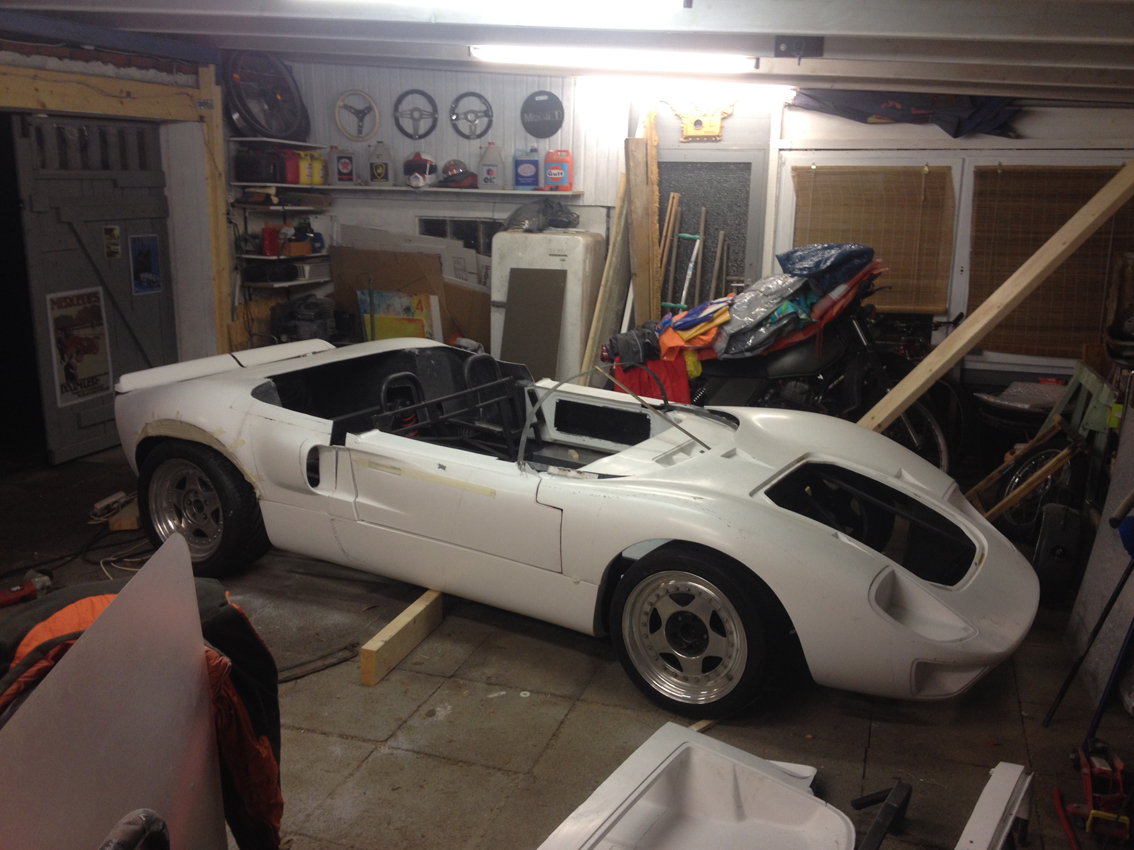

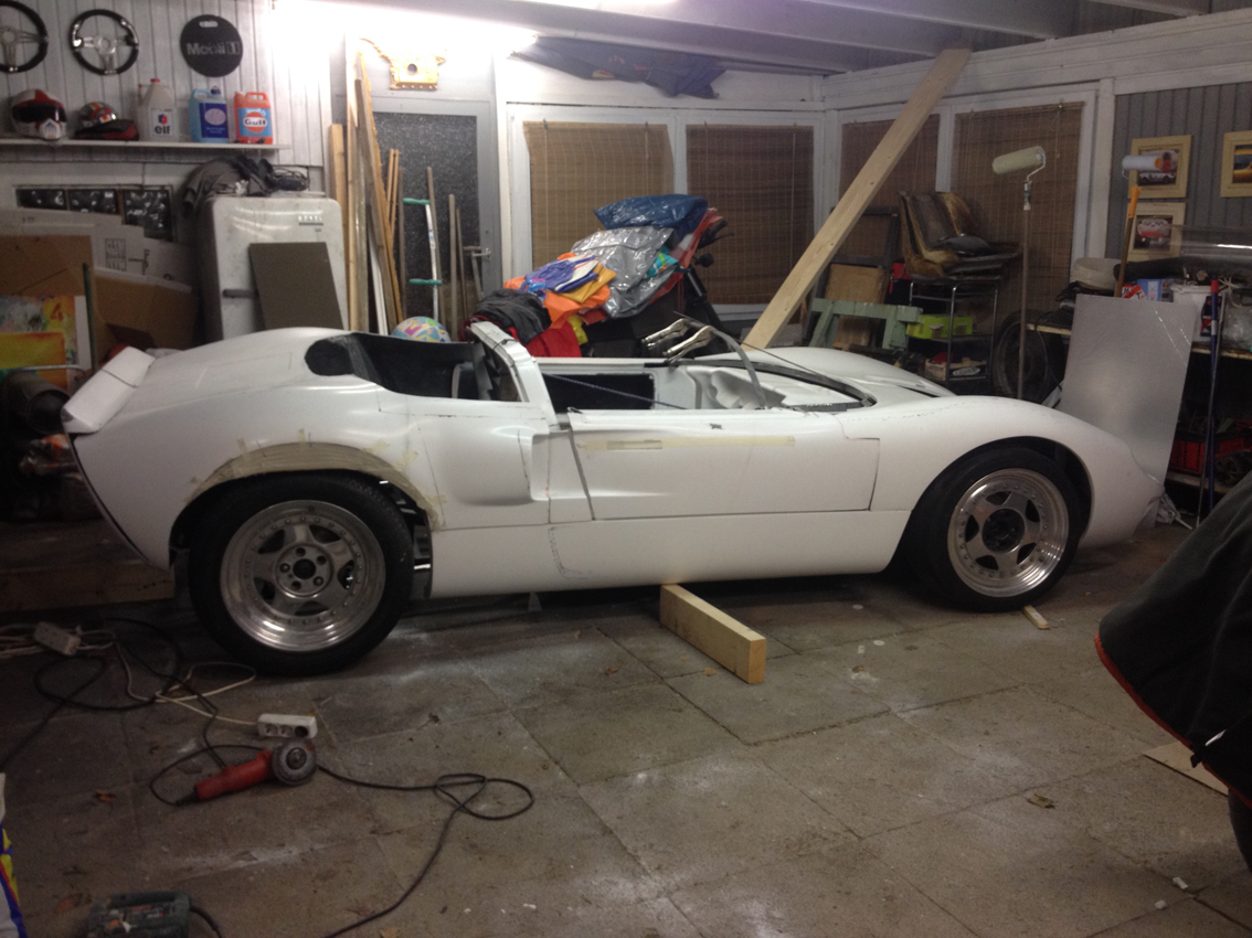

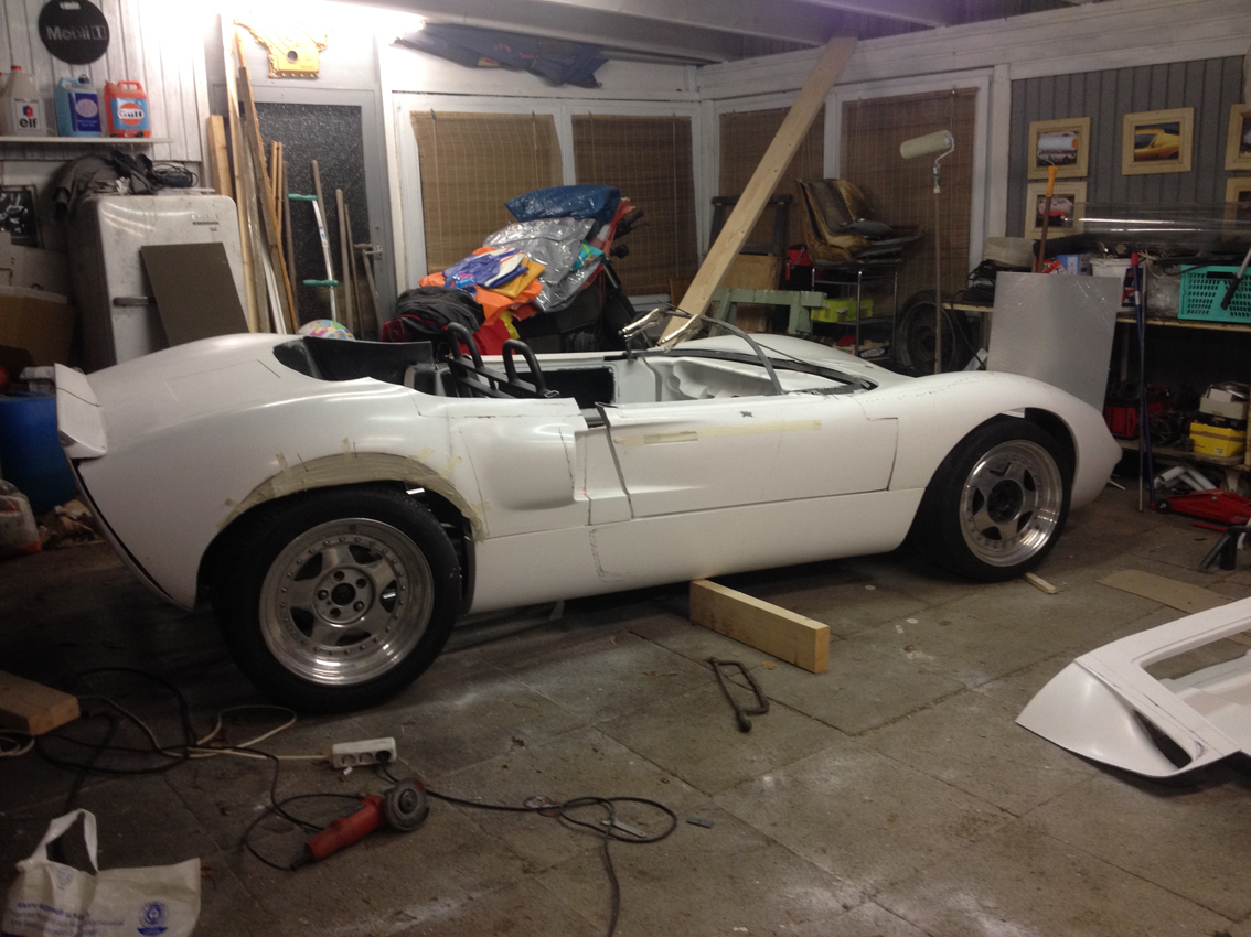

OOOooh my god.... can't believe I did this.... :stunned:
Why did I pay so much money for the body?...there is almost nothing left...! :laugh:
Now this is a blank canvas to start with...last pic shows how narrow windshield and b-pillar will be...

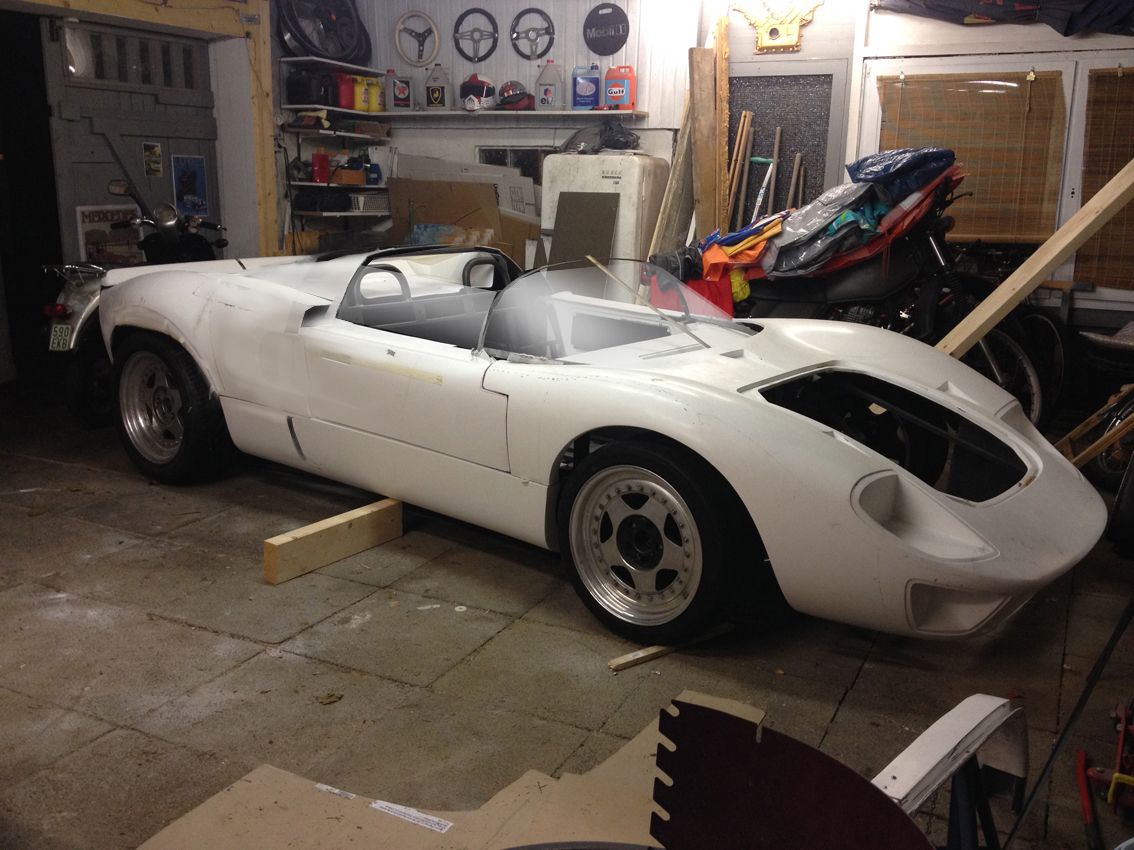

another photoshop proof....click through the changes
In post 47
I prefer the first pictures
The last one I think the rear clam shell looks too much like a Lola T70
In post 47
...better now? ;-)
You're right Ian, this is definitely an area I will play around with, may be I'll do it closer to the original with the double vents, I can check this with a simple card mock-up at the car now!

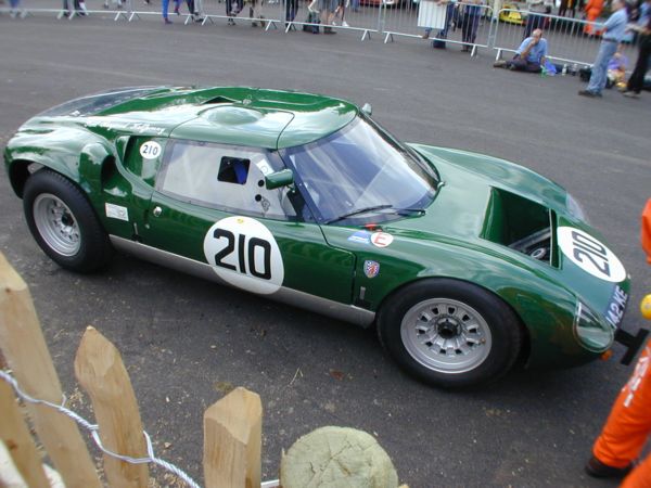

From the historic point of view there is a strong link between Lola and the GT40, I guess all of you know that the Lola GT MK6 did inspire Ford to use it as a base for the first GT40s...and the T70 vents are indeed very similar to my last designs if you see the pics!
Can't wait to try out all the different ideas with some mock-ups at the car, if time wouldn't be a problem...
