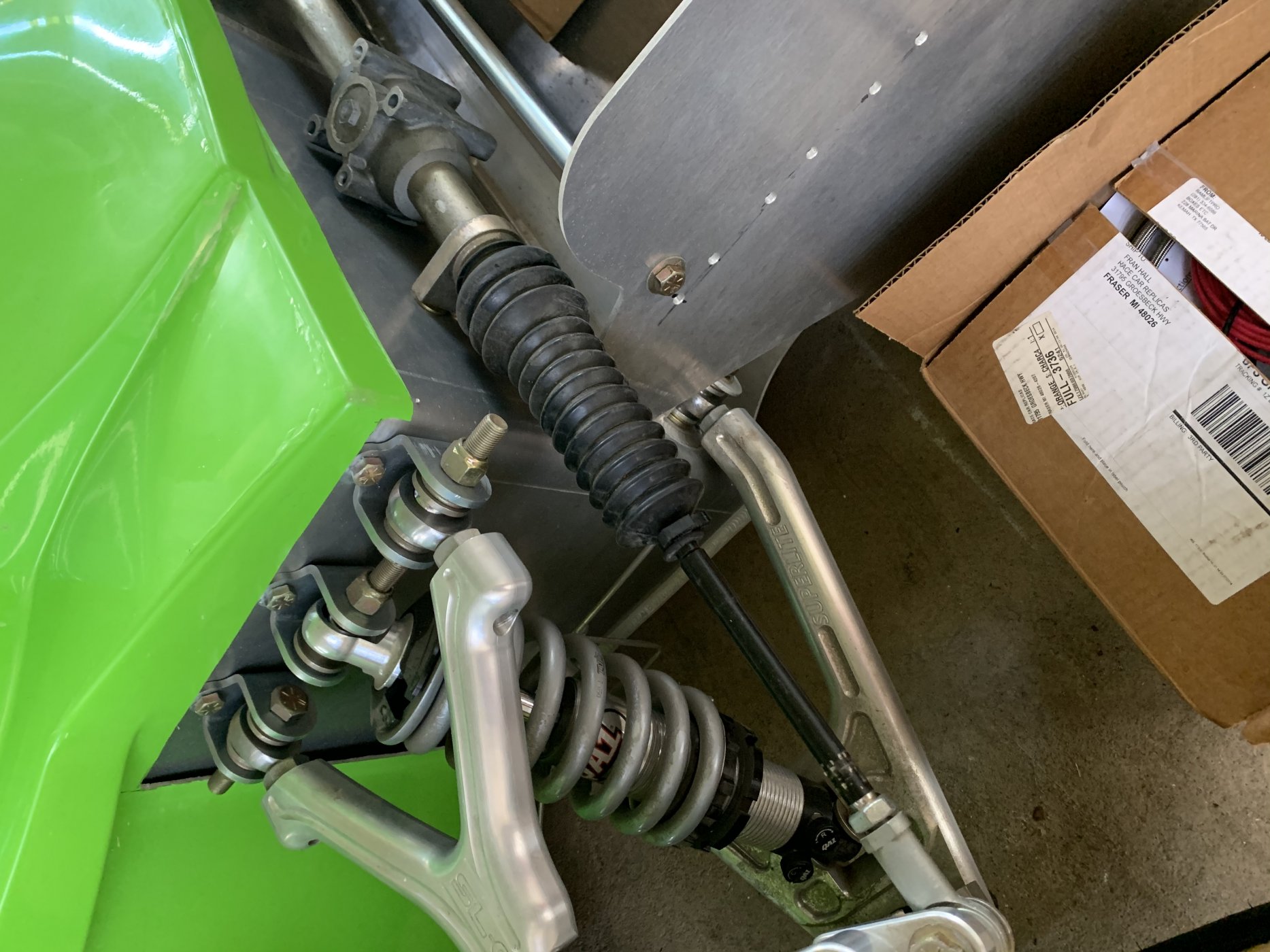

Hi,
if you flip over the steering-rack, when turning right, the wheels pointing to the left, strange feeling........ you will need a lhd steering-rack

Ya I wasn’t initially going to bid but couldn’t pass after Saturday. CamT informed me someone here may have a take off rack so hopefully I can source that easier. The dash I attempt to convert myself. The spline could be an issue, we’ll see once I get into it.

I was laying in bed last night working out the rotation and you’re right.

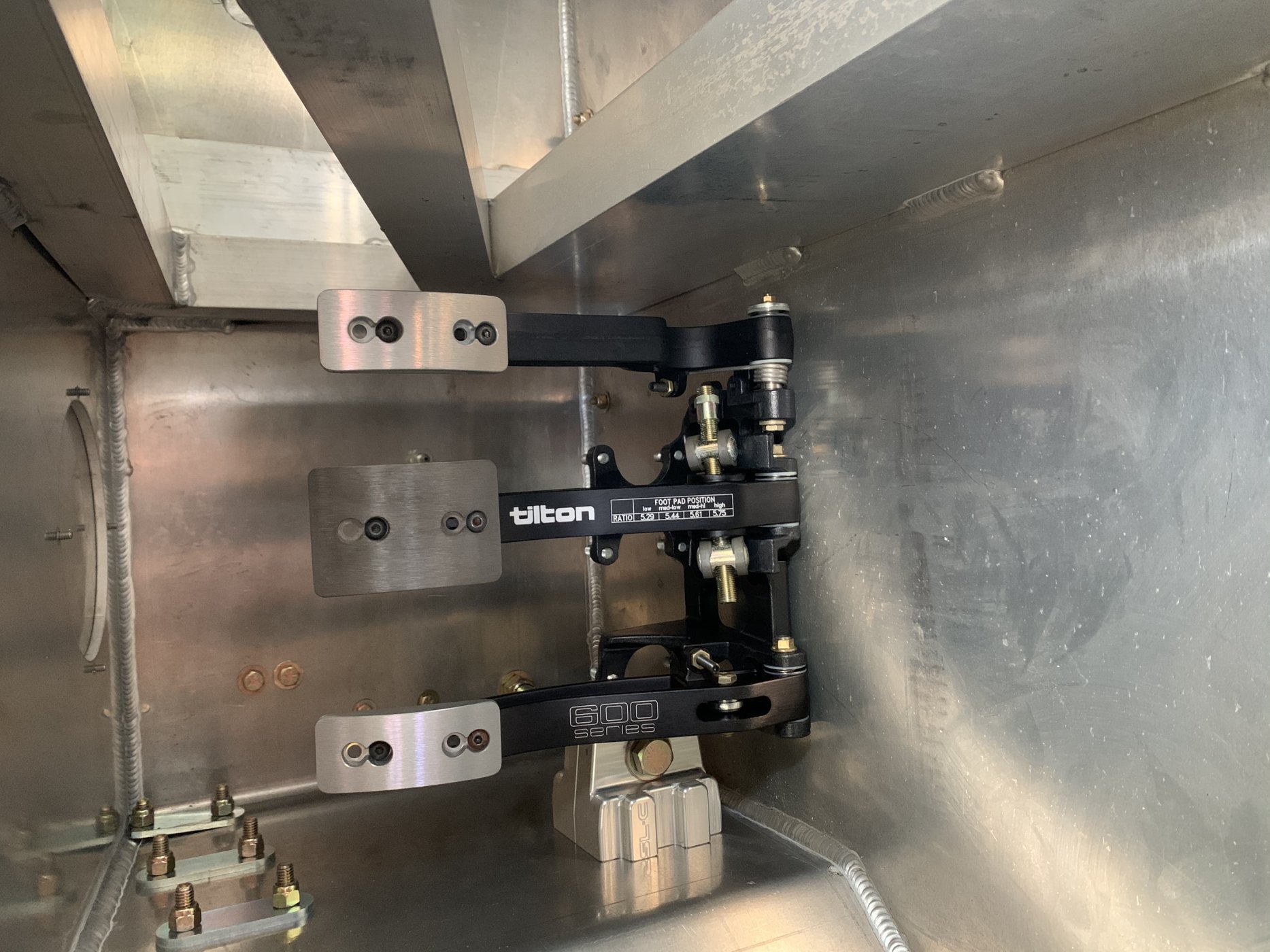

I just measured my tub. The spine is offset 2 inches. The pedal assembly will just barely fit before interfering with the lower control arm inner mount. The seating position verses the cluster and pedals will be odd. If you use a "gentleman's" seat the problem is that much worse. I guess the fiberglass tub center section will have to be cutout and re positioned as well.

According to Fran I shouldn’t have too much of an issue. A little tight but doable. I’m 5’11 195, no gut! So I’m hoping I’m ok.
It sold for $31400.
Thanks for the measurement, that was my biggest worry is the pedals fitting. I may be modifying my dash and center console extensively, much like CamT did. In fact, I’ve read his build multiple times so I’ll use what he did to build from.

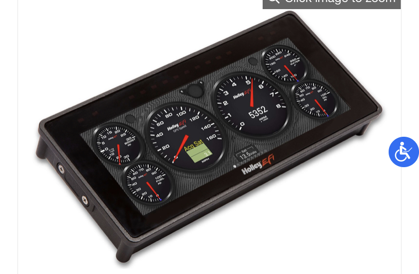

I had another thread where I posted I was able to make my LS harness standalone. However, everyone advises that I should ditch the ISIS/infinity harness and use my own rendition. I think my plan is to ditch my factory LS harness and use the Holley Terminator with the LCD dash. That should give me complete engine values as well as a nice screen with MPH, odometer etc. As far as the car power management. I think I can use a universal harness from Painless Performance.
By going this wiring route it will allow me to tune and manage my engine without having a tuner do it ($500 savings), cleaner wiring, nicer dash, etc. I am clueless when it comes to the car wiring though. I don’t mine spending money for the Holley terminator, but I don’t want to drop a ton for the car wiring when it’s literally only being used for basic power components. If anyone can advise that would be great.

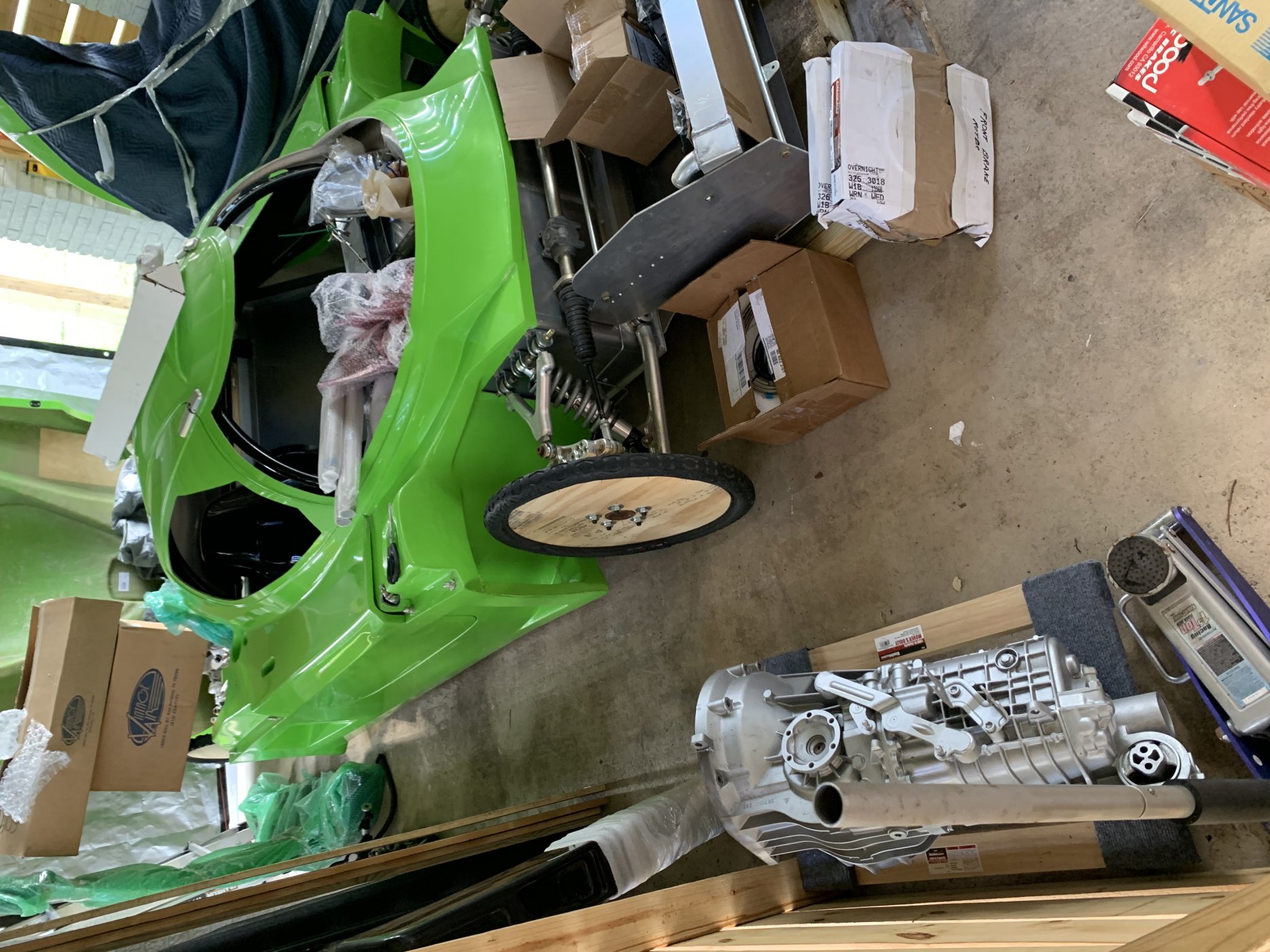

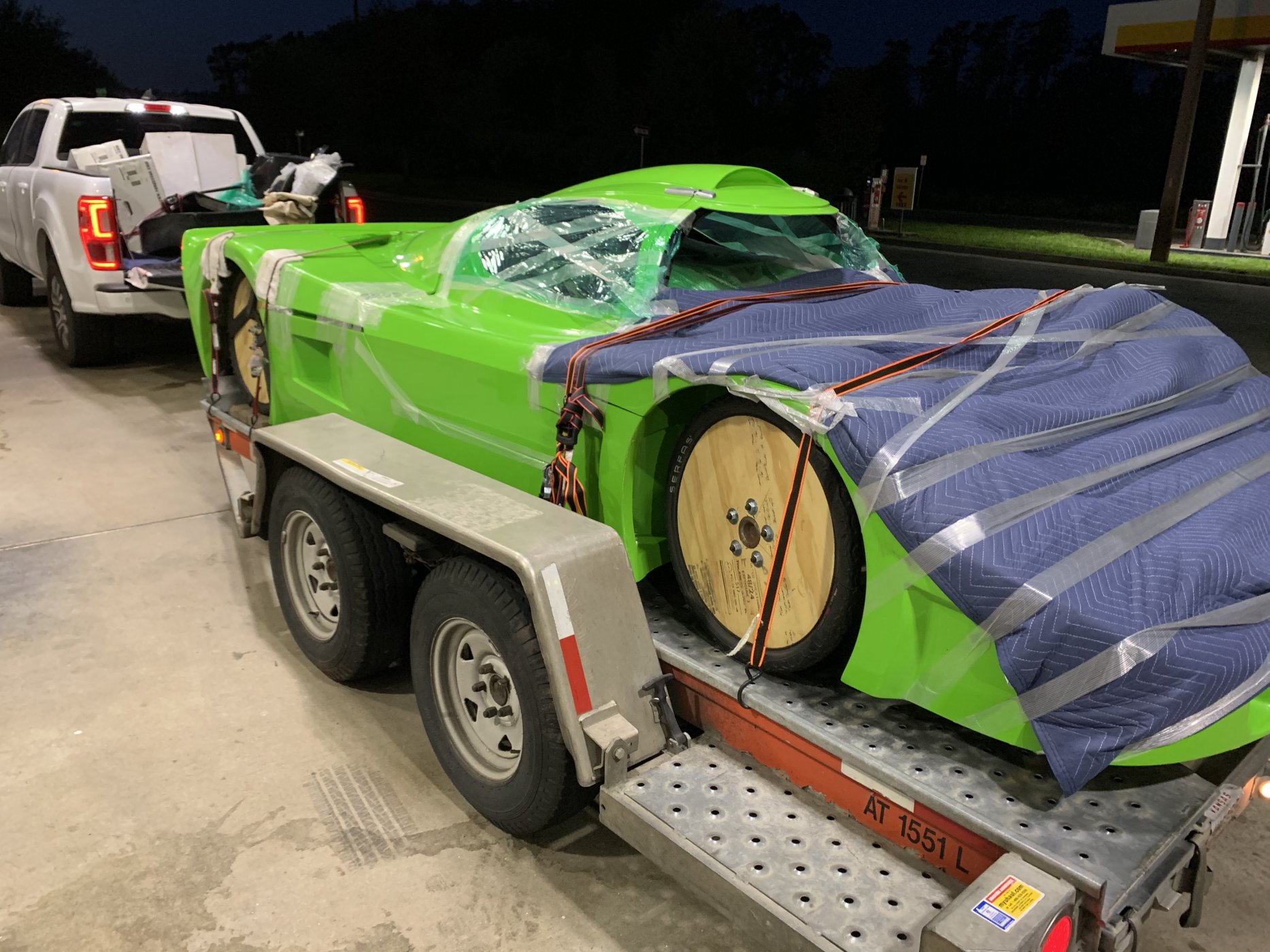

Well the car is home safely. Uneventful but long 19hr drive each way. First few things come to mind.... this thing is tiny and low to the ground. It’s really hard to grasp the scope until it is in front of you. It’s sat for 5 years so I have a little cleaning to do, some minor surface rust on the front wheel assemblies, some oxidation here and there.
I’m really not sure where to start, I’ll probably start in the front and make a fan shroud, do brake lines and cooling, etc. I elected to keep the LHD tub and make it work, after sitting in the car I doubt I will cut the spline. It is a ton of work and after seeing how much structure is involved it just isn’t worth it.
Again, I’m 5’11 195. You guys that are over 6’1 200+ must be jammed in there, I don’t know how you do it.

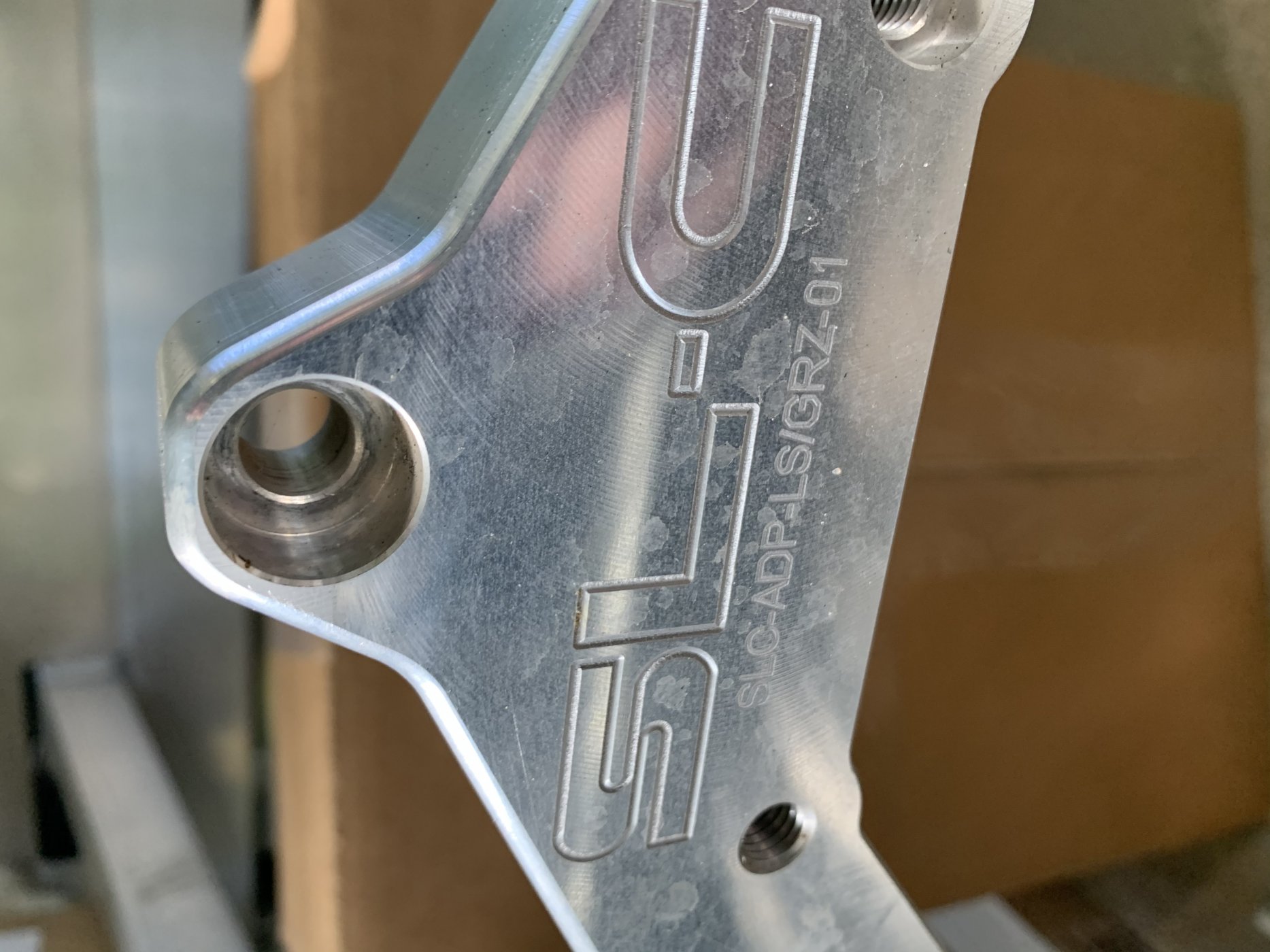

Engine mount for LS. Will maybe fabricate my own unless somehow has one.
Going so sell the Graz adapter and cables.

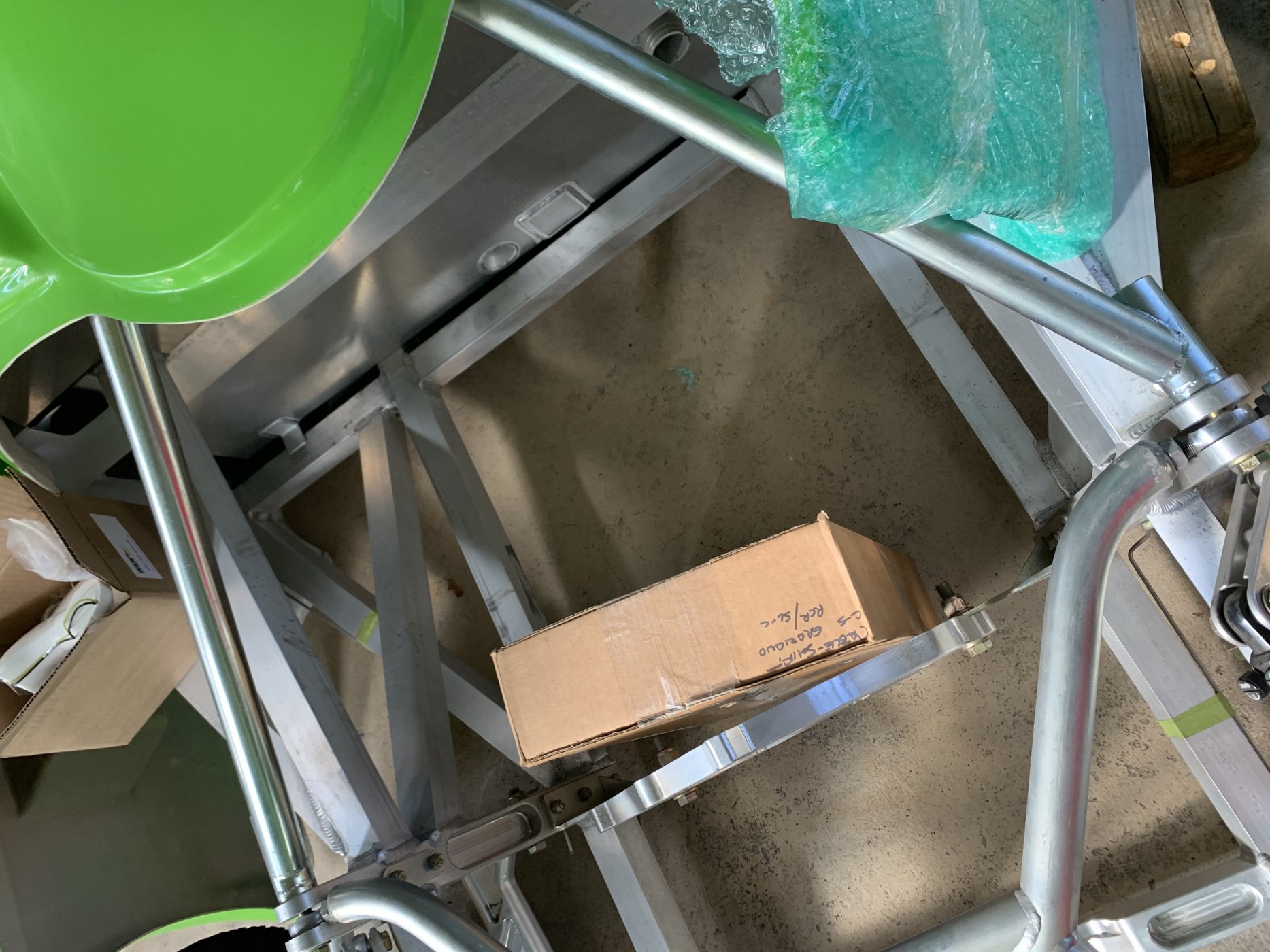

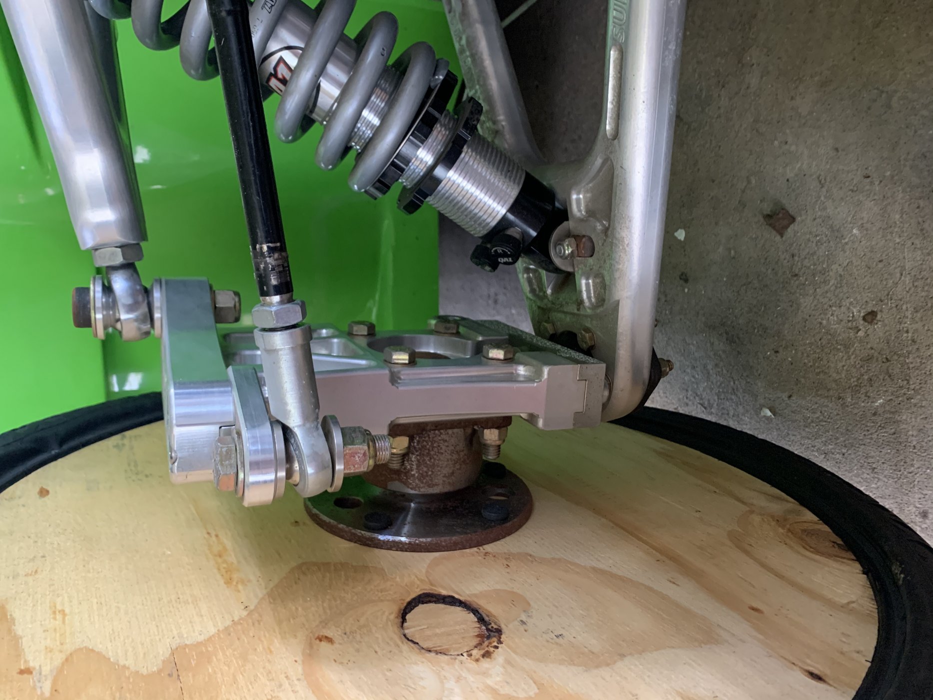

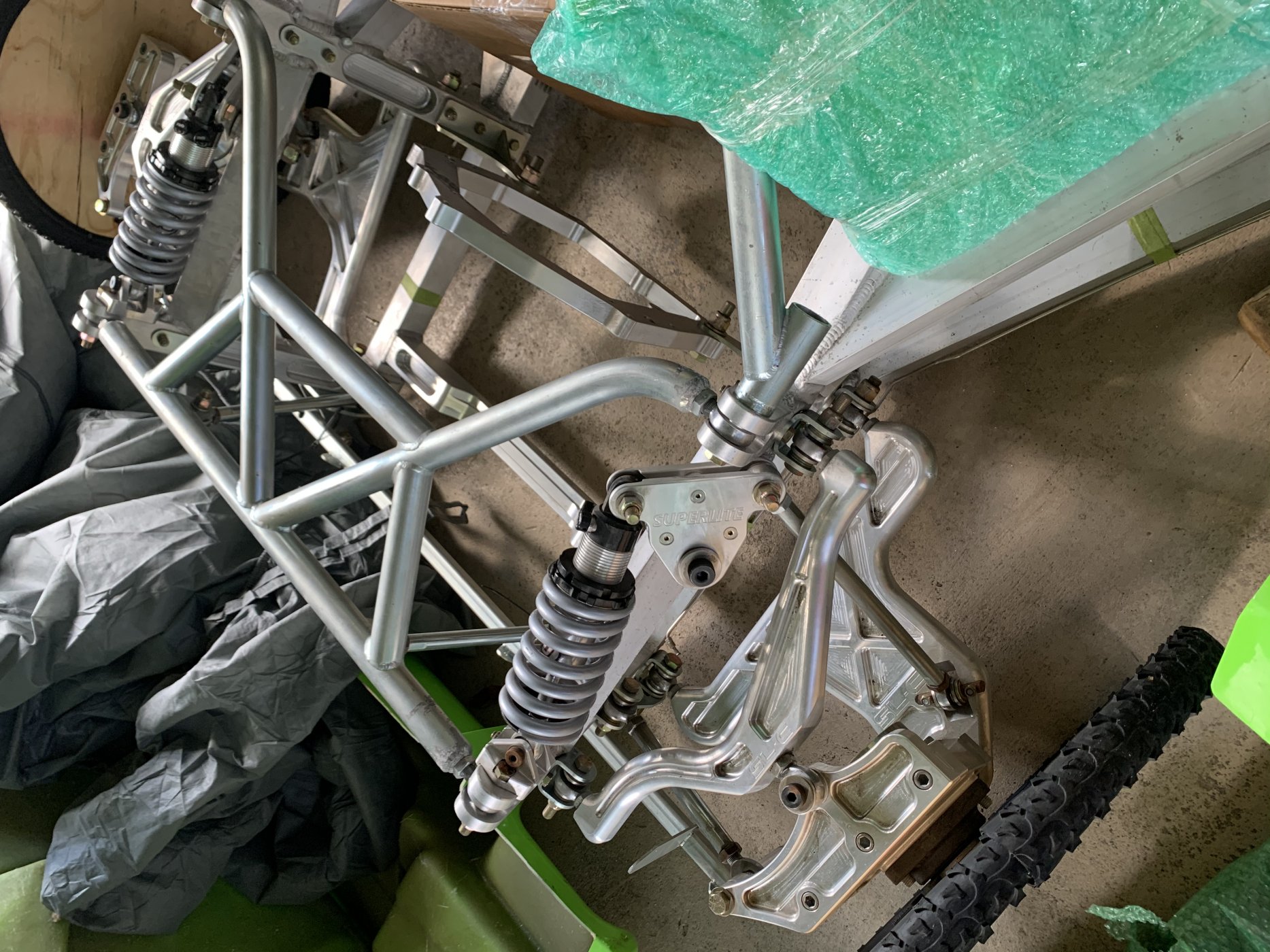

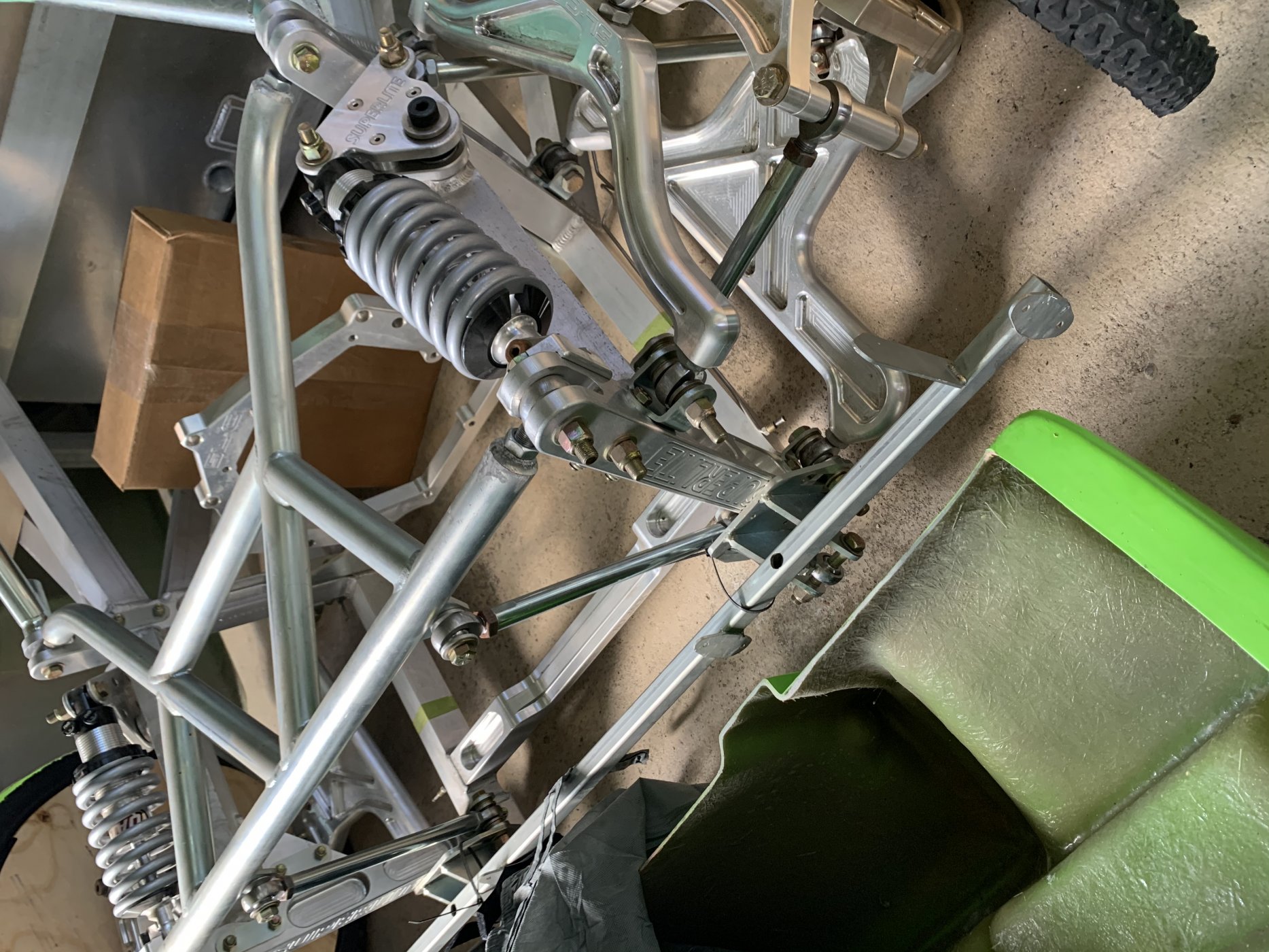

If anyone wants to take a look at the pics and see if anything is odd.

Congratulations on getting her home. Let the fun begin!!
Love the wheels! Traction may be an issue with those tires though, LOL.
I did not see anything in your pics that jumped out at me as an issue. Others may be able to critique further.
Your starting point for assembly sounds good. Be sure you get access to the manual online from RCR and read it at least twice. I would suggest you put together a build schedule of the order you plan to do things. Reading the manual will help with this. I would also suggest generating a bill of materials to track what you need to purchase for the car and what you have purchased.
