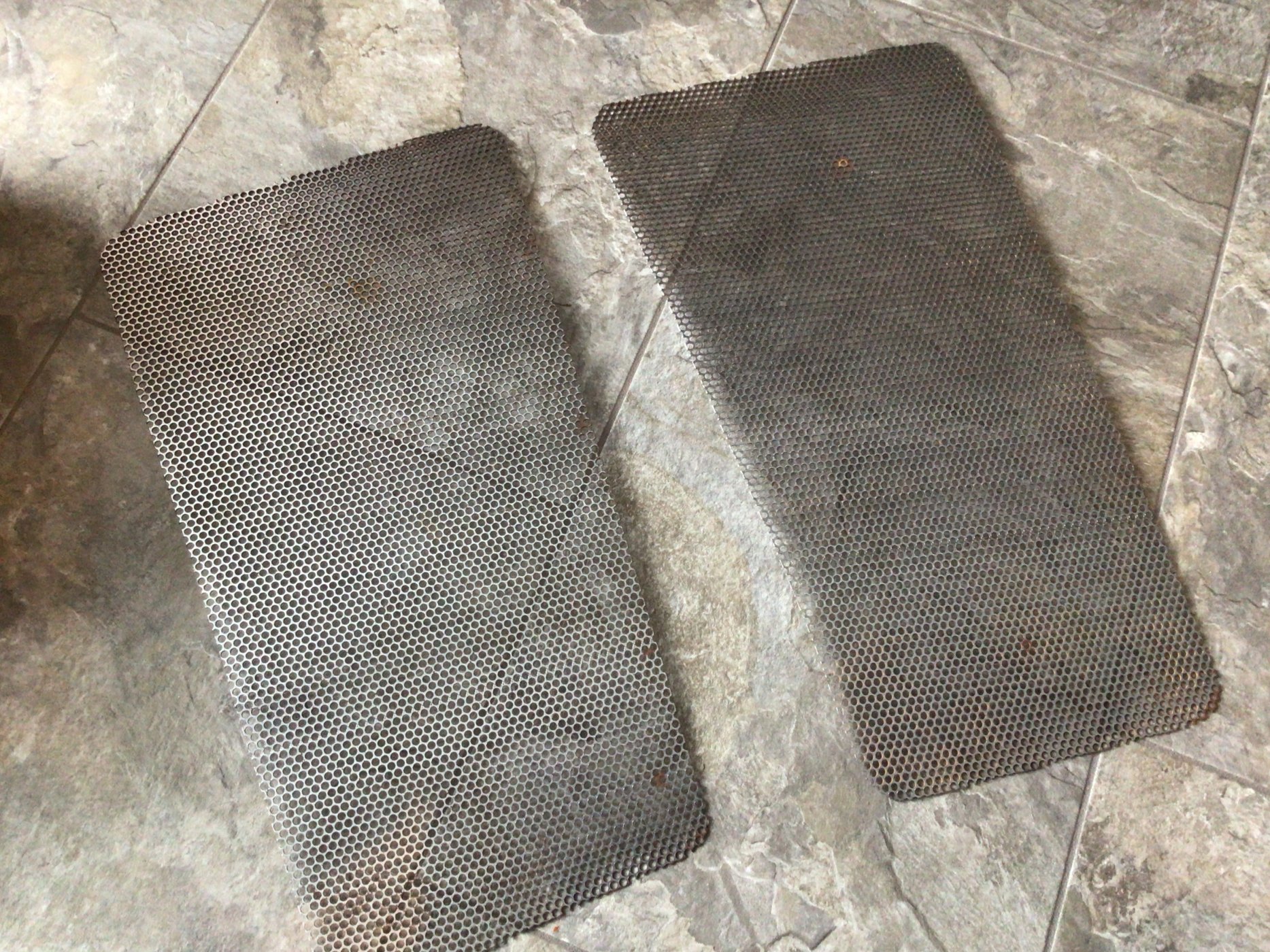

I cut out mesh guards for the the bottom side of the fender vents. My vents are bonded in place so I wanted protection from larger stone strikes. They will get bonded up in place after I powder coat them. I also plan to make solid copies that a magnetic. When I get the car certified I will magnetically stick them up in place if the inspector tells me the vents are illegal for road registration.

The thing to remember is that the purpose of the vents is to evacuate the buildup of pressure in the wheel well and therefore increase front downforce. Any restriction to flow through the vent will hinder their purpose for them. That mesh appears to reduce airflow by at least 50% if not more. So if the reason is a performance/aero one then the answer is clear. If the vents are installed for styling purposes then I think that a simple thin sheet of aluminum underneath and painted black on the top side would be an effective way to protect the vents.
I wouldn't put them on a car with an expensive paint job.

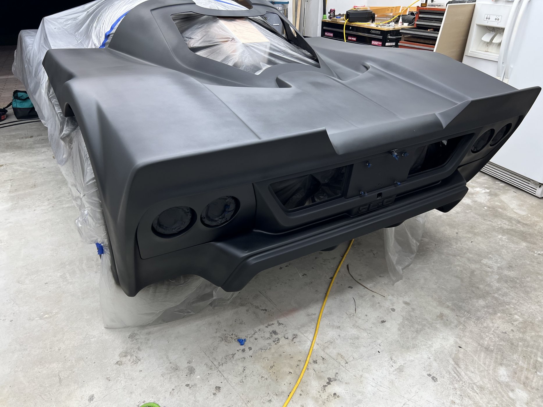

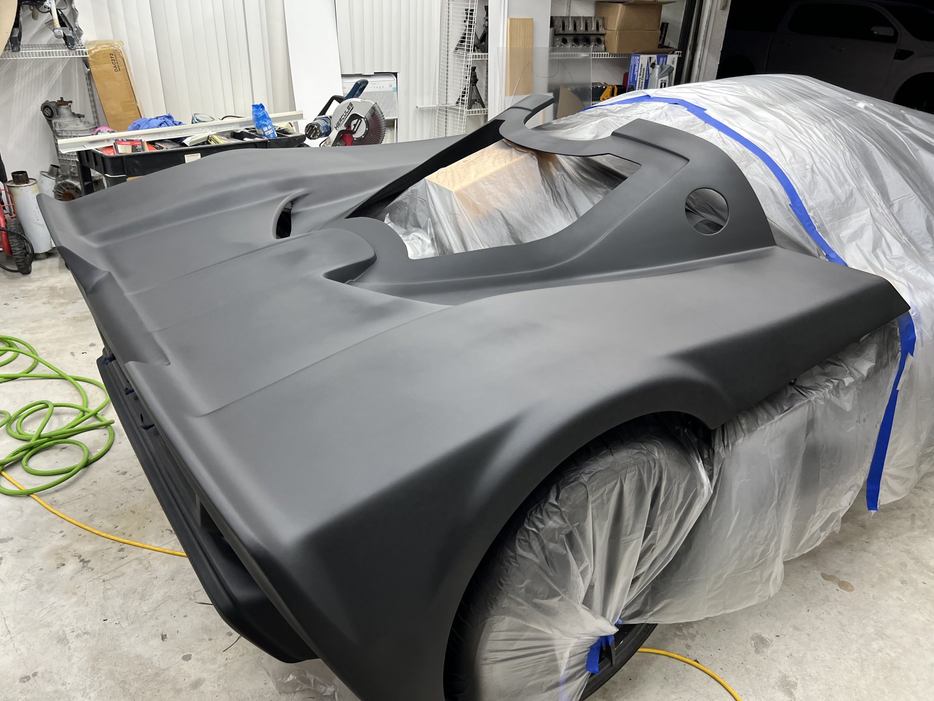

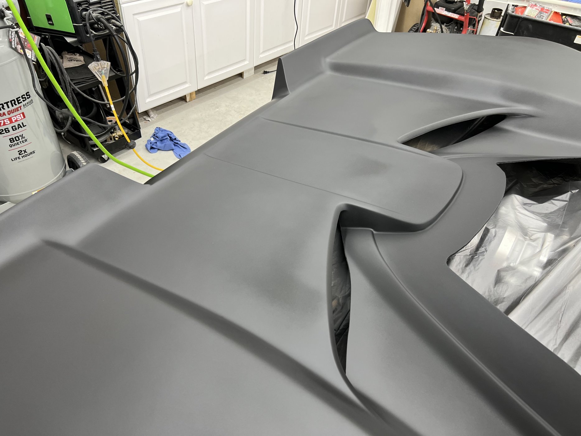

Been awhile. Still busy with a large house renovation. Finally getting to laying some paint on the car. I decided to just do the flat hot rod black. It’s the same color that’s inside the car. I am not a paint pro.
A few things I’ve learned. I had to let everything dry completely before sanding, sometimes 24hrs. I’ve just had bad experience sanding primer, putty or filler too quickly. Important to also scotchbrite with a fine pad the whole area to be paint before.
I started with the rear clam first. Allan had already primed for me. My first time came out decent but I think I’m going to respray the base again to get a smoother finish. You can see in the pictures the finish is a little sketchy. I think the paint was coming out too dry. A combination of the wrong settings and holding the gun too far away.
Next up is the front clam as soon as I mold in the fender vents. Then I’ll move to center and doors.
