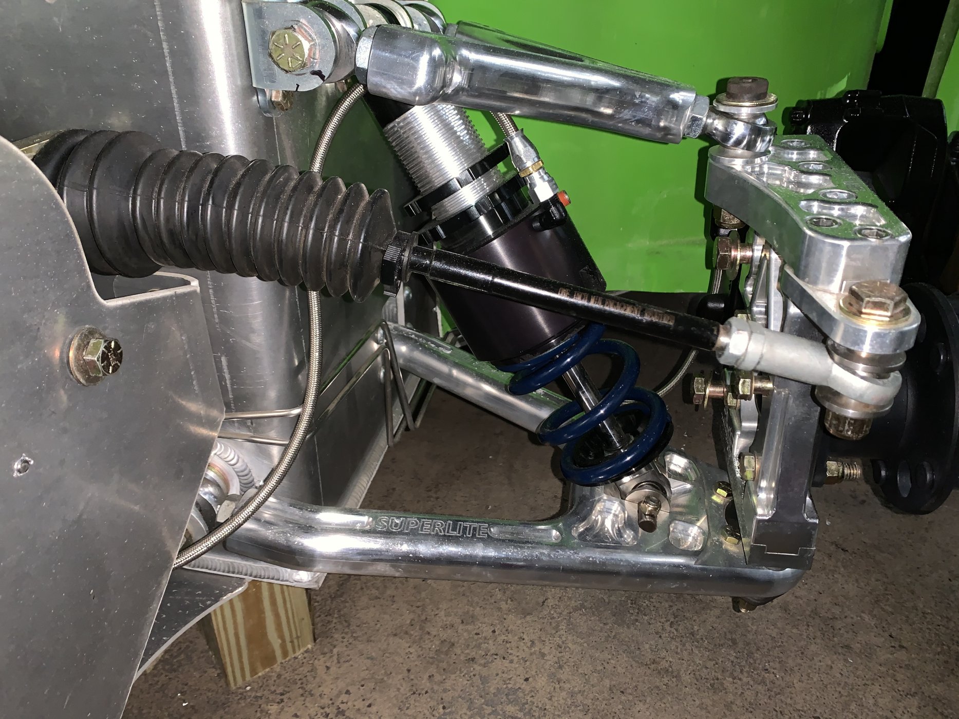

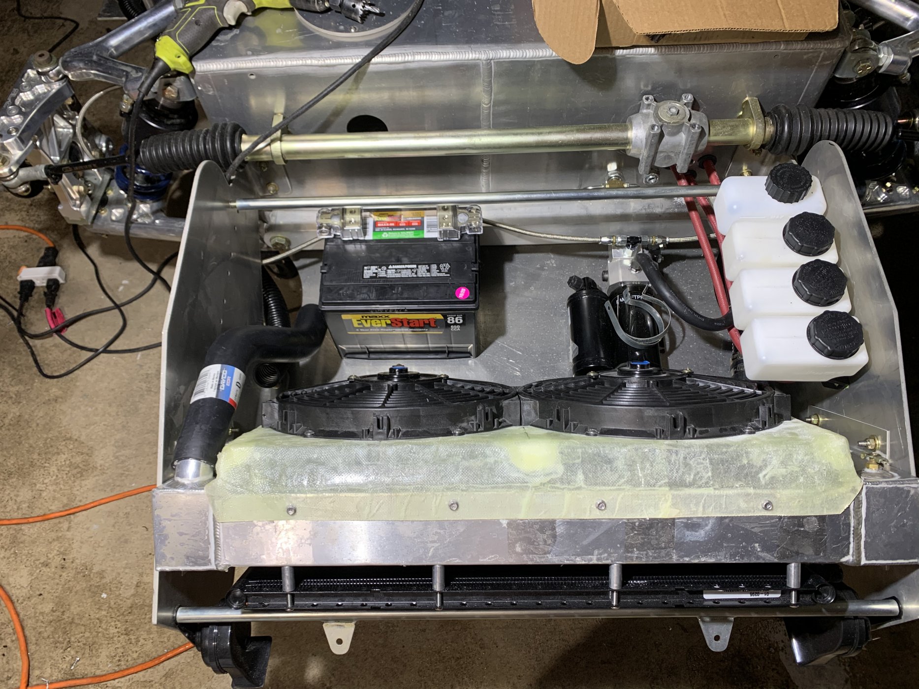

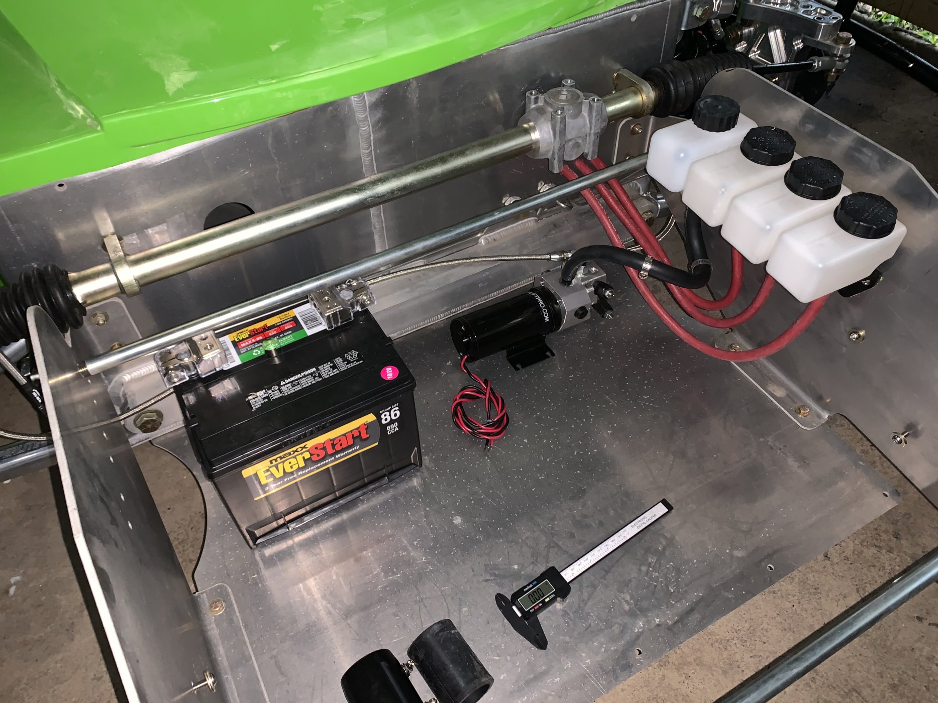

Some progress today....
1. Followed Allan's video and fit the tub and spider much better.

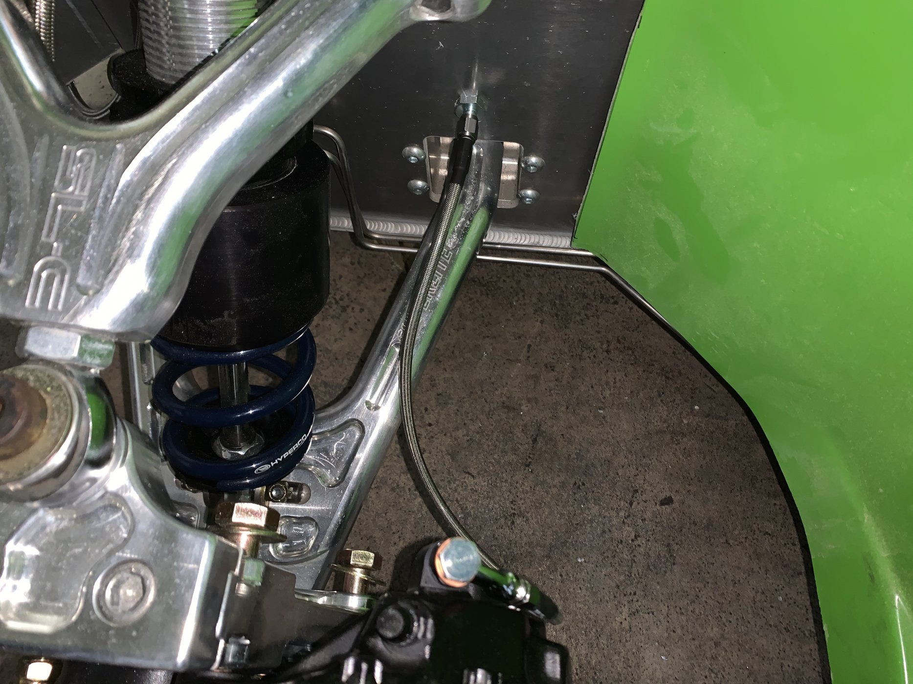

2. Just couldn’t get the supplied lines to work so I ran new NiCopp front brake lines. Still need to mount the one way valve for the rear brakes.
3. Mounted the horns, reservoir tanks, and laid out the battery position.
4. Mounted my front lifts, pump and lines.

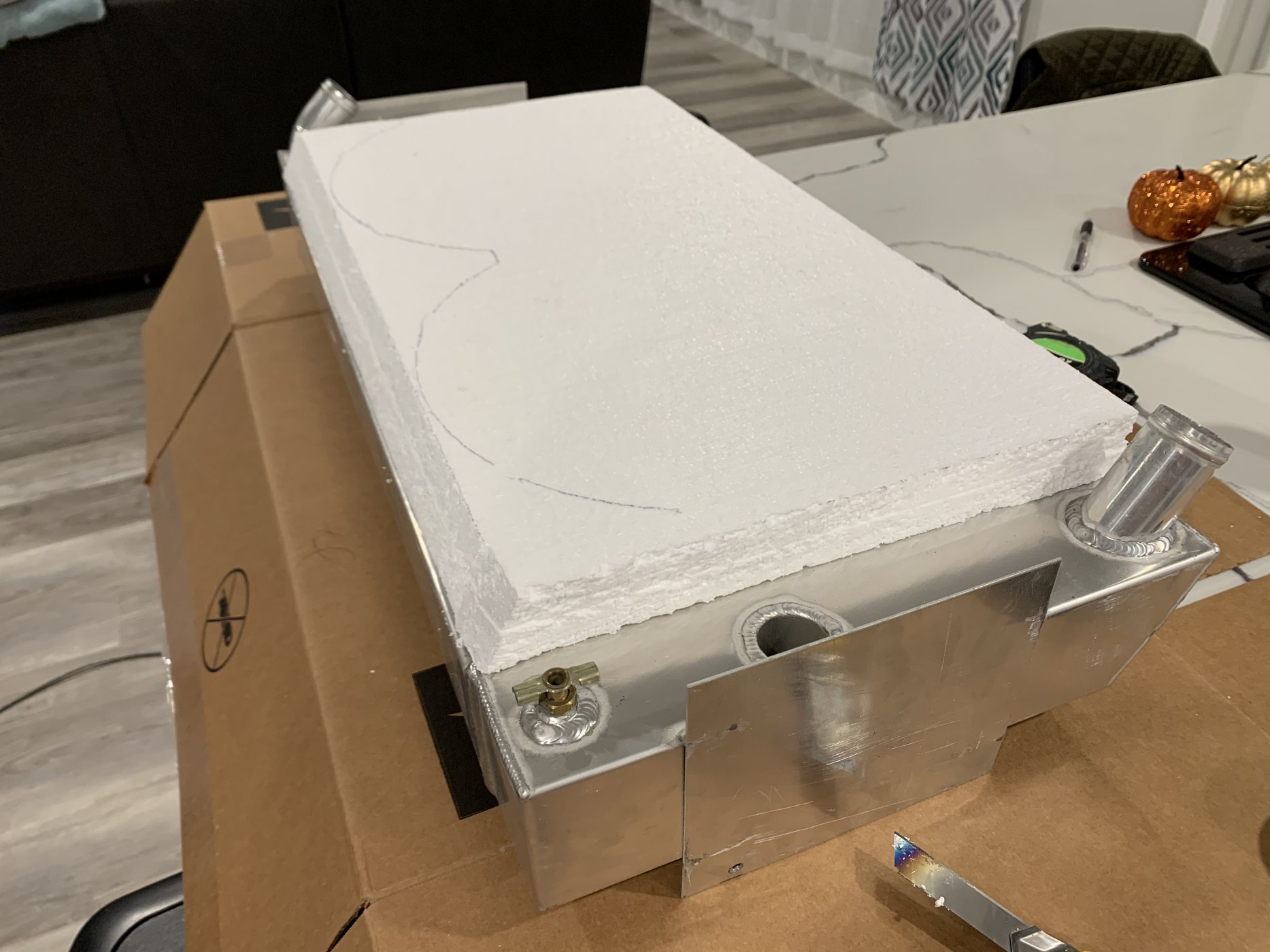

5. Wheels are being powder coated black, tank is being welded up.
Nothing is fastened yet, only mocked up, waiting on grommets, etc.
Big thanks to Scott, Rob, and Mahlon for the parts...steering rack, springs and dash.

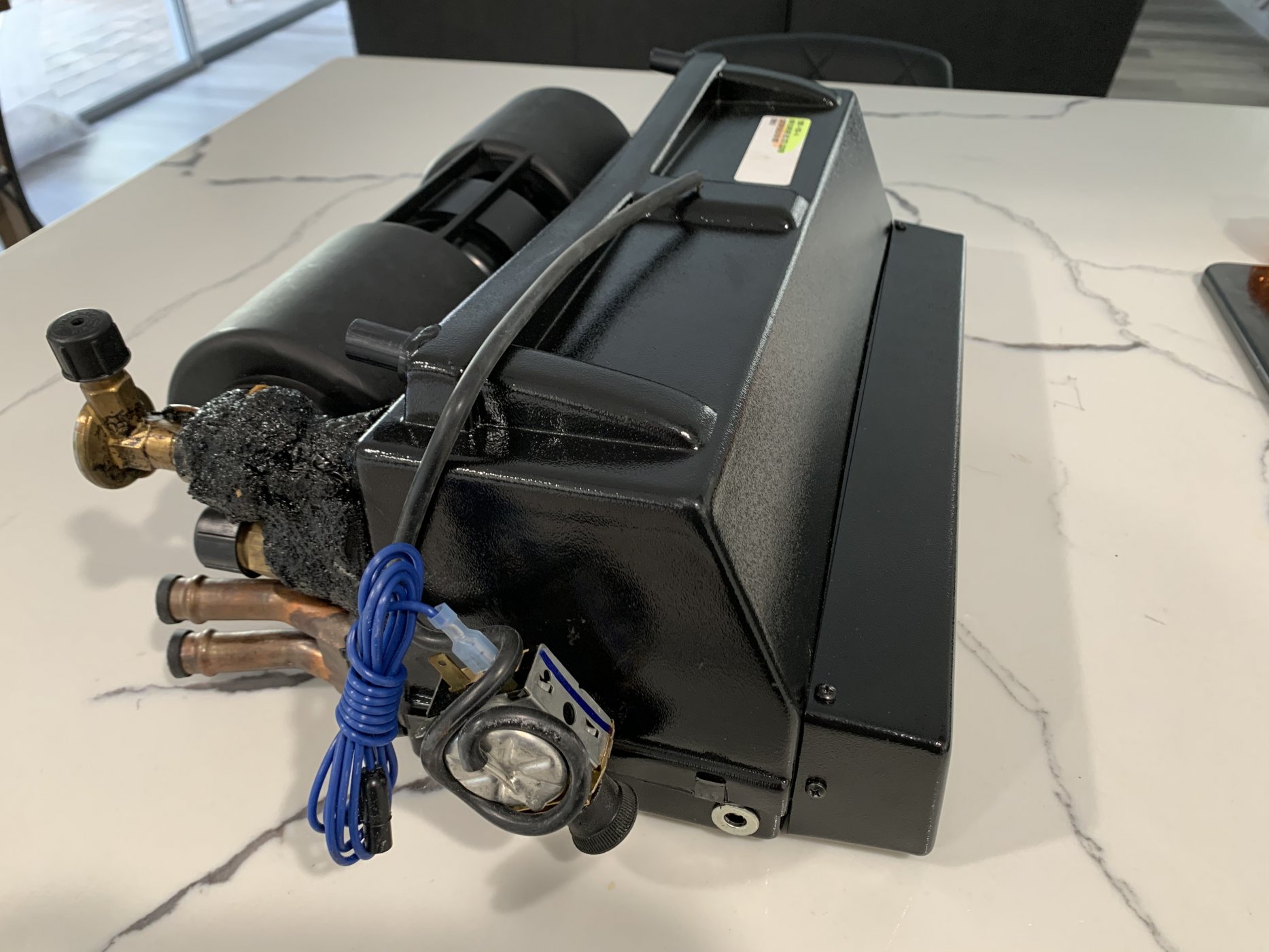

I want the evaporator to sit flat against the understand of the "dash", the aluminum frame of the car. However the capillary tube doesn't allow this. Has anyone taken the tube and cut a small slit down either side and fit the tub "inside" the plastic evap housing? This would allow it to be perfectly flat. I've attached cams pic that shows how it runs across. From what I know about it the cap tube, it just senses the temperature blowing across the exchanger coils and adjusts the refrigerant pressure based on that. As long as I maintain it in the same location I don't see why it would be an issue, it will allow me to greatly simply the evap mounting.
It’s a plastic housing, you can push it up against the underside of your dash area and secure it as it is, the housing will deform enough to accommodate. Try it on a flat sheet of aluminum and see if it’s flush enough for what you need. I wouldn’t recommend cutting the housing as you suggest. If anything I might see if I could relocate the tip to the opposite side (underside), but that leaves the tube exposed to possible kicking by a passenger’s legs. The tube is fairly sensitive and prone to failure if yanked.
Depending on how you plan to transition between the collector area and pass cold air through to your ductwork, you may want to add some thin sealing strips between the condenser body and foot box anyway, which would give you something of a small gap between the plastic and aluminum.

Took cams advice and ended up moving the cap tube to the bottom. Drilled a small hole and it slid right through, also moved the screws to the side so the top is completely flat. I’ll add some foam tape to get a nice seal and provide some cushion. Ill add some tape to secure it and prevent someone from kicking it. I’ll also add some sealant so the condensate doesn’t drip

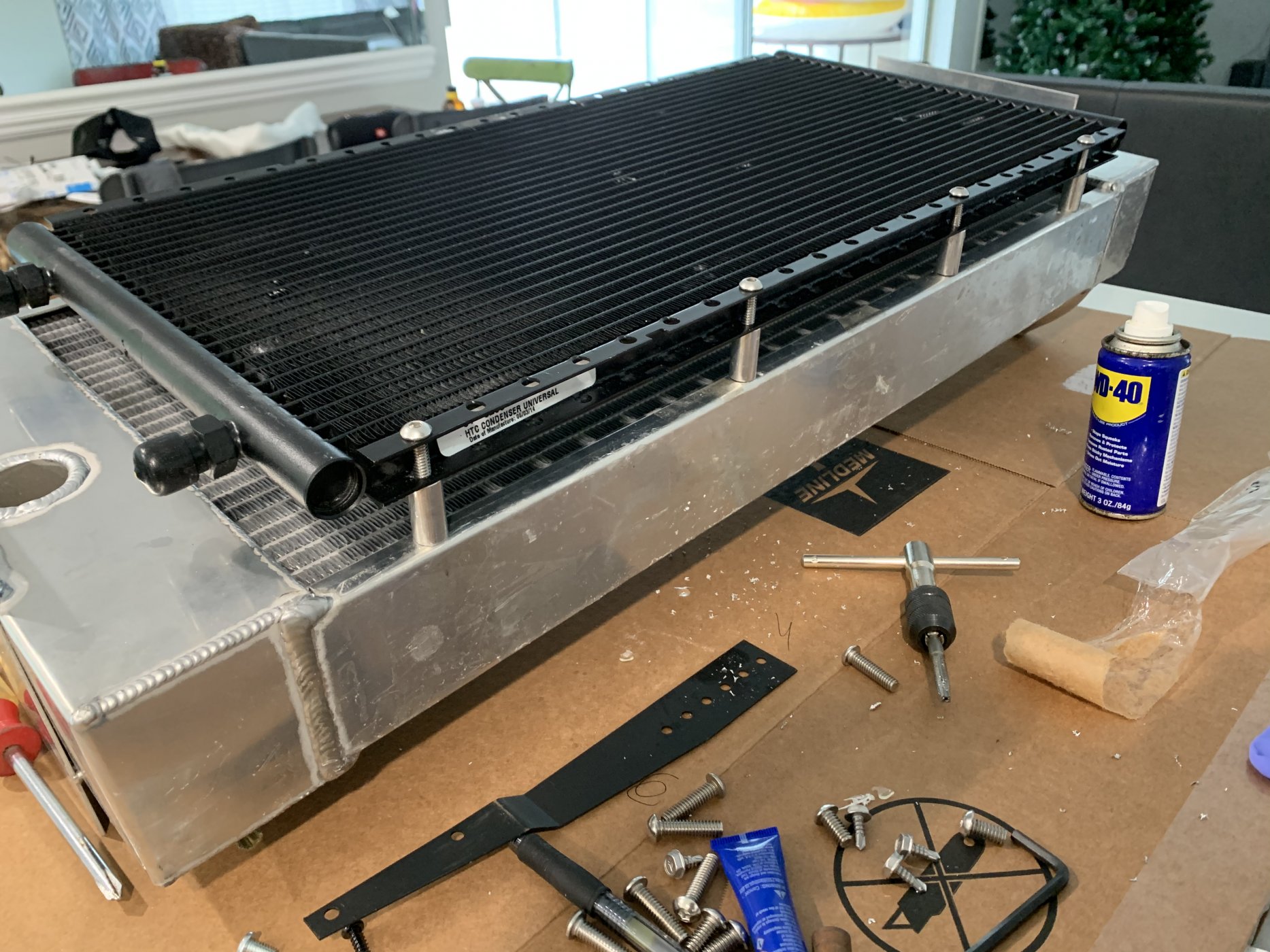

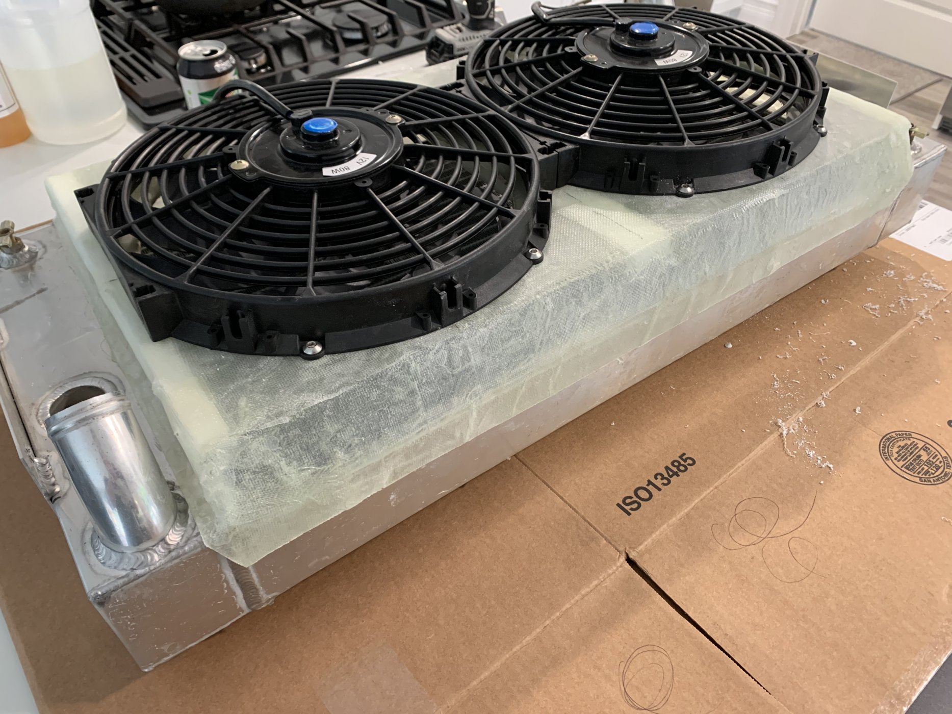

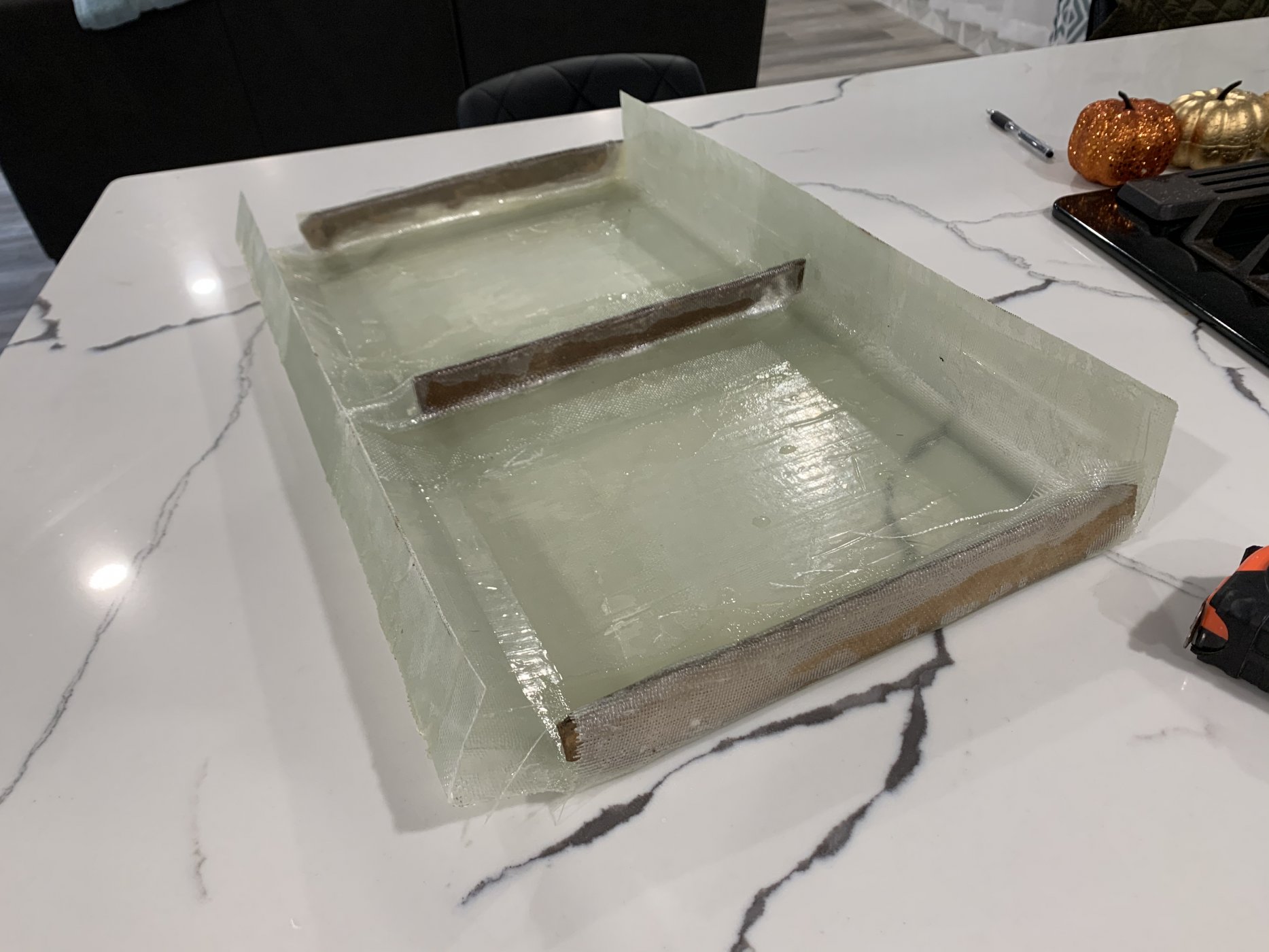

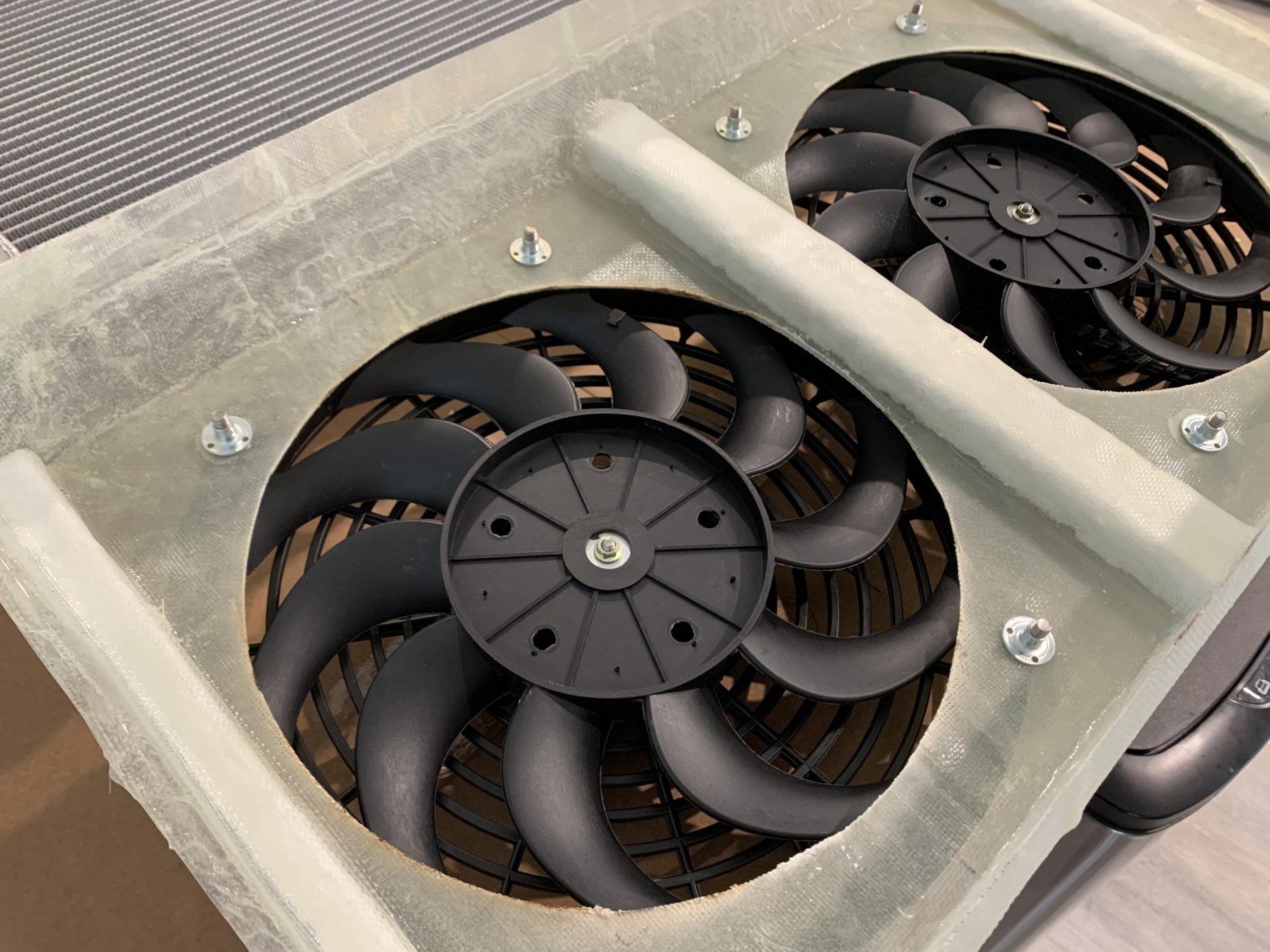

I made a radiator shroud this weekend, however, I was so excited about making it that I rushed the process. It came out strong but ugly and not perfect. I ended up getting some of the nasty white foam (wish I had the pink or blue) and made a sort of mold. The glass completely encompasses the radiator and will fit much more nicely. I’ll either do a few short self tap screws or some double sided tape to secure it to the top and bottom of the radiator when done. Still have a few more layers and structure to add.
Old one....
Version 2

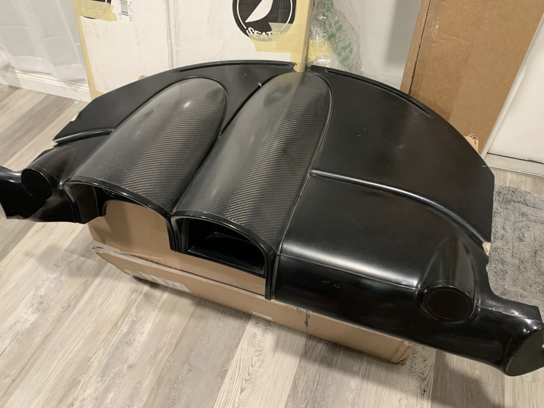

Take some time and consider using a piece of aluminum with vent holes in it to cool the engine room. Some 1/16" thick sheet or even thinner would replace the window. It would be stronger and not prone to cracking like Lexan. You could even paint it to match the body or simply mate black. There's nothing to see back there from the cockpit anyway and I believe you need the cooling.

Howard, I really want to do the side vents from RCR in the future. I tend to be a person that gets bored quickly so I’m definitely leaving options on the table for future upgrades.

The rear glass vents let out a tremendous amount of heat. After a hard drive, idling the engine, I can’t keep my hand above the louvre openings for very long due to the amount of heat coming through. In motion the engine gets a good amount of airflow (if you don’t close the bottom out).

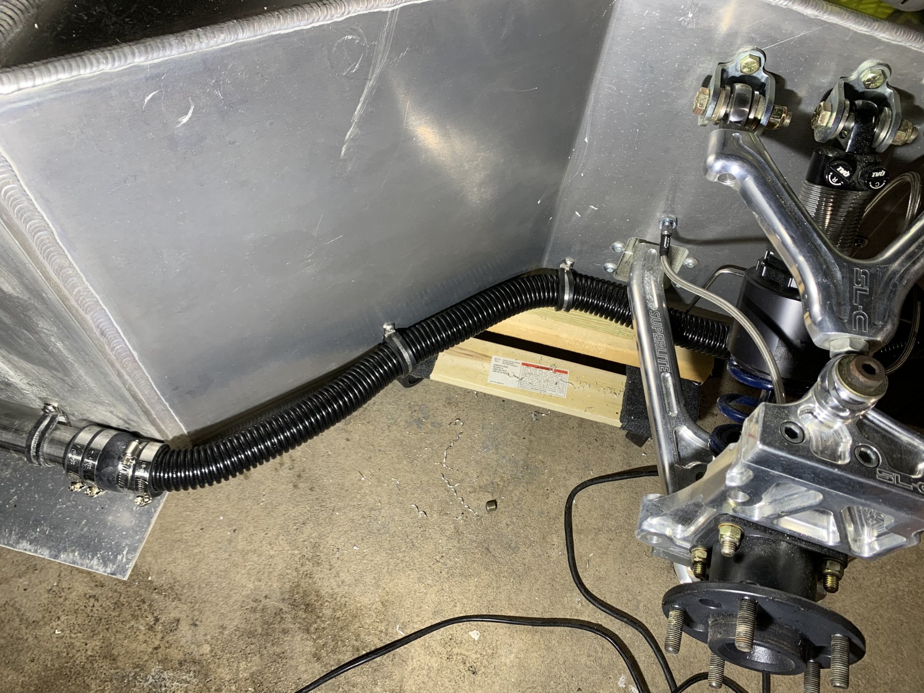

Made some more progress today. Finally mounted my side cooling pipes, just need to wrap them and button up the connections at the front. Finally finished the shroud and mounted the condenser and fans. Mounted my steering column. Mounted my tank. Tomorrow I’ll be buttoning up the loose ends and probably dropping in the motor.

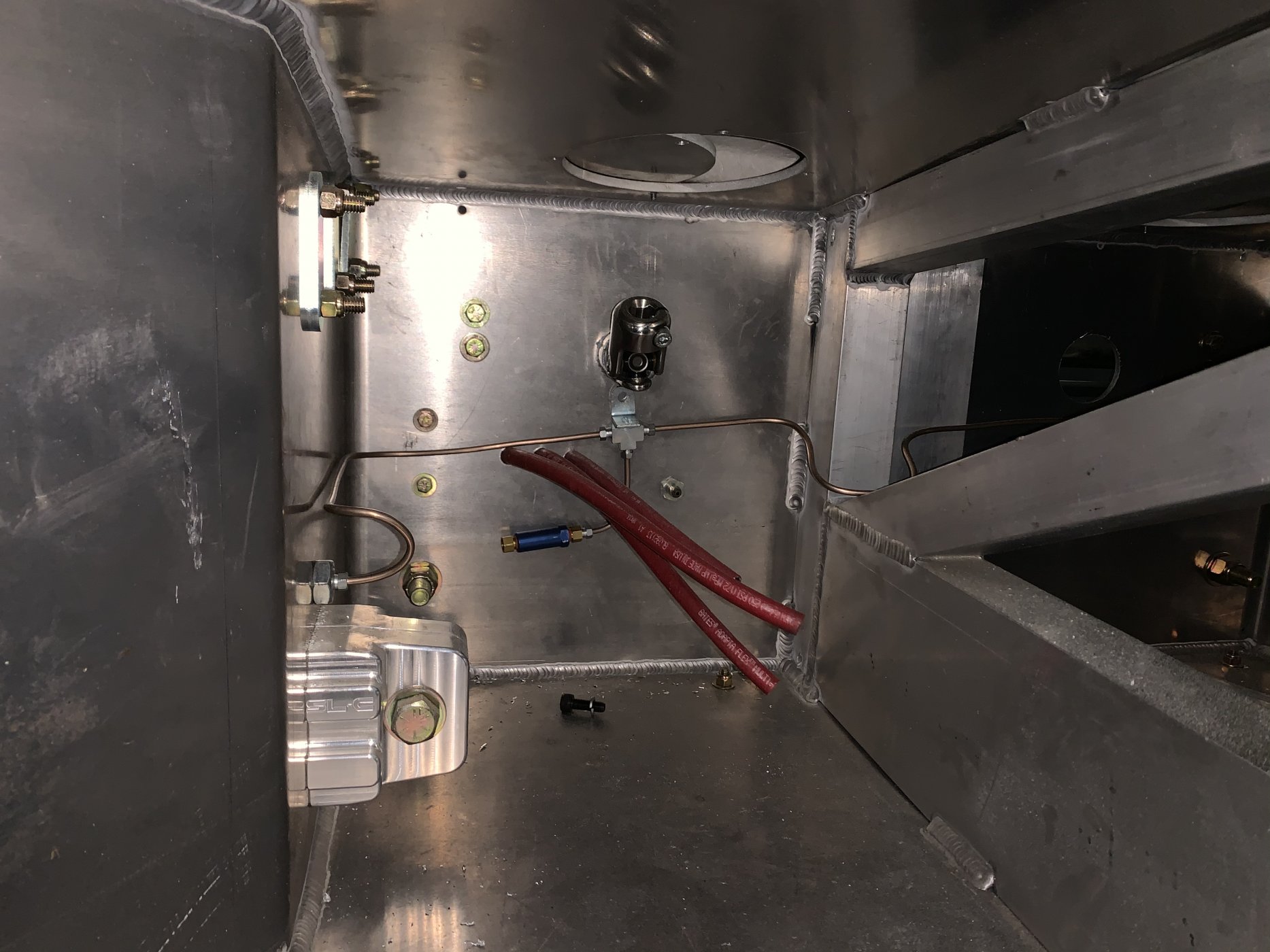

Few questions, what’s the deal with the steering column joints? I can’t get the screws to tighten enough to create a good clamp.
Also, those that mount the pedal directly to the floor. What bolt nut configuration have you used? I want a flat bottom on the chassis, but the Tilton assembly isn’t very generous for a bolt up from bottom and nut to pedal scenario.

You can mount your pedal assembly directly to the floor with flat head cap screws and countersunk holes from below and Allen nuts on the top side. All available from McMaster Carr.

You may have this part and not installed it yet. There should be an L Bracket connecting the steering box to the tub. It normally is mounted to the underside of steering box.
Neil
Another approach would be to install your pedal assembly with Hi-Locks. These have a very low profile head and tighten a threaded collar (nut) while preventing the shaft from rotating with a hex wrench- all from the inside. For your application you don't need a close-fitting reamed hole.
Fantastic, I've never seen these before but they will work great.
I actually don't have that piece, I guess I'll have to make one from some aluminum L.
They are usually found on eBay:
These look interesting, if the allen nuts don't work out ill go this route. Thanks.
